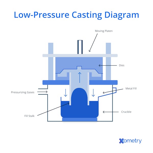

Low pressure Casting Diagram

Low-pressure casting works by methodically introducing molten metal into a mold under controlled, low-pressure conditions.
The process begins with machining a mold from materials like steel or sand to replicate the intended part's shape and attributes. Permanent molds are more frequently employed than sand molds due to their greater productivity potential. This mold is carefully sealed to prevent any undesired air ingress. Before molten metal enters the mold, specific pre-casting processes may be performed. The mold might be preheated to prevent thermal shock, and fluxes could be employed to clean its surface and to avoid oxidation. Degassing procedures may also be carried out before casting to eliminate trapped gases.
Once these preliminary steps are complete, the metal is elevated to a temperature surpassing its melting point within a furnace. Subsequently, the molten metal is conveyed to a holding furnace (crucible) responsible for sustaining the temperature and eliminating any impurities present in the metal. The stove is then pressurized. The molten metal enters the mold cavity steadily. This controlled process is characterized by a lack of turbulence due to the low applied pressure. Before solidification begins, air within the mold can escape through strategically placed vents.
During the cooling phase, the molten metal gradually solidifies, conforming precisely to the shape of the mold cavity. Throughout this process, the applied pressure is maintained to fill any potential shrinkage pockets and guarantee that the solidifying metal fully replicates all intricate details of the mold. Once the metal has sufficiently cooled and solidified, the mold is opened, and the resulting casting is carefully removed. Depending on the complexity of the part, further processes such as trimming, machining, and finishing may be conducted to achieve the desired final product.

2. Transfer Molten Metal to a Pressurized Holding Furnace Beneath the Mold
Once molten, the metal is transferred into a holding furnace located beneath the mold. This furnace maintains the alloy at the target temperature and positions it for upward delivery into the mold cavity. This setup minimizes oxidation and enables direct pressurization of the metal for casting.
3. Apply Low Pressure to Feed Molten Metal into the Mold via Riser Tube
Low pressure, typically between 0.3 and 0.7 bar, is applied to the holding furnace to push the molten metal upward through a refractory riser tube into the mold. The flow is gradual and laminar, which minimizes turbulence and air entrapment, allowing the metal to fill the mold evenly from the bottom up. This step is critical for achieving defect-free castings, especially in parts with complex geometries or thin walls. The pressure is maintained throughout mold filling and the early stages of solidification to compensate for any volume shrinkage.
4. Maintain Pressure During Solidification in the Die Cavity
As the metal cools and begins to solidify, the applied pressure continues to ensure that the mold remains filled despite shrinkage. This results in improved density, uniform microstructure, and reduced porosity in the final part. Controlled solidification also enhances mechanical properties and dimensional accuracy.
5. Release Pressure and Recycle Excess Molten Metal
After solidification is complete, the pressure is released. Any remaining molten metal in the holding furnace or riser system is retained for reuse in the next casting cycle. This closed-loop system minimizes material waste and improves process efficiency.
