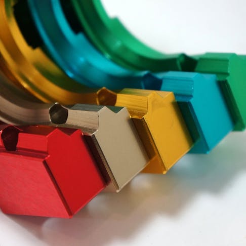

What are the Available Colors for Anodized Aluminum?
The world is your oyster when it comes to choosing a color for your anodized aluminum. Your pieces can be made in basic colors like black, blue, red, yellow, and white, and even more vibrant options like purple, orange, pink, and gold. Just make sure you clearly state the exact color you want when making an order.
It's important to communicate any color match expectations during the quoting phase because anodizing is a pigmenting process so there is variability from batch to batch.

What Is the Process of Coloring Anodized Aluminum?
There are several methods that we use to give anodized aluminum the colors that our customers ask for. The final color will also be dependent on things like film thickness, dye concentration, metal type, and temperature. Here’s a brief overview of these coloring processes:
Dye/Coloring
This entails soaking the anodized aluminum in a dye solution. The color gets deep into the tiny pores of the oxide layer. The longer you leave it in the solution, the deeper the color.
Electrolytic Coloring
In this method, the metal is put into a bath with inorganic metal salts (without carbon-hydrogen bonds), and an electric current is passed through it. This deposits the salts into the oxide layer’s pores and creates different colors.
Integral Coloring
This is a two-in-one method that combines the anodizing and coloring processes to make a super strong and durable oxide layer in bronze and black tones. It’s performed during anodizing – not after, like the other methods.
Interference Coloring
By changing the pore structure in the protective layer with sulfuric acid, the illusion of color can be achieved via what are called “optical interference effects.”
Dip Coloring
Similar to the dye process, this involves dipping the metal into a dye tank to fill its pores, then boiling it in deionized water to stop the reaction. This can make loads of different colors, but it might not be as UV-resistant as the other types.
Sealing
The sealing process is the last step and involves boiling the anodized (and colored) aluminum in hot water, trapping the dye’s molecules in the pores. This is also referred to as “hydration,” and it is an important step because it prevents the dye from escaping and won’t allow the material to react further with any external factors.

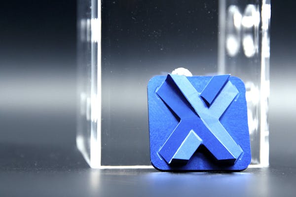

blue anodized part
An aluminum Xometry tile with a type II blue anodized finish.
