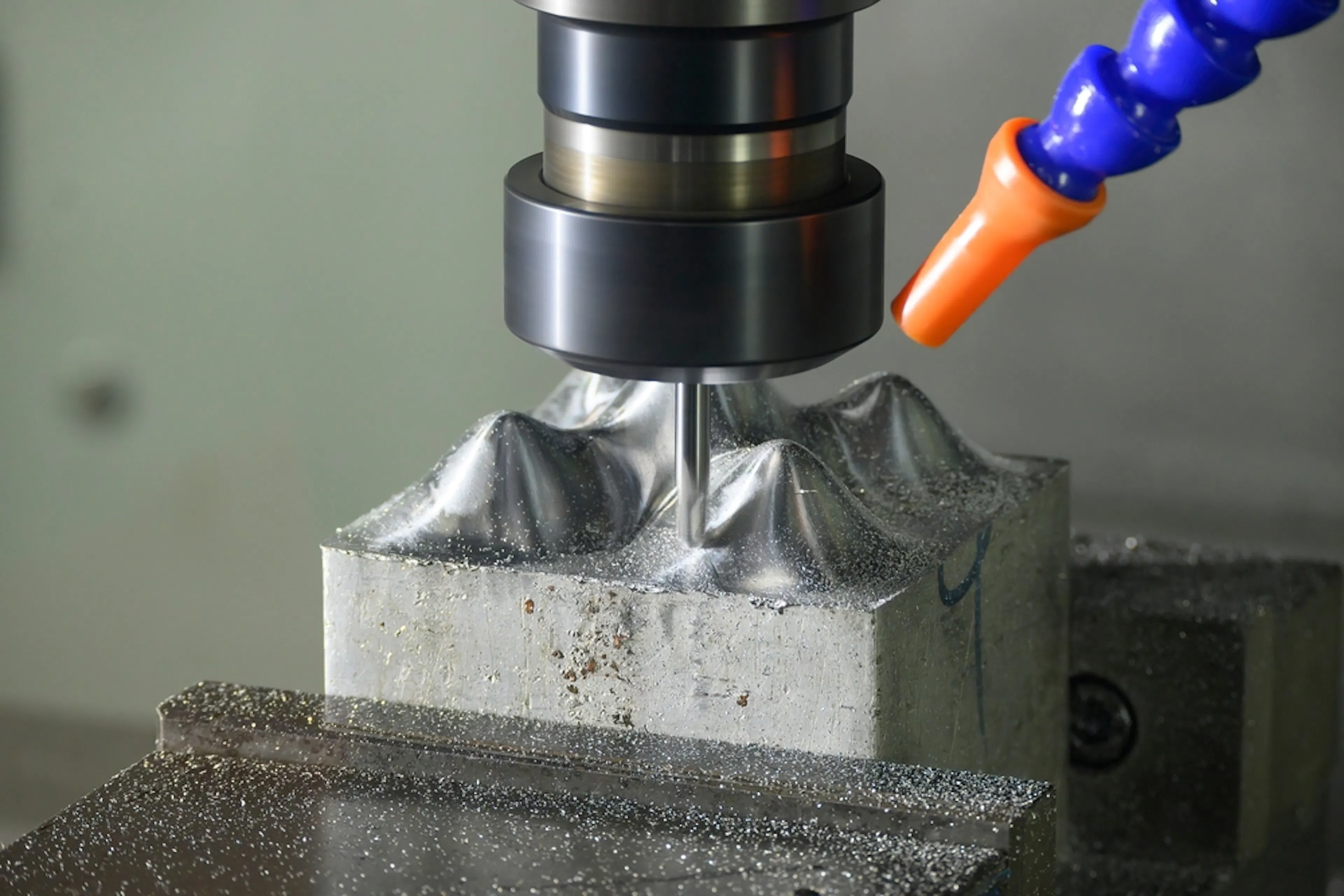

End milling is a machining process used to cut or shape materials using a rotating milling cutter called an end mill. It's employed in most manufacturing sectors for profile cutting, slot drilling, and contouring. The end mill’s cylindrical milling cutter has cutting edges on both the bottom and the side to remove material from a workpiece. It rotates the part and moves it along different axes.
End mills have various end and flute configurations, optimized for a variety of purposes and hole/slot periphery forms. The end mill can follow any number of path profiles to perform profiling, slot drilling, and boring tasks.

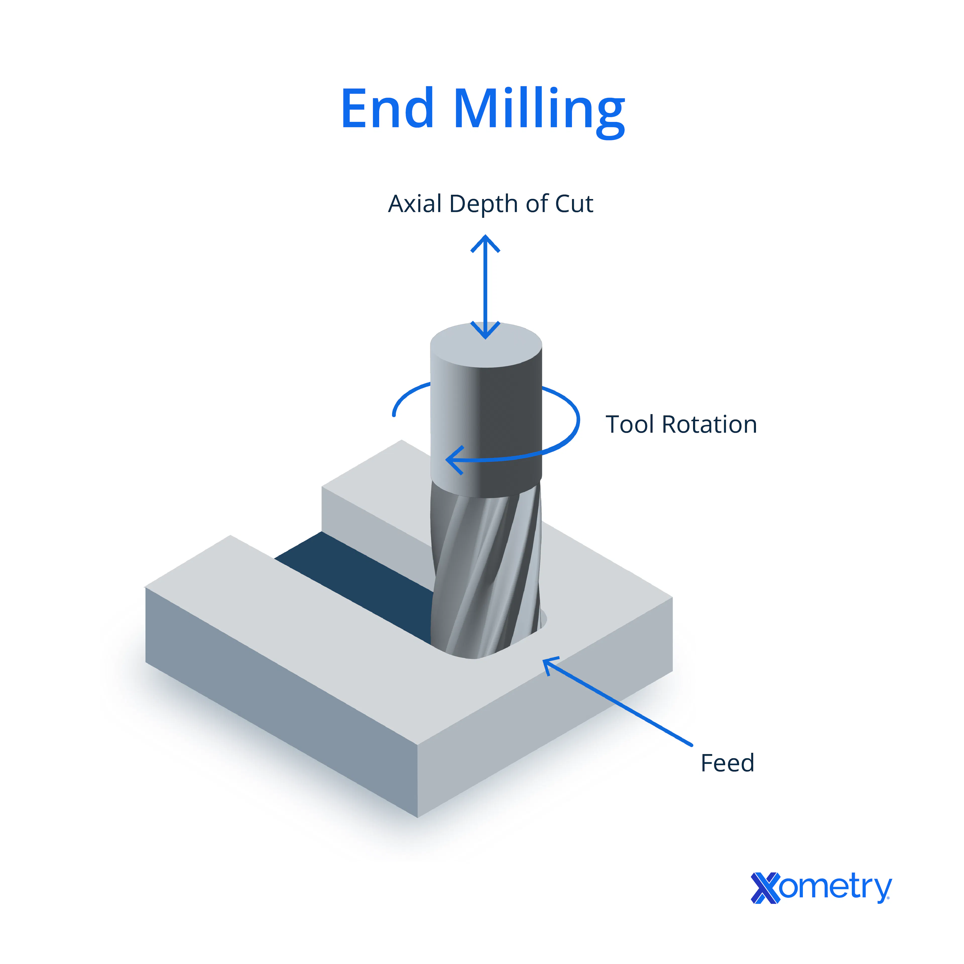

What Is End Milling?
End milling is a machining process used in metalworking, woodworking, and other material shaping/removal processes. It is used to cut or shape materials using a rotating end mill. The process is used for a wide range of tasks, including: slotting, contouring, facing, and profiling workpieces. End milling can be used to create a huge range of features on a workpiece such as slots, pockets, holes, complex contours, and mixed forms. It is a fundamental process in manufacturing and is employed across all manufacturing sectors to precisely cut and shape: metals, plastics, wood, stone, and composites. The choice of end mill type, size, and cutting parameters depends on the specific machining requirements and the material being worked on.
Diagram of the end milling process.

How Does the End Milling Process Work?
End milling is used to remove material from the surface of a workpiece. It begins with the workpiece securely clamped onto the machine's work table or fixture. The spinning end mill is brought into contact with the workpiece's surface, and the cutting edges engage the material. The machine's spindle rotates at high speed to minimize vibration and cut cleanly. The work table itself moves the workpiece around the fixed cutting spindle. As the end mill rotates and the workpiece advances, the cutting edges of the end mill remove material from the workpiece's surface. Chips that get cut away are continuously removed from the cutting zone by the machine's chip evacuation system or by the motion of the end mill itself. The machinist or CNC (computer numerical control) program controls the speed, feed rate, depth of cut, and toolpath.

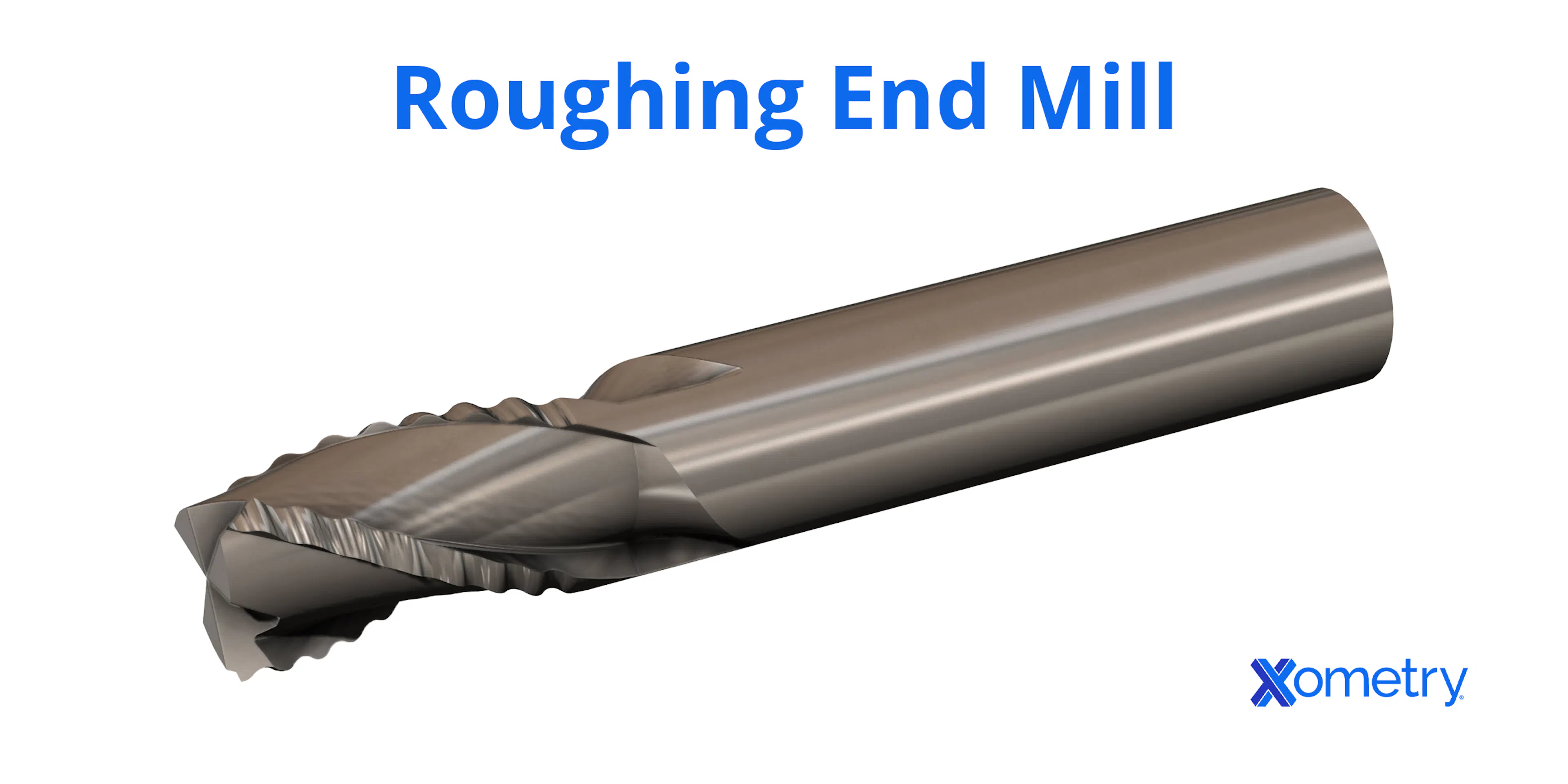

1. Roughing End Mills
A roughing end mill can efficiently remove significant amounts of material from a workpiece, especially during the initial stages of machining. It is designed with a coarse and rugged geometry that allows for aggressive material removal while withstanding high cutting forces. Key features of a roughing end mill include multiple flutes, coarse tooth design, high helix angles, corner radii, and Weldon shanks.
A roughing end mill.
Roughing end mills are employed in first-stage roughing operations to quickly remove material before finishing cuts are made with finer tools. This tool class enables high material removal rates.

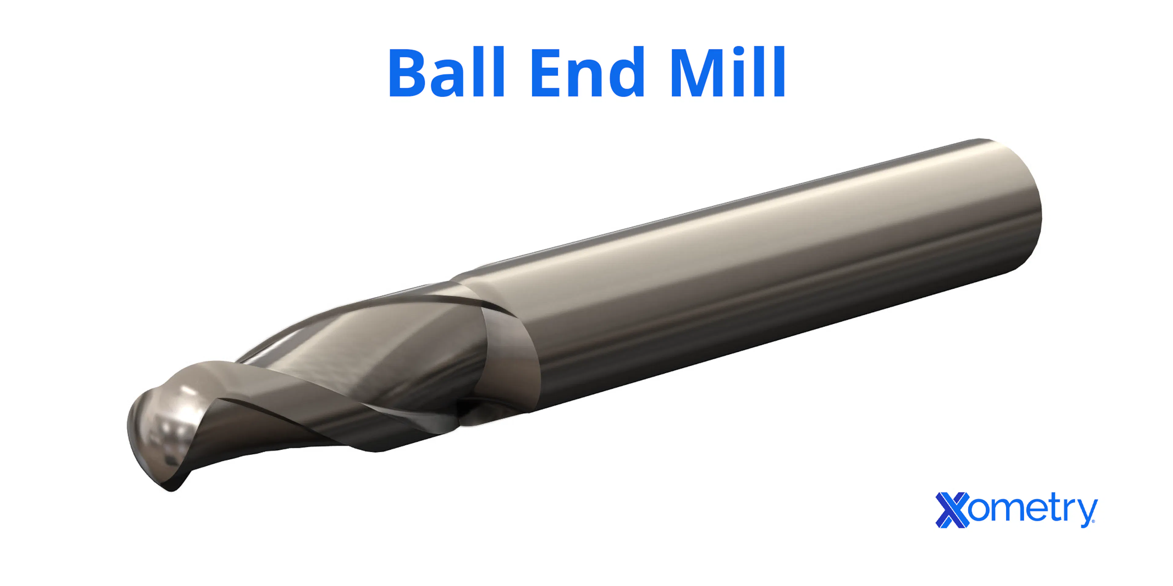

2. Ball End Mills
A ball end mill is a cutting tool with a hemispherical tip. It is designed to provide precision contouring, slotting, and machining of complex 3D shapes. The spherical tip allows for smooth and accurate machining of concave surfaces, filets, and curved profiles, smoothing the cuts into each other with minimal aliasing. Ball end mills can be used for both roughing and finishing operations — as well as in 3D contouring applications — simply by varying cut depth and feed rate. They generate lower cutting forces than do flat end mills, as the cut transitions into the material progressively along the bit’s radius. Ball end mills come in single-flute, two-flute, and multi-flute designs to suit different machining needs. The variations each clear chips differently.
A ball end mill.
Ball end mills are used where intricate, curved, or contoured surfaces require precision.

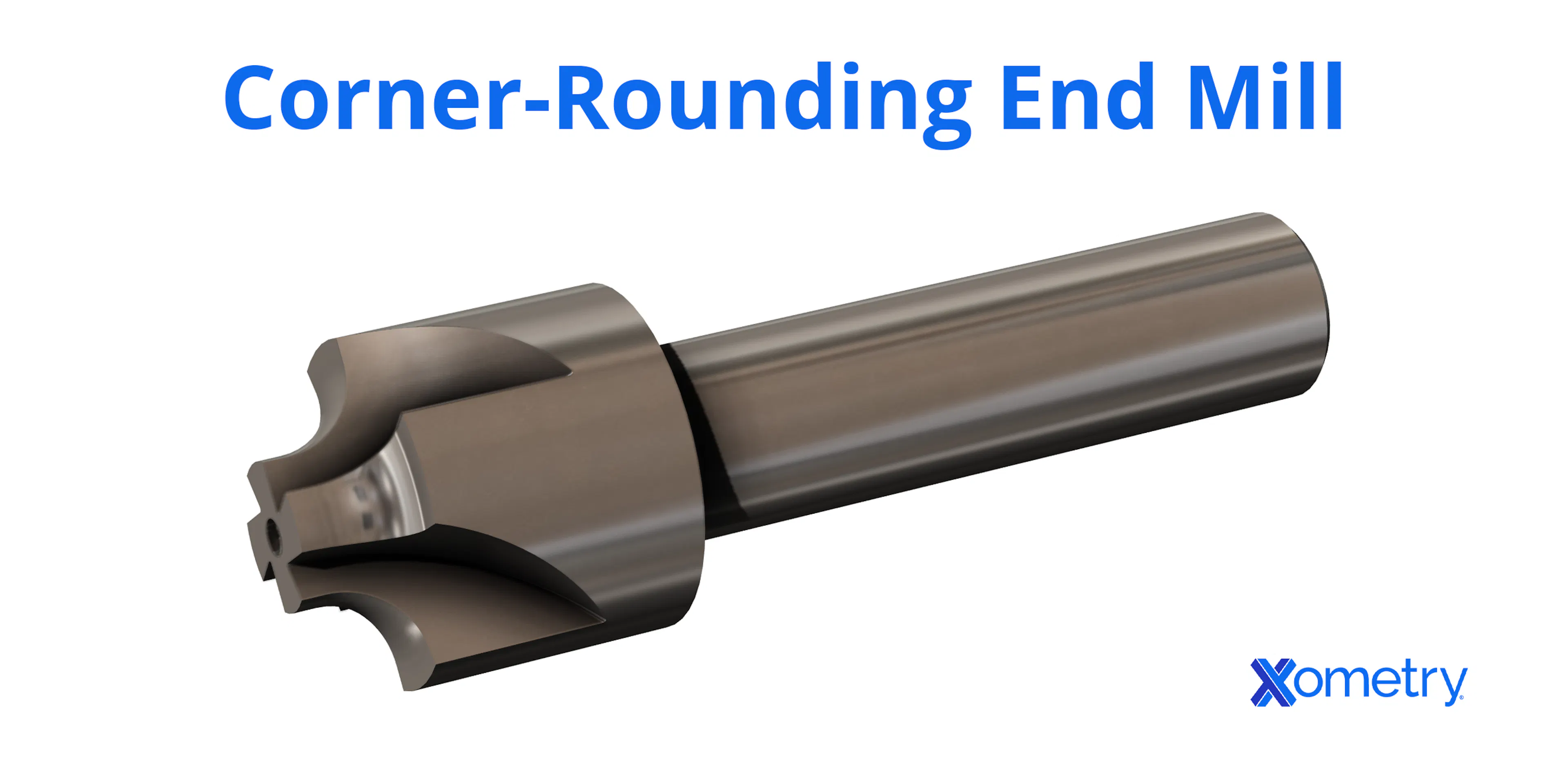

3. Corner Rounding End Mills
A corner rounding end mill is a specialized cutting tool used to round the sharp internal corners of a workpiece. It features a cylindrical shank with a radiused tip. Various radius sizes are offered, allowing machinists to select the curvature they want for internal corners. They are used for creating tool-defined filets on internal (and to a lesser extent external) corners of cuts. Rounding sharp corners removes sources of stress concentrations in parts. These tools are ideal for contouring and finishing work.
A corner-rounding end mill.
Corner rounding end mills are good for finishing operations.

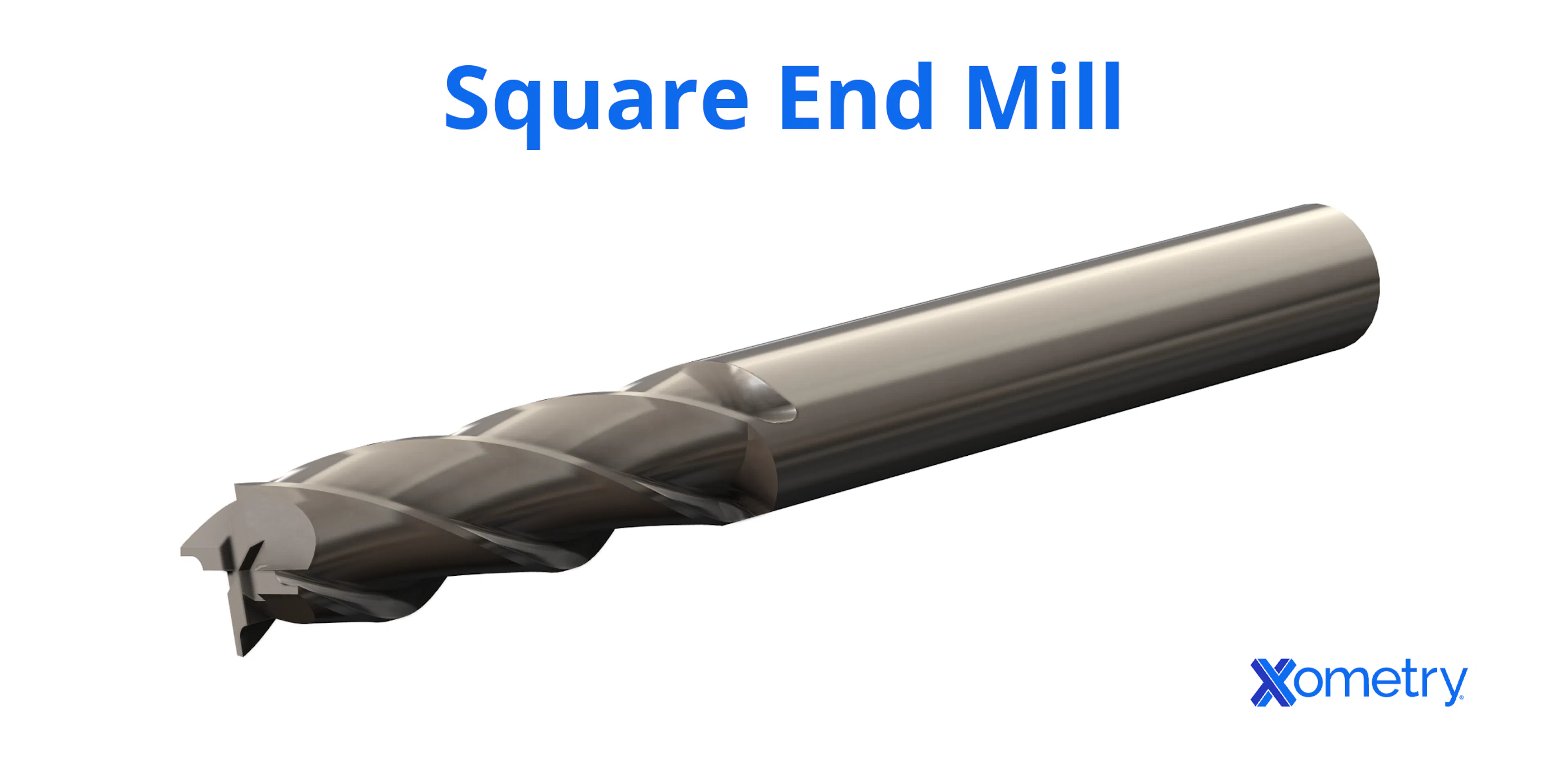

4. Square End Mills
Square end mills feature flat, square-shaped tips with sharp corners. The flat, square tip allows for straightforward machining of flat surfaces, slots, and profiles with sharp corners. Square end mills are suitable for both roughing and finishing operations on all materials. They are excellent for creating sharp 90° corners and edges. Square end mills are best suited to general-purpose cutting. They exist as two-flute, four-flute, and multi-flute types for different machining requirements.
A square end mill.
Square end mills add a level of precision to roughing operations.

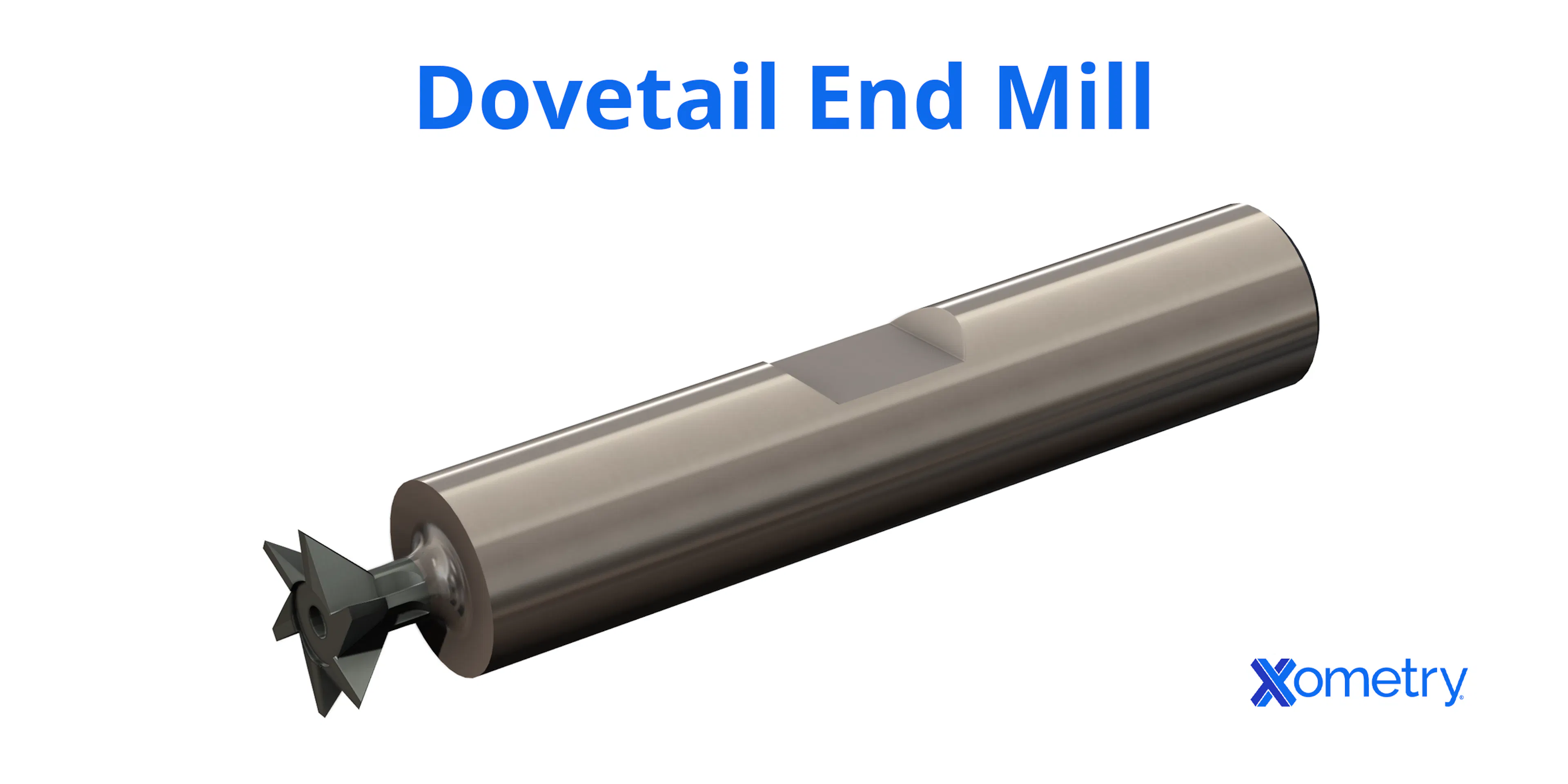

5. Dovetail End Mills
A dovetail endmill (sometimes referred to as a fishtail end mill) is specifically designed to cut dovetail grooves and slots. They work on many materials, but are most commonly employed in wood. The tip of the tool is angled to match the desired dovetail angle — typically 45 degrees — but they’re available with other tip angles as well.
A dovetail end mill.
Dovetail end mills are essential if you wish to make dovetail joints with milling equipment.

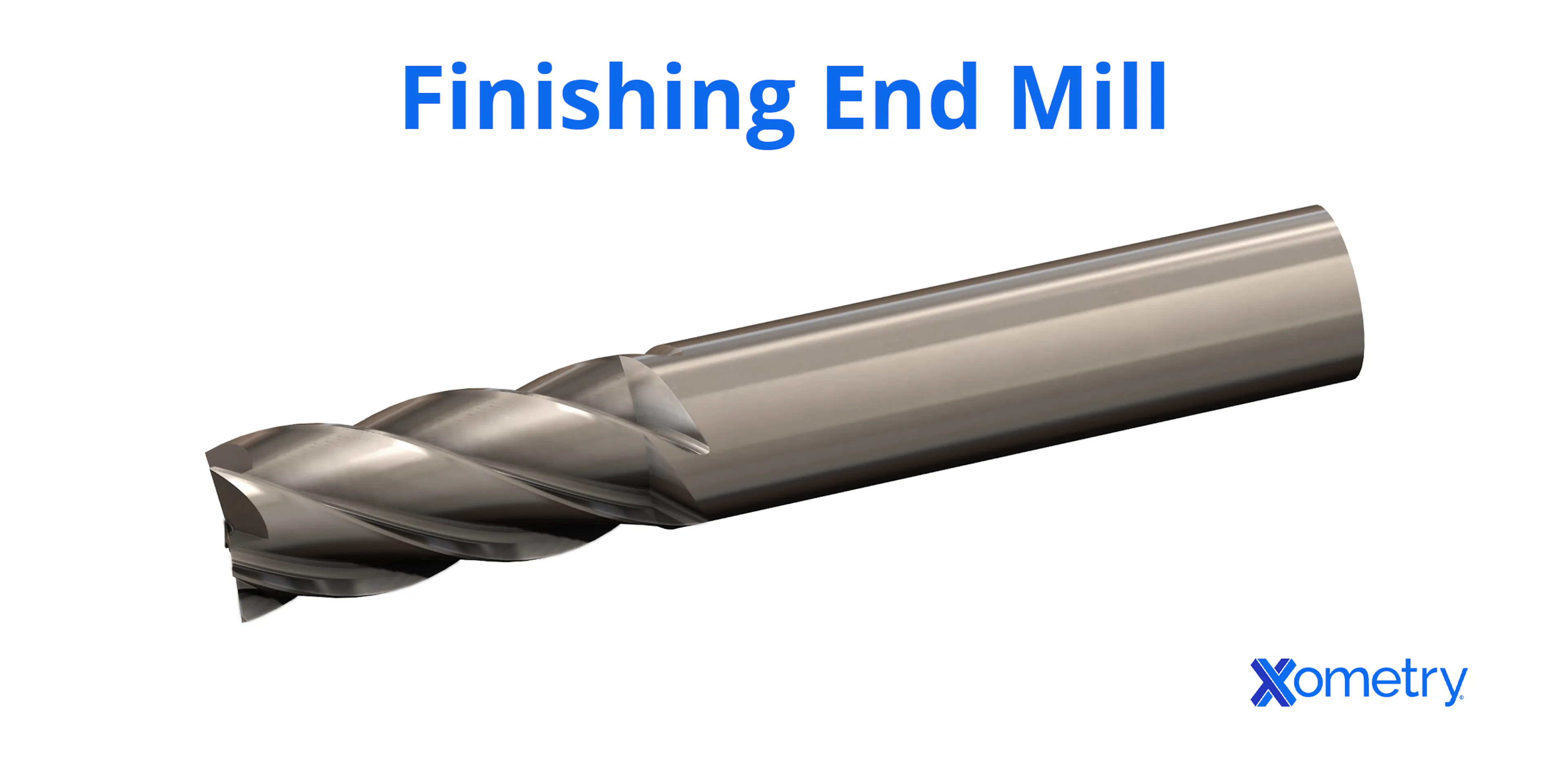

6. Finishing End Mills
A finishing end mill is a specialized cutting tool used to achieve high-precision surface finishes and tight tolerances on workpieces. Finishing end mills often have high helix angles, which help evacuate chips, increase the angle of attack for finer cutting, deliver better surface qualities, and reduce heat buildup during cutting. They are used to make fine cuts to minimize cutting forces and vibrations.
A finishing end mill.
Finishing end mills are essential in industries where superior surface quality and dimensional accuracy are critical.

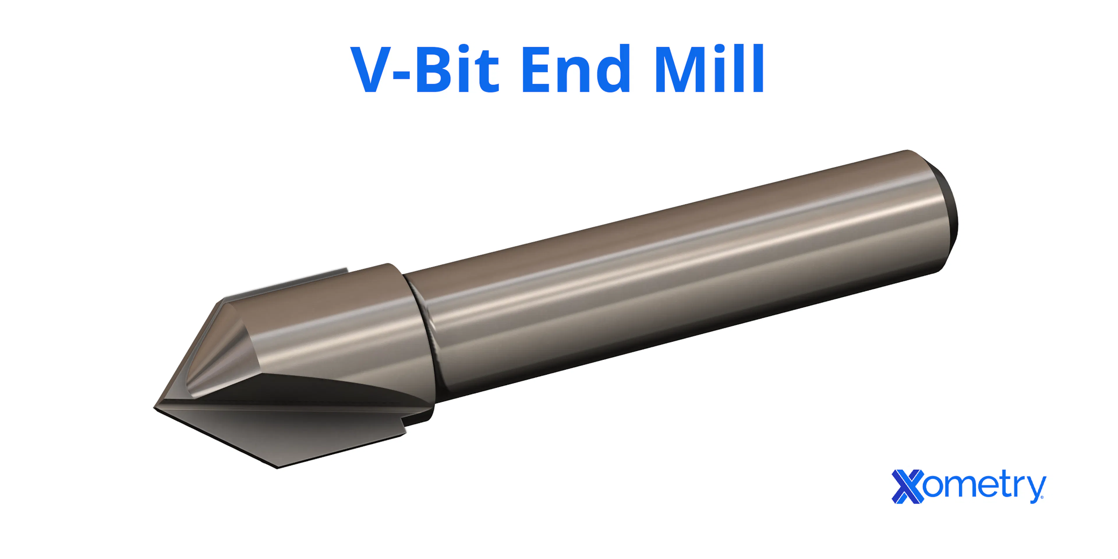

7. V-bit End Mills
A V-bit or V-carving mill is a specialized cutting tool that’s meant for engraving and carving operations. The conical tip with a sharp point allows for precise engraving and detailing. V-bits excel in engraving text, logos, decorative patterns, and fine details on all materials. They come in various angles, but the most popular are 60° and 90°.
A v-bit end mill.
V-bit end mills are essential tools for creating intricate and decorative designs and finishing details.
