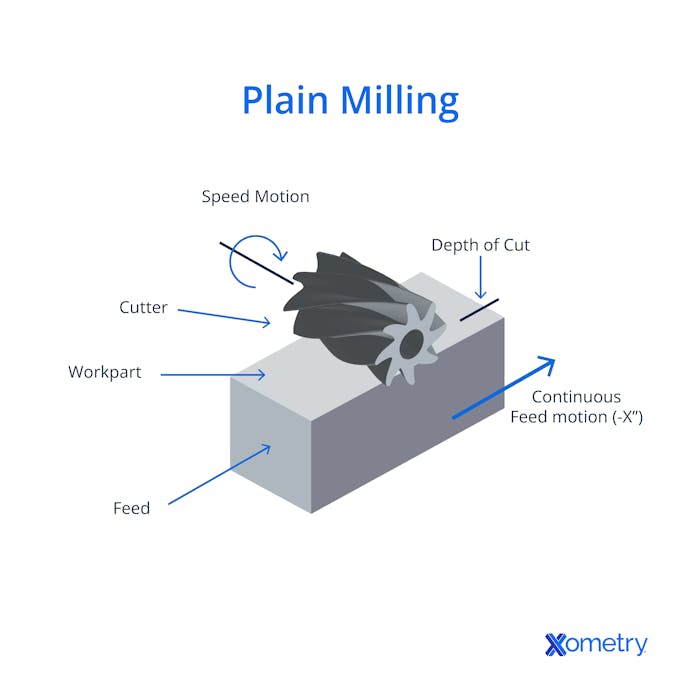

14. Plain Milling
Plain milling is the basic operation of creating a flat horizontal surface parallel to the axis of the cutter. The process uses a tool with teeth on its periphery, often called a slab mill or a plain mill. This method is used for removing large amounts of material from the top of a workpiece. Plain milling is common in the production of large plates and structural bases for machinery. The width of the cut can match the entire width of the tool for high efficiency. Surface finish is influenced by the feed rate and the diameter of the rotating cutter. High-speed steel or carbide cutters are used depending on the hardness of the metal. Machinists select this method for the initial roughing of raw stock into the required thickness. Plain milling provides a reliable way to achieve a flat reference surface for subsequent operations, like Plain Milling.
