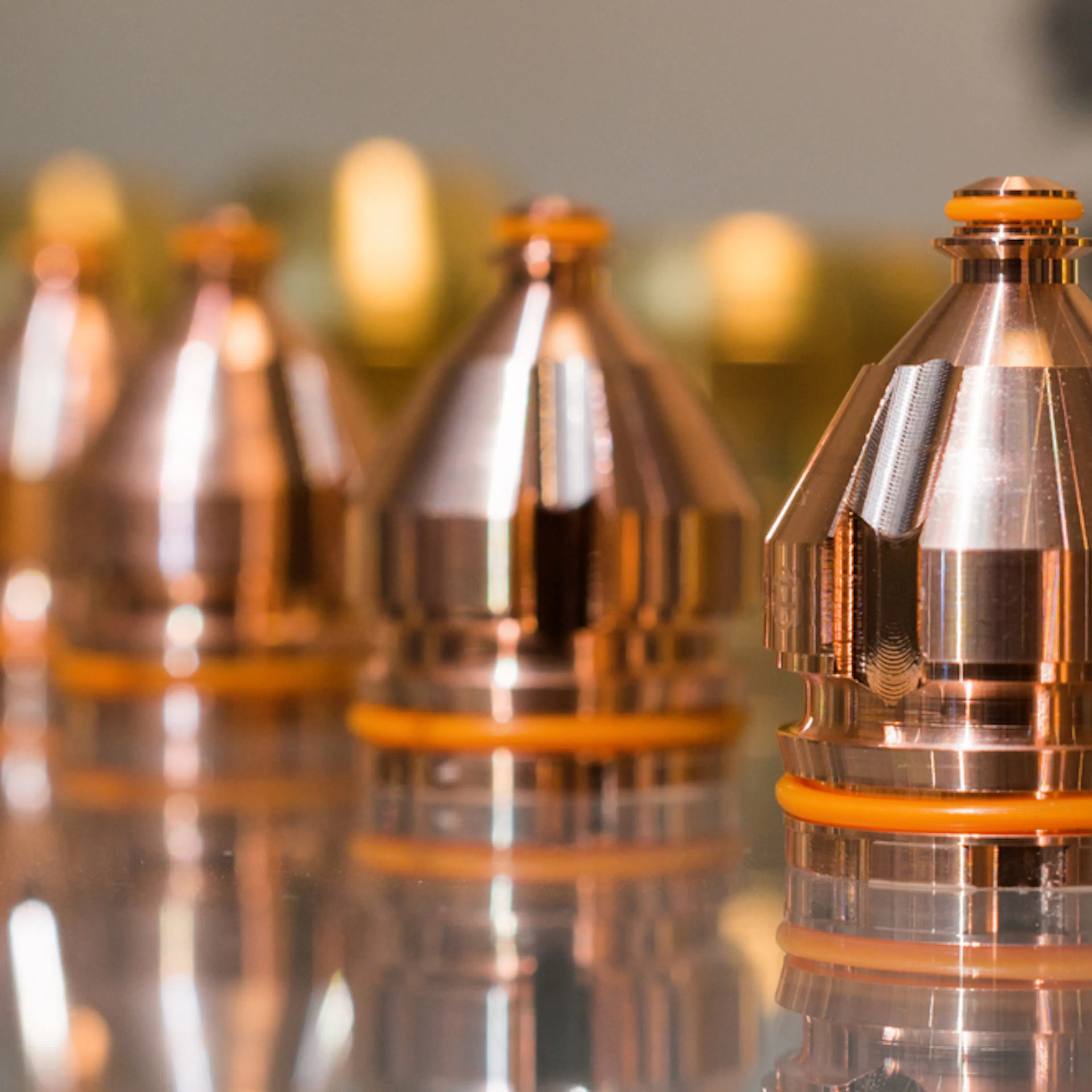

Plasma cutting nozzles. Image Credit: Shutterstock.com/Nordroden

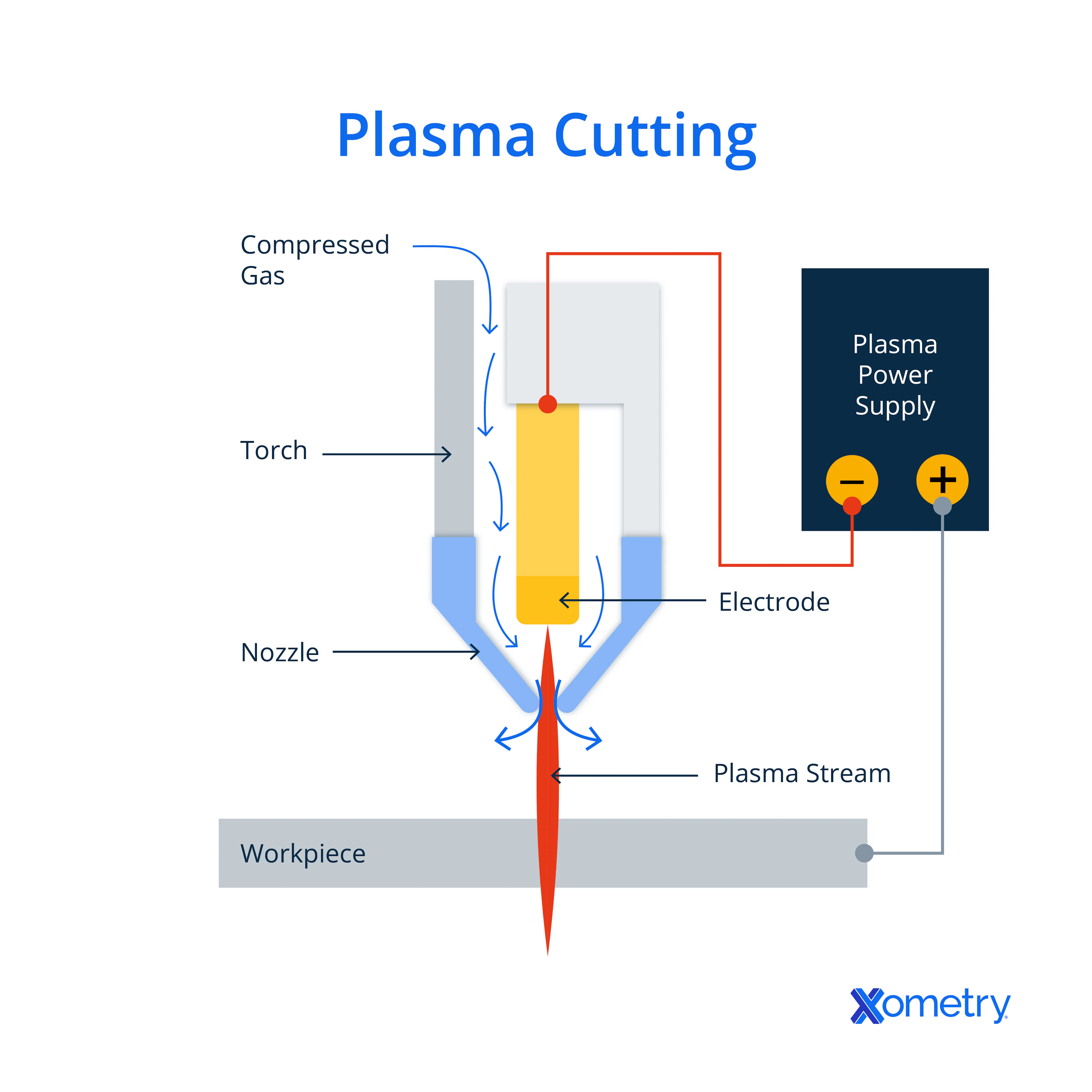

How does a Plasma Cutter Work?
A plasma cutter works by creating an electric arc that ionizes a gas stream into plasma and directs the plasma through a constricted copper nozzle. The torch electrode carries current, and the workpiece completes the electrical circuit, which creates a transferred arc for cutting. A high-frequency or contact start initiates a pilot arc inside the torch, and the arc transfers to the workpiece once sufficient proximity establishes electrical continuity. Electrical energy density inside the nozzle constriction raises gas temperature to 20,000 °C to 30,000 °C, producing a stable, electrically conductive plasma column rather than heating alone, causing ionization. The plasma jet melts metal along the cut path, and a high velocity gas stream supplied at 60 psi to 120 psi mechanically expels molten material to form a kerf measuring 0.040 in to 0.150 in depending on amperage from 30 A to 800 A. Torch height, cutting current, gas pressure, and travel speed directly influence arc voltage, kerf geometry, dross adhesion, and edge angularity, which explains how does a plasma cutter work through controlled electrical and thermal energy delivery within a plasma cutter system.

  • Torch and Consumables: The torch directs plasma through a nozzle to form the cutting jet. Consumables include the electrode, nozzle, swirl ring, and shield cap. Consumable condition strongly affects kerf quality and dross levels.

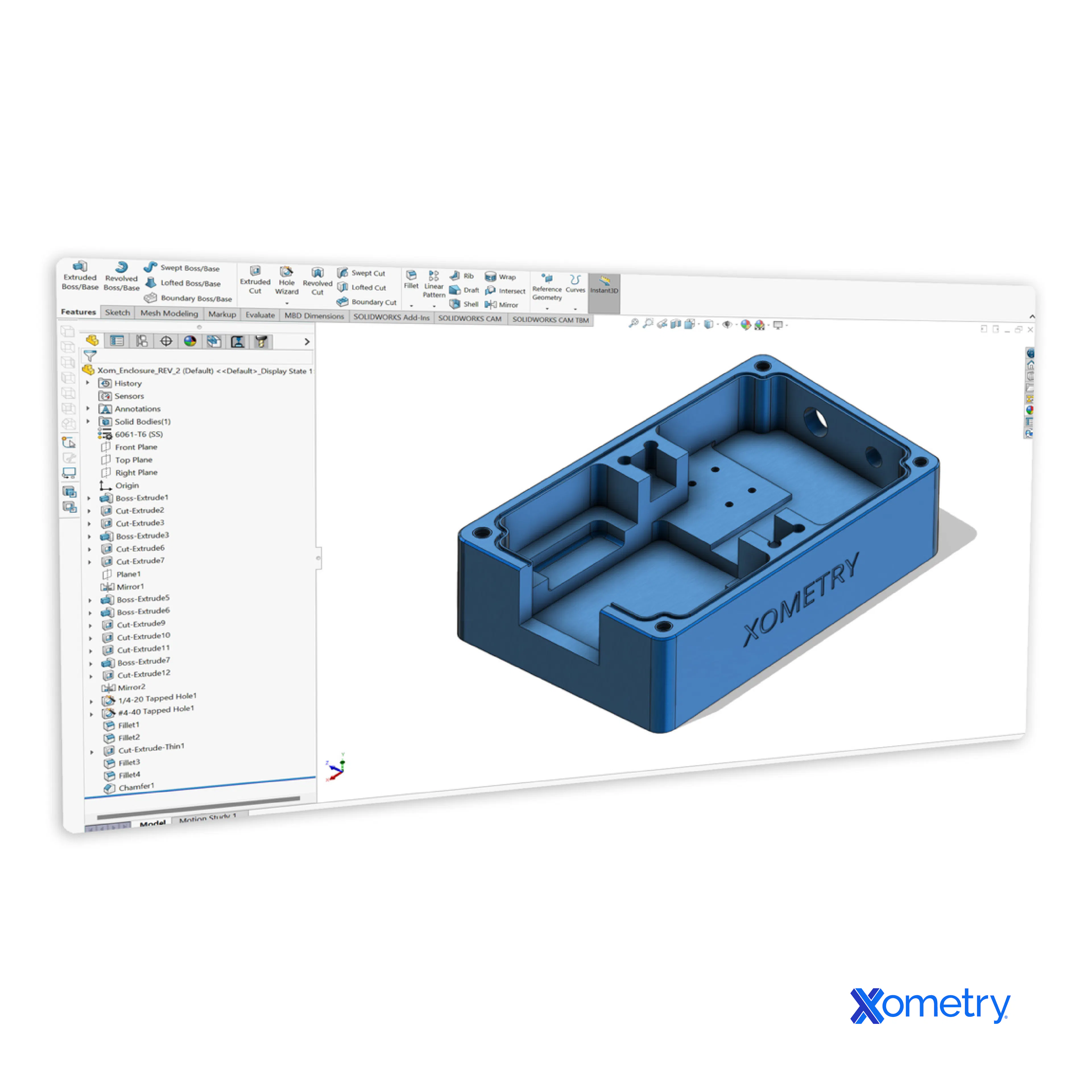

CAD model

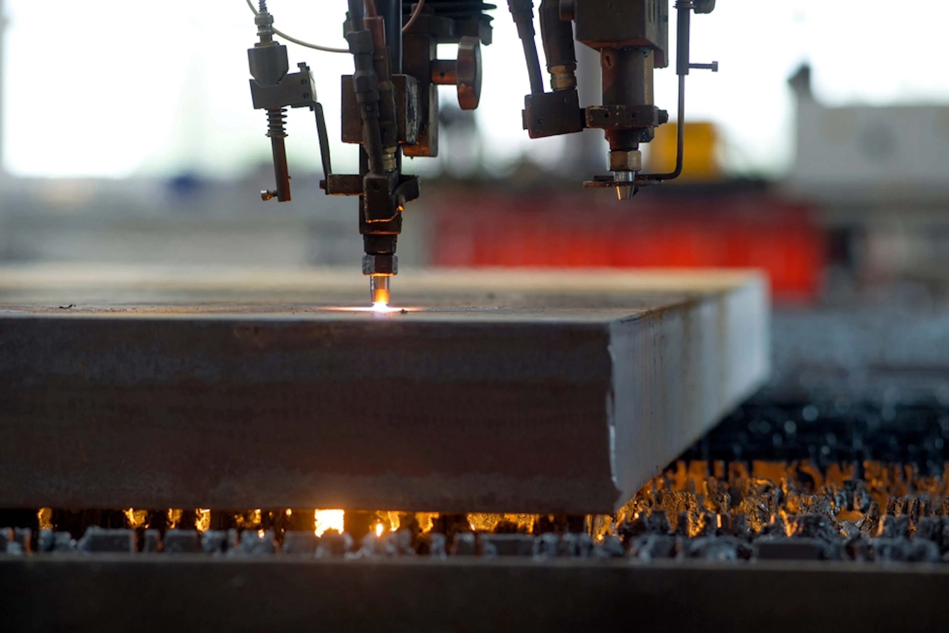

Is Plasma Cutting Used for Profile Cutting?
Yes, plasma cutting is used for profile cutting. CNC motion control guides the plasma torch along programmed contours to cut external profiles and internal features. The process is used for brackets, base plates, gussets, signage, and structural parts made from electrically conductive metals (carbon steel, stainless steel, aluminum). Profile cutting works best on sheet and plate, where 2D geometry defines the part shape. Cut accuracy depends on machine rigidity, motion calibration, torch height control, consumable condition, and cutting parameters (amperage, speed, gas pressure). CNC programming improves repeatability for nested production runs and consistent part geometry.
Flame cutting thick-gauge steel.
