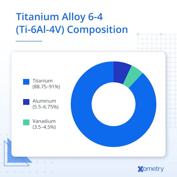

Titanium alloy 6-4, or grade 5 titanium, is often referred to as the workhorse of the titanium industry due to its balanced set of properties. Titanium 6-4, also known as Ti-6Al-4V alloy, is an alpha-beta titanium alloy in which aluminum acts as the alpha stabilizer, and vanadium acts as the beta stabilizer. Ti-6Al-4V composition is 5.5–6.75% aluminum and 3.5–4.5% vanadium, with the remaining percentage being titanium. Titanium alloy 6-4 combines high strength, stiffness, corrosion resistance, and low density, making it useful in aerospace, automotive, and medical applications. Its use in these industries, as well as others, has led to a host of new products that are lighter, more efficient, and safer.
Titanium Alloy 6-4 (Ti-6Al-4V) Composition
