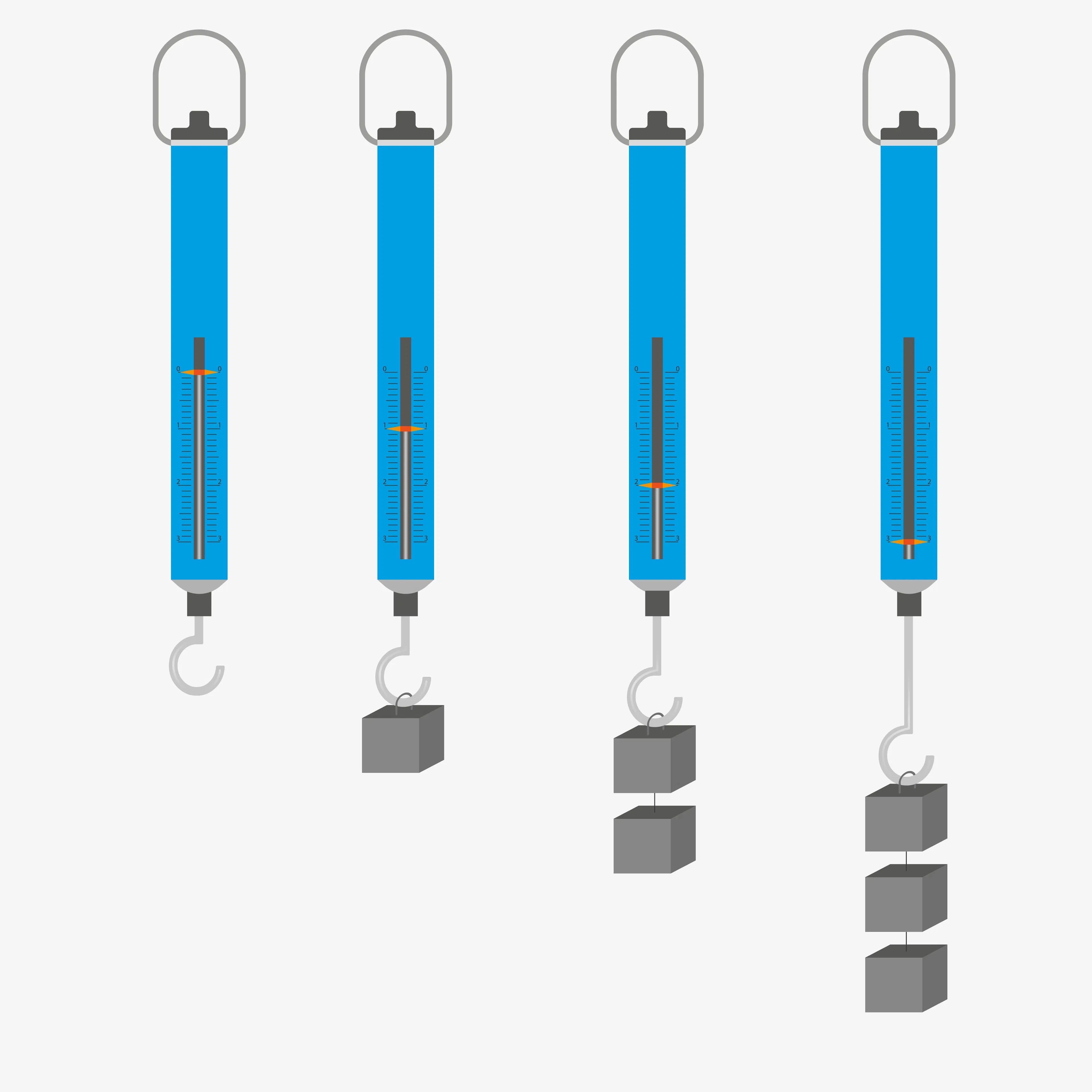

Spring gauge. Image Credit: Shutterstock.com/mse_design

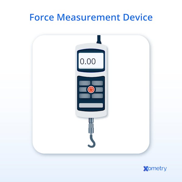

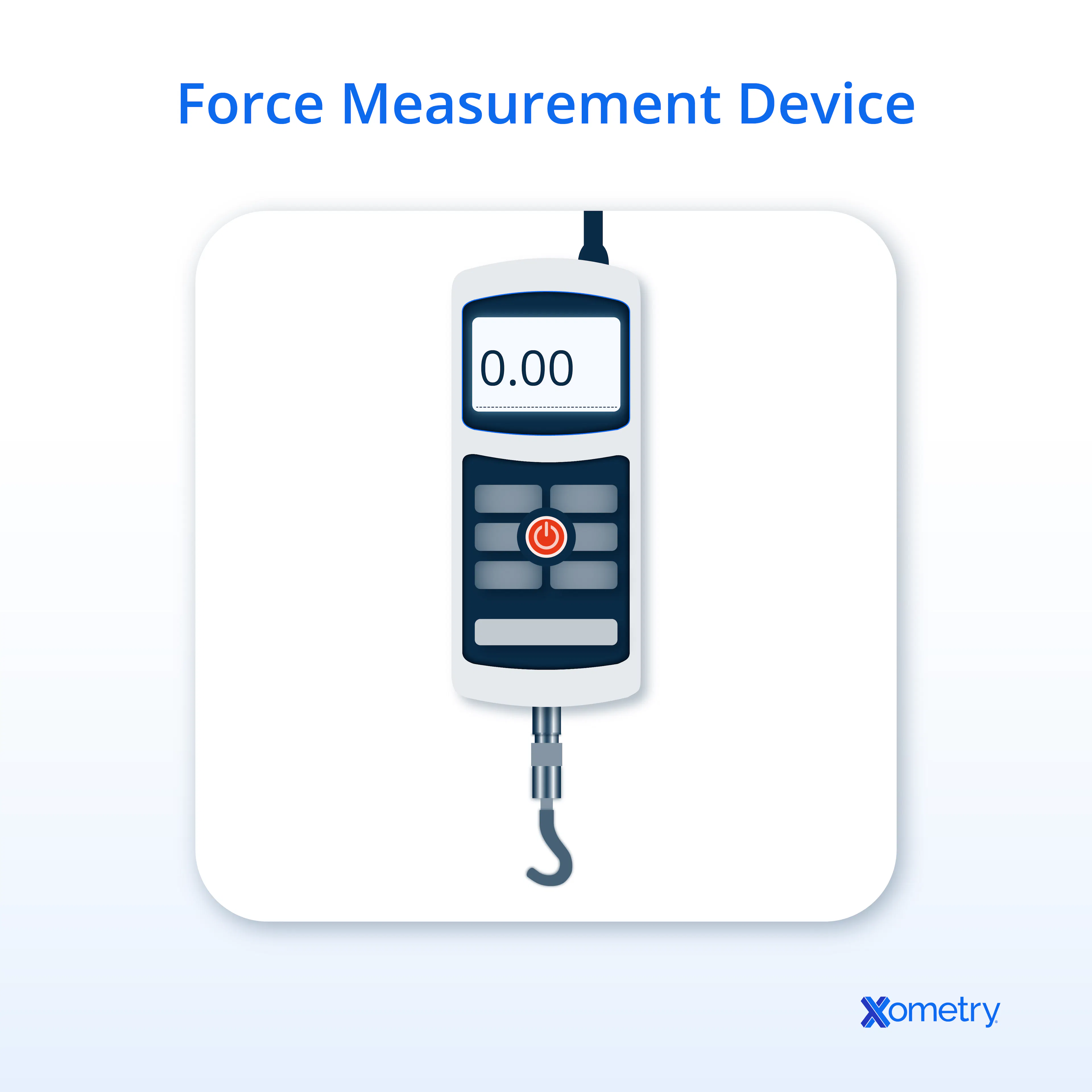

What Is a Force-Measurement Device?
A force-measurement device is a piece of equipment used to quantify the magnitude and direction of an applied force or load. The device typically consists of a force transducer (such as a load cell or strain gauge) that senses the applied force, and a signal processing/display unit to present the measurement. In mechanical (analog) devices, spring-based systems like Bourdon tubes or dial gauges are used instead of electronic transducers. Several types of force-measurement devices can measure a range of loads for different applications.
Illustration of a force measurement device

2. Spring Scales
Spring scales, also known as spring balances, are analog force-measurement devices that determine the force applied by measuring the extension of the scale’s spring while under load. Spring scales are used to measure the force applied by gravity (weight), by connecting the attachment point of the device to a stable fixture and then suspending the material to be measured from the other end of the device. The device works on the principle of Hooke's Law, which describes the relationship between the extension of a spring and the force applied to the spring.
The main advantages of spring scales are that they are simple in design, cheap, and portable. The disadvantages are that they are less accurate than electronic alternatives, can not measure high loads, and require frequent recalibration.
Temperature variations affect measurement accuracy, as the spring’s elastic modulus changes, altering the force-extension relationship defined by Hooke’s Law.
Spring scales can be used in various settings to measure light loads and liquids; however, when measuring the weight of liquids, a container of a known weight will be required.
