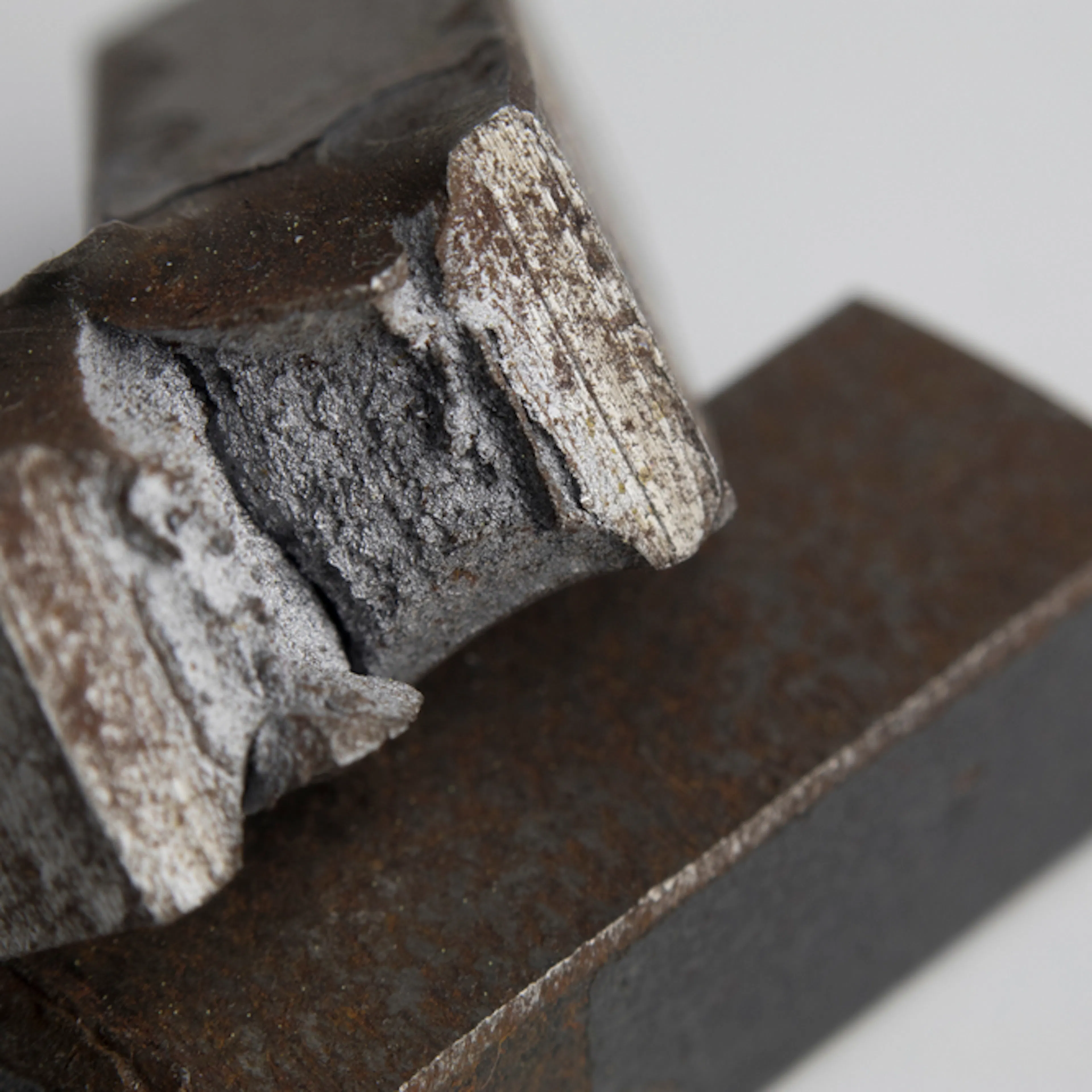

Fracture toughness tests determine a material's resistance to crack propagation and therefore fracture, which is one of the fundamental material properties. It works by applying a constantly increasing load to a material until failure, to work out how much energy can be absorbed. Fracture toughness is important to know as all materials have or will develop flaws during manufacture or service which are prone to crack propagation. The probability of failure can be determined by understanding how a material responds to stress at a stress concentration point.

The fracture toughness test works by applying a constantly increasing load until the material fails. The material must first be prepared by creating a fatigue notch where the crack can propagate from. This process is usually done with EDM machining. Then the material is subject to loading. There are three modes of testing: mode 1, mode 2, and mode 3. Mode 1 applies loading in a tensile direction, mode 2 applies a load in-plane (resulting in shear stress), and mode 3 is a mixture of the two.

Material specimens are prepared for a fracture toughness test by EDM machining a notch into the test specimen. There are two main shapes to a test specimen—Single Edge Bent (SE(B)), and Compact Tension (C(T)). An SE(B) specimen is long and rectangular with a notch cut in the midpoint of the length. A C(T) is a square with a notch cut at the midpoint of the height of the square and two holes on either side of the notch to load a tensile force. The thickness of the specimen is determined by the standard used. In ASTM E399, testing aluminum, the three thicknesses to test are ⅛", ¼", and ¾".
