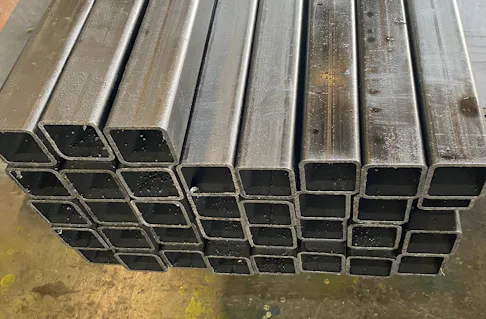

A strong and affordable industrial material
High-carbon steel. Image Credit: Shutterstock.com/saweang.w
It will come as no surprise that there’s a lot of carbon in high-carbon steel, and it’s exactly that which makes this metal extra strong, hard, brittle, and wear- and corrosion-resistant. It’s not likely to break under pressure, and is considered great value for money. Let’s look at what this steel type is, how it’s made, what its properties are, and how else it is used in industry by many Xometry customers and other designers and engineers.

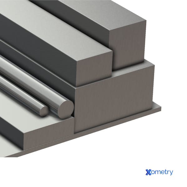

Also known as carbon tool steel, or M2, high-carbon steel refers to any steel with a carbon content of over 0.6%. Any lower than that, then it falls into the medium- or low-carbon category. If it’s higher than 1.0%, it belongs to the ultra-high-carbon steel group. This type of steel has a very simple composition: in addition to the 0.60–1.00% carbon, it’s made up of just 98.1–99.1% iron, and 0.30–0.90% manganese.
steel bars
Steel bars
Like other steel types, high-carbon steel is made by melting either recycled steel or pig iron to remove impurities, and then adding the alloying elements before casting or extruding. Molten steel, by nature, dissolves carbon at high temperatures, but will typically release it if it is allowed to cool slowly. So as not to allow the carbon to escape the metal’s lattice structure, the metal is quenched (rapidly cooled) to increase the cooling rate from about 200°C to 1000°C per minute. This retains all the internal stresses in the microstructure—although “internal stress” sounds like a bad thing, it’s not—in this case, it improves the steel’s strength and hardness.
Carbon steel is commonly used to make a wide variety of appliances, toys, tools (i.e. knives, swords, shears, etc.), gear wheels, chains, and hardware like nails, fasteners, drill bits, and springs (pictured below).
