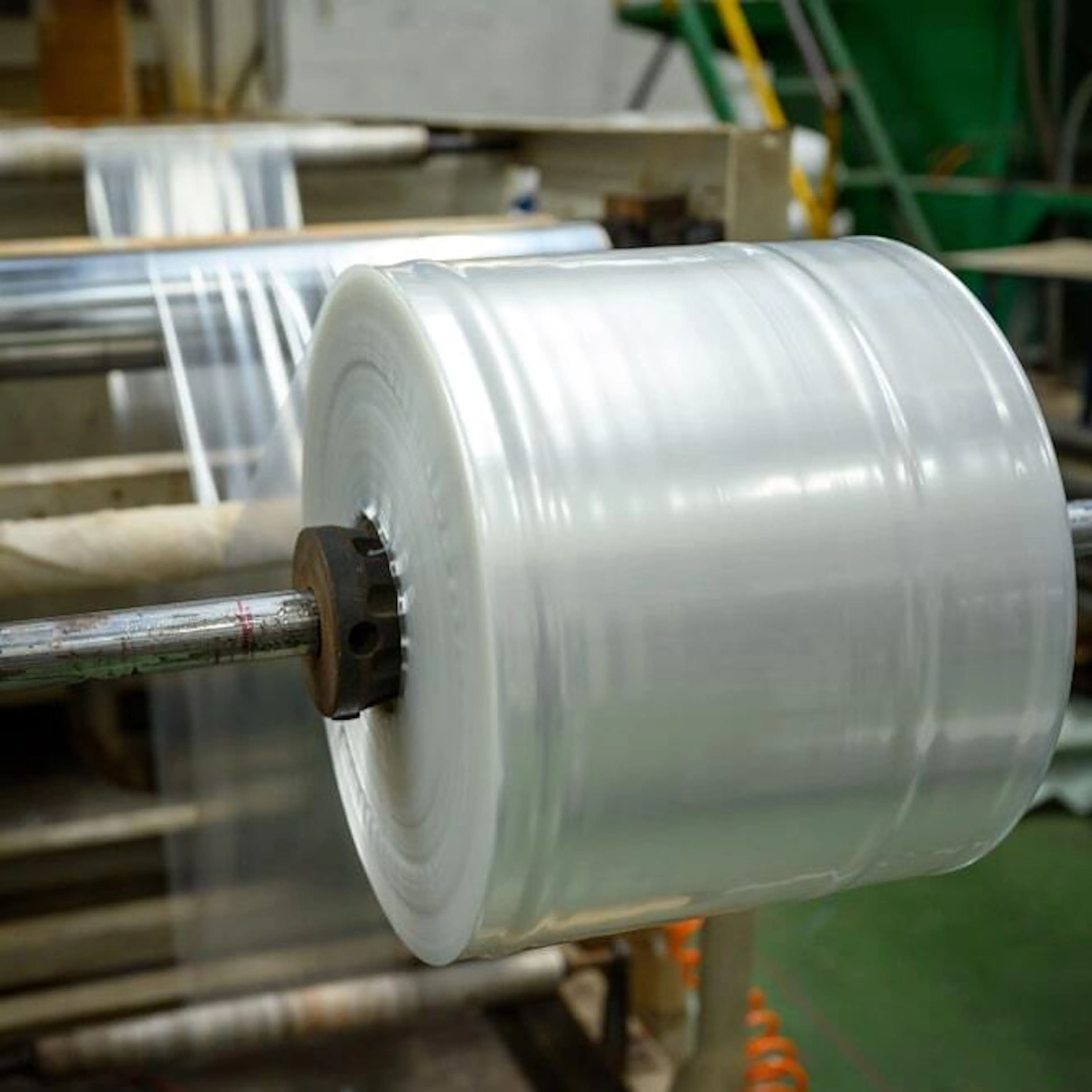

Low density polyethylene (LDPE) film production machinery. Image Credit: lowpower225/Shutterstock.com
Linear low-density polyethylene is a commodity thermoplastic that is widely used in the packaging industry. It is valuable there because it can easily be formed into film-like materials that retain significant tensile strength. Its molecular chains contain relatively short branches when compared to other polyethylenes. This article will go into more detail about what this material is, its use cases, and its effect on human health.

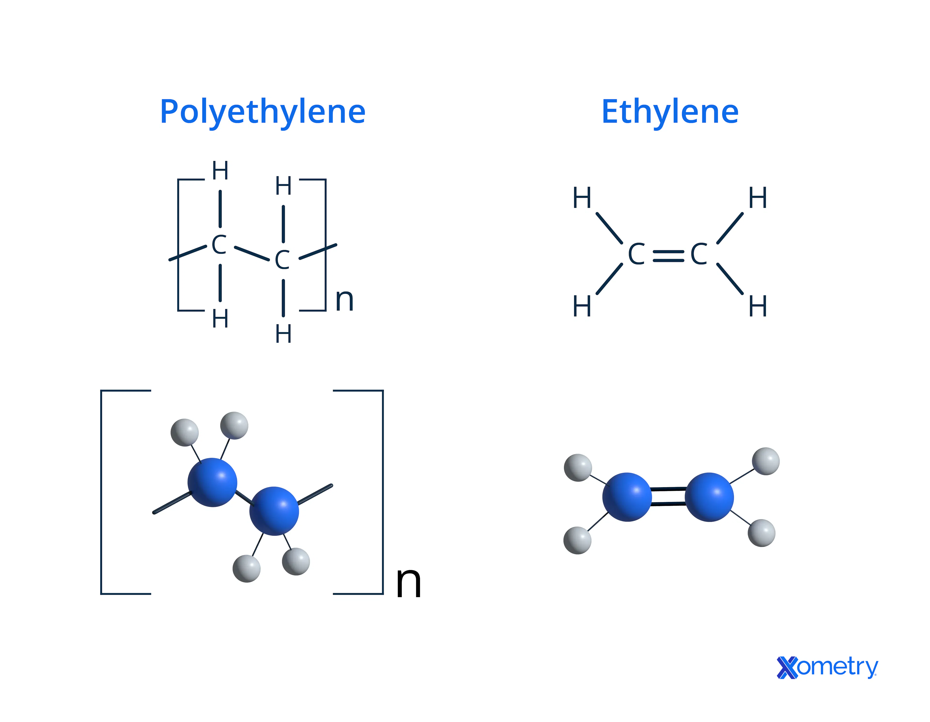

Linear low-density polyethylene is a semi-crystalline polymer with many short branches on its main molecular chains. This means that these linear molecules do not become entangled as easily as LDPE and HDPE.
LDPE Diagram
LDPE Diagram
