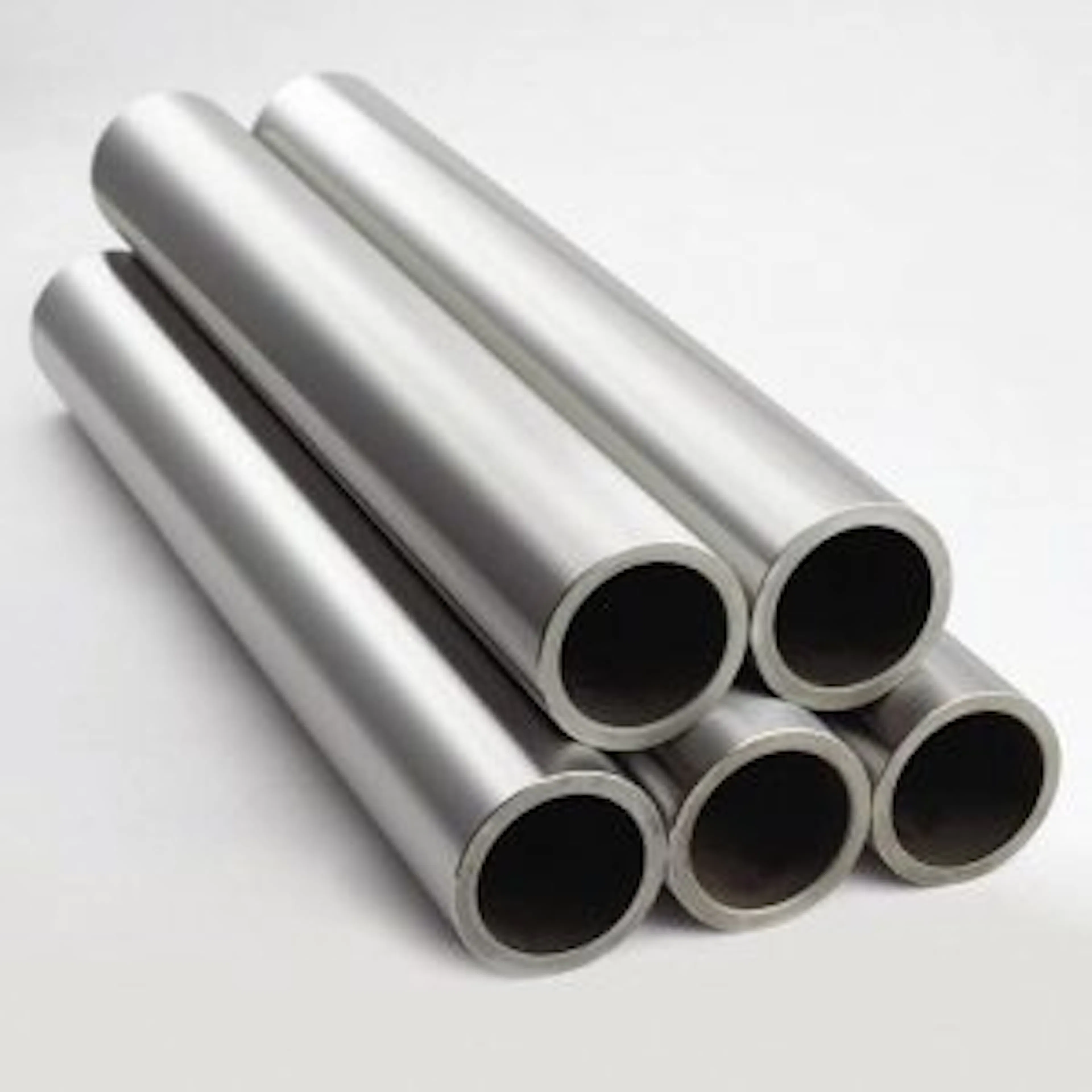

Monel. Image Credit: https://www.chemistrylearner.com/monel.html
Monel® 400 is a nickel-copper alloy renowned for its exceptional capabilities across many applications. With its unique combination of corrosion resistance, high strength, and excellent mechanical characteristics, Monel 400 has found its place in numerous industries across the globe. From marine and chemical processing to aerospace and electrical equipment, this alloy has proven its mettle in challenging environments.
This article will discuss Monel 400, its diverse uses, detailed composition, and key properties.
What Is Monel 400?
Monel 400 (also known as Phyweld 400 and Nicorros LC), is a nickel-copper alloy that is known for its excellent corrosion resistance in a wide range of environments. It is composed of approximately 63-70% nickel and 28-34% copper, along with small amounts of iron, manganese, carbon, and silicon. It possesses a single-phase structure, forming a solid solution of nickel and copper. The material exhibits significant strength, corrosion resistance, ductility, and thermal conductivity.
Such properties make Monel 400 valuable to many industries. Some typical uses of Monel 400 include chemical processing equipment, hydrocarbon processing facilities, marine engineering components, and heat exchangers. Its corrosion resistance makes it suitable for environments where it’s exposed to seawater, alkaline solutions, and organic, sulfuric, hydrofluoric, or phosphoric acids. Additionally, its excellent thermal conductivity makes it an attractive choice for heat-transfer applications. For more information, see our guide on Monel.
