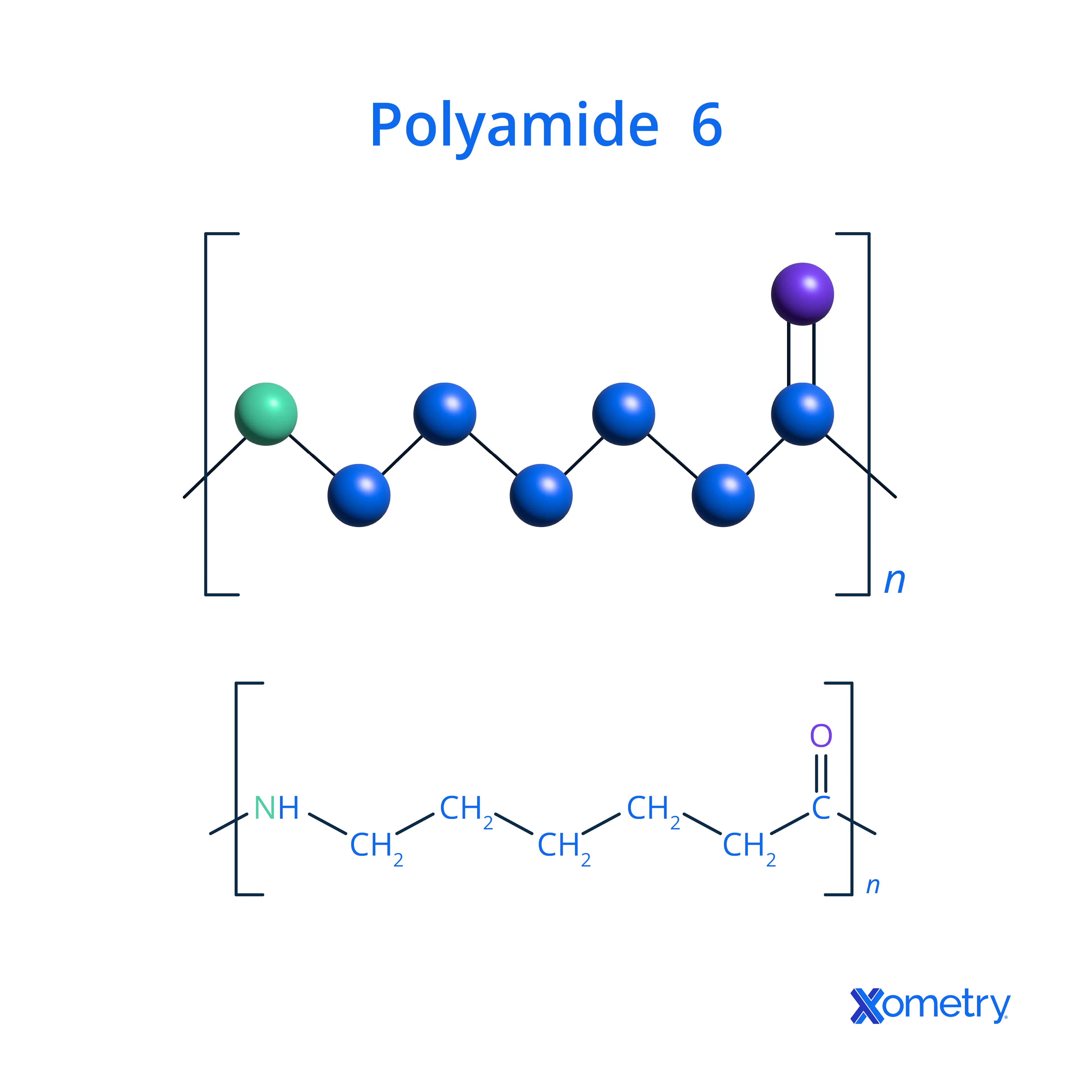

The molecular structure of Polyamide 6

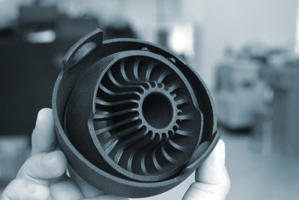

What Does a Polyamide Look Like?
Polyamide’s appearance will vary greatly depending on how it is dyed or painted and whether it comes in woven fabric or solid form. You’ll see Xometry’s “X” printed in a white polyamide material in the image below.

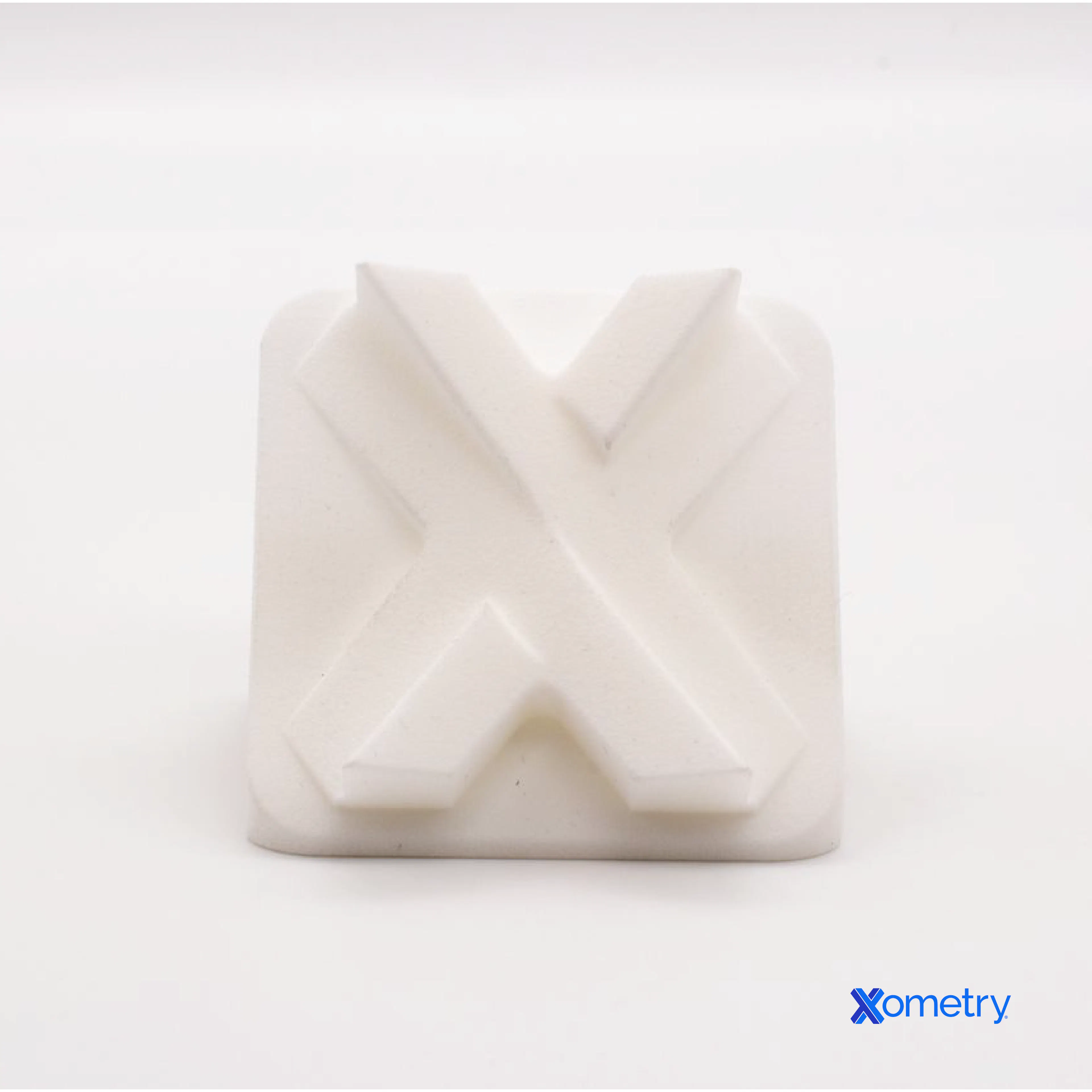

Polyamide 3D printed part
Polyamide 3D printed Xometry "X"
The rough surface finish is a product of the 3D printing process. If a polyamide is extruded into a solid it will be a lot smoother and could be a different color.

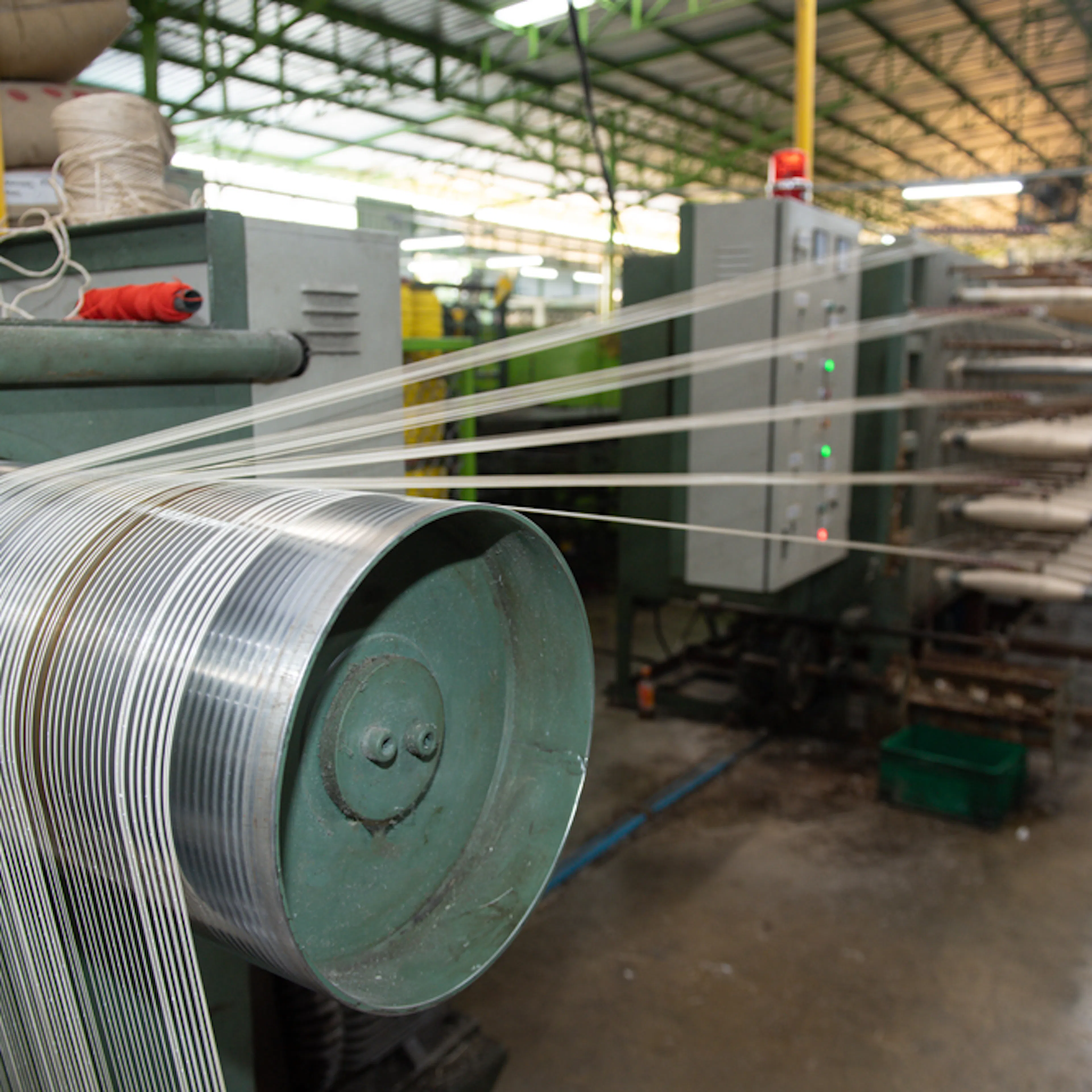

Textiles and fibers are one of the first applications of polyamides. Fibers are long, thin extrusions of polyamide which can then be woven into a textile for clothing, bedding, upholstery, curtains, and carpets. The main benefits and reasons for using polyamides in textiles are they are cheap, wear-resistant, flexible, and strong.
