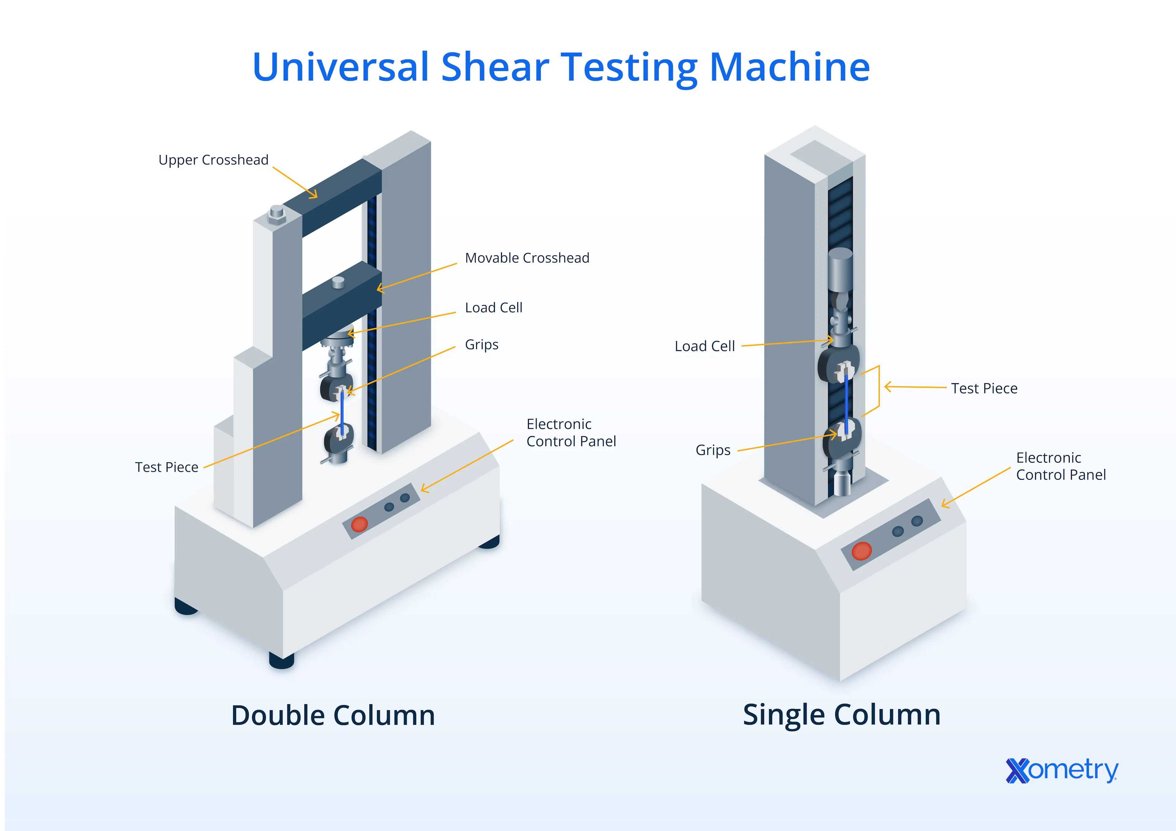

What is the Equipment Used for Shear Testing?
The equipment used in the shear test is given below:
  • Single/Double-Column Universal Testing Machine: A single/double-column universal testing machine measures the strength of several materials by conducting shear, hardness, tensile, and compression tests in a single environment.
Double and single column universal shear testing machines

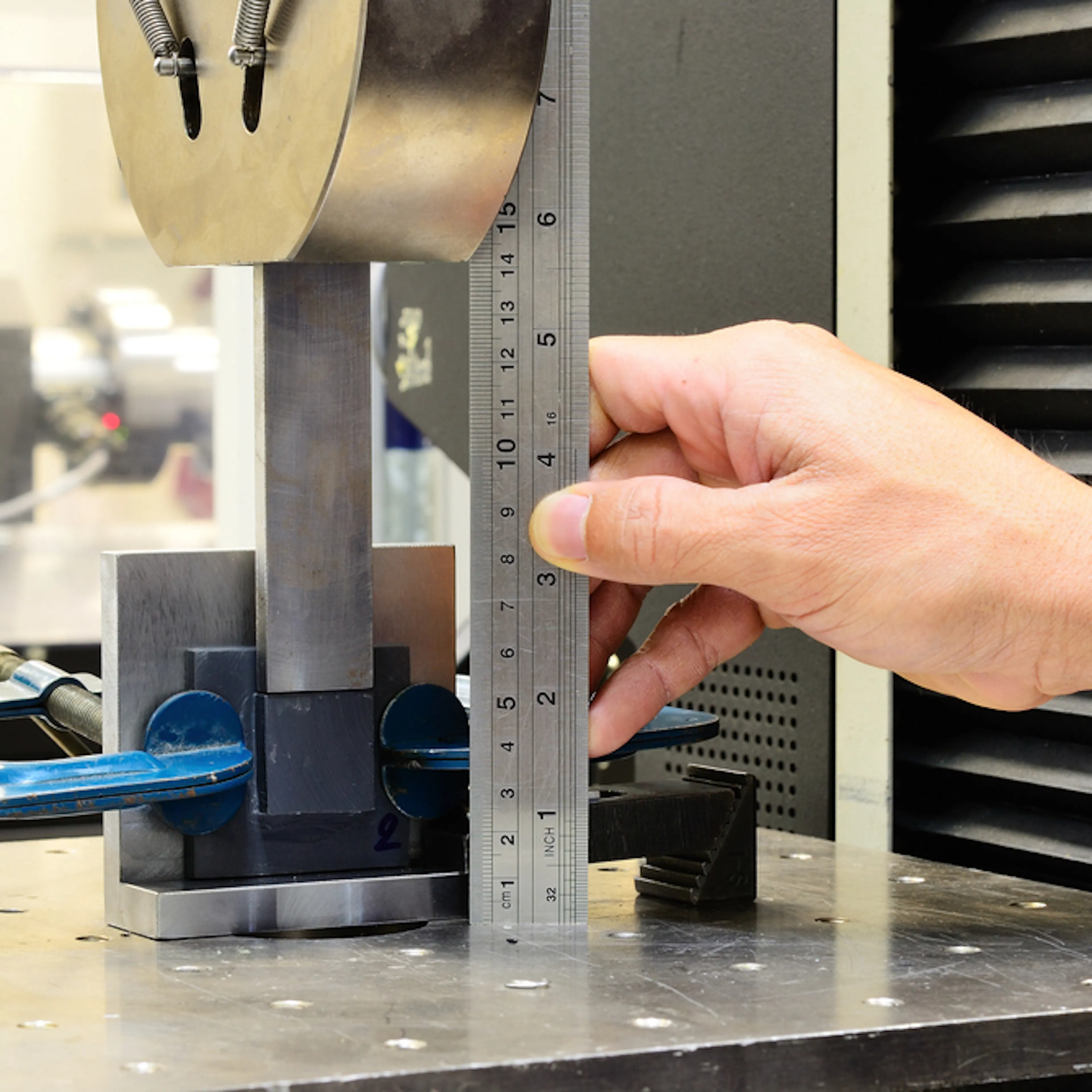

How Does Shear Testing Work?
Shear testing is carried out by using a shear testing tool to determine the resistance of a material to shear stress or deformation during various loading scenarios. Shear testing is widely used to determine features such as ductility, toughness, yield strength, strain hardening exponent, and rigidity modulus of materials (e.g., polymeric, composite, metallic, and ceramic) through specific tests such as in-plane, punch, single, double, direct and torsion.
A shear test is typically conducted using a universal testing device following fundamental steps such as sample preparation, test setup, machine calibration, setting of parameters, test running, data collection/analysis, and reporting. The sequence of these steps is briefly explained below:
  1. The test sample is prepared according to the guidelines outlined by the test standard and type of the test.
  2. The test sample is carefully placed in the universal testing machine to prevent unintended stresses or shears prior to the test.
  3. The test machine and equipment are calibrated to ensure accurate measurements.
  4. Parameters of the test machine (loading rate, maximum rate, etc.) are set according to the test standards. The universal testing machine applies a load to the test sample at a set rate until the material starts deforming.
  5. Variation of the deformation with the load is recorded and analyzed by plotting stress-strain curves to calculate shear strength and modulus of the material.
  6. Features of the test sample, test conditions and results are reported in a document in detail. Yield shear stress, shear modulus, stress-strain curves and deformation data are the major results that can be obtained from a universal testing machine.
