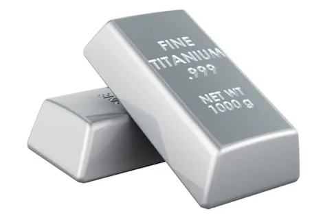

Titanium ingots. Image Credit: Shutterstock.com/AlexLMX

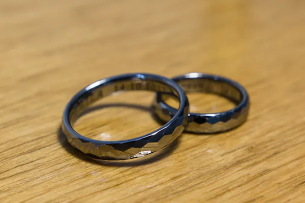

tungsten wedding rings
Two Tungsten wedding rings. Image Credit: Shutterstock.com/Lapis2380

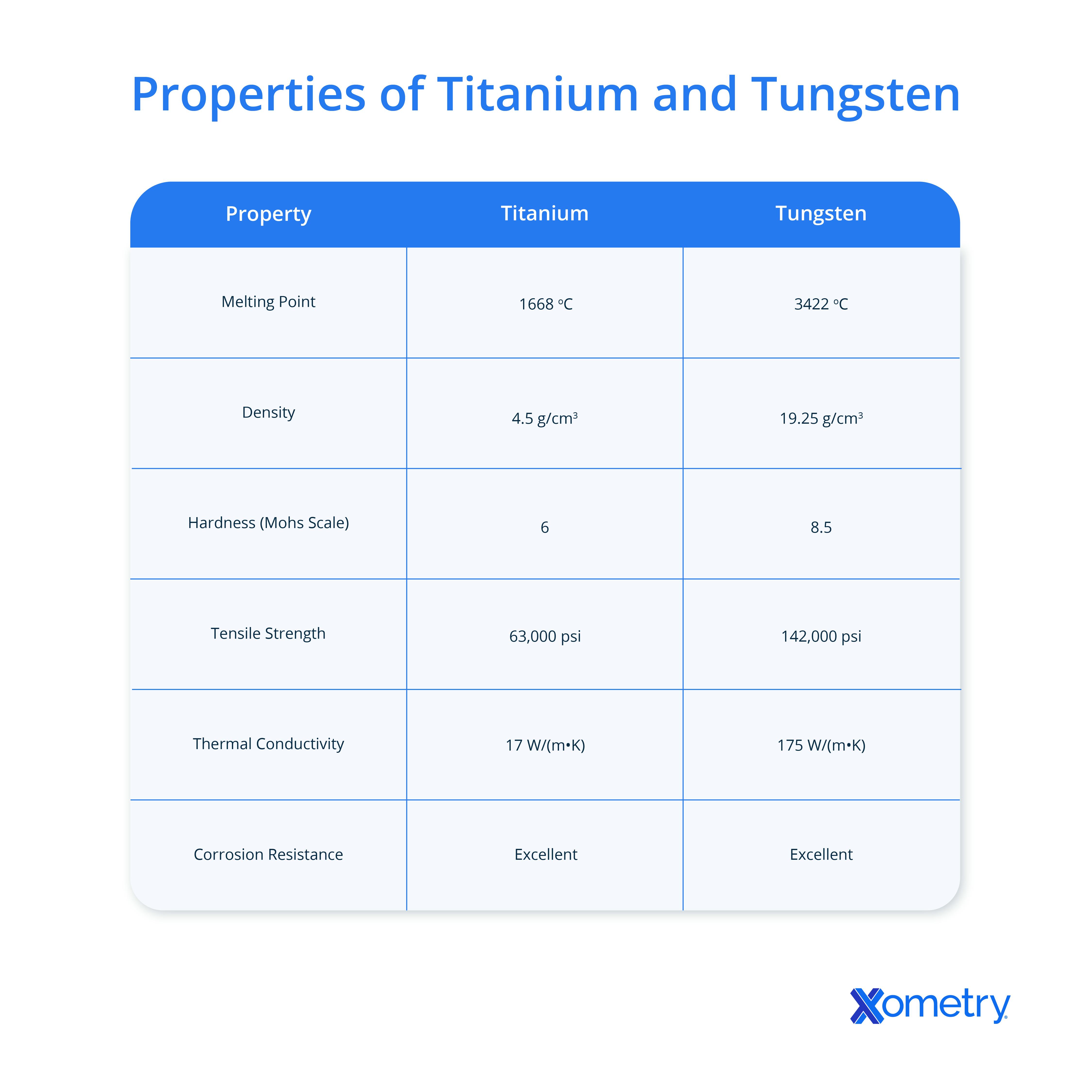

What Are the Properties of Titanium and Tungsten?
For ease of reference, we’ve made the below comparison table with both tungsten and titanium’s properties.
properties of titanium and tungsten
Table 1. Properties of Titanium and Tungsten
