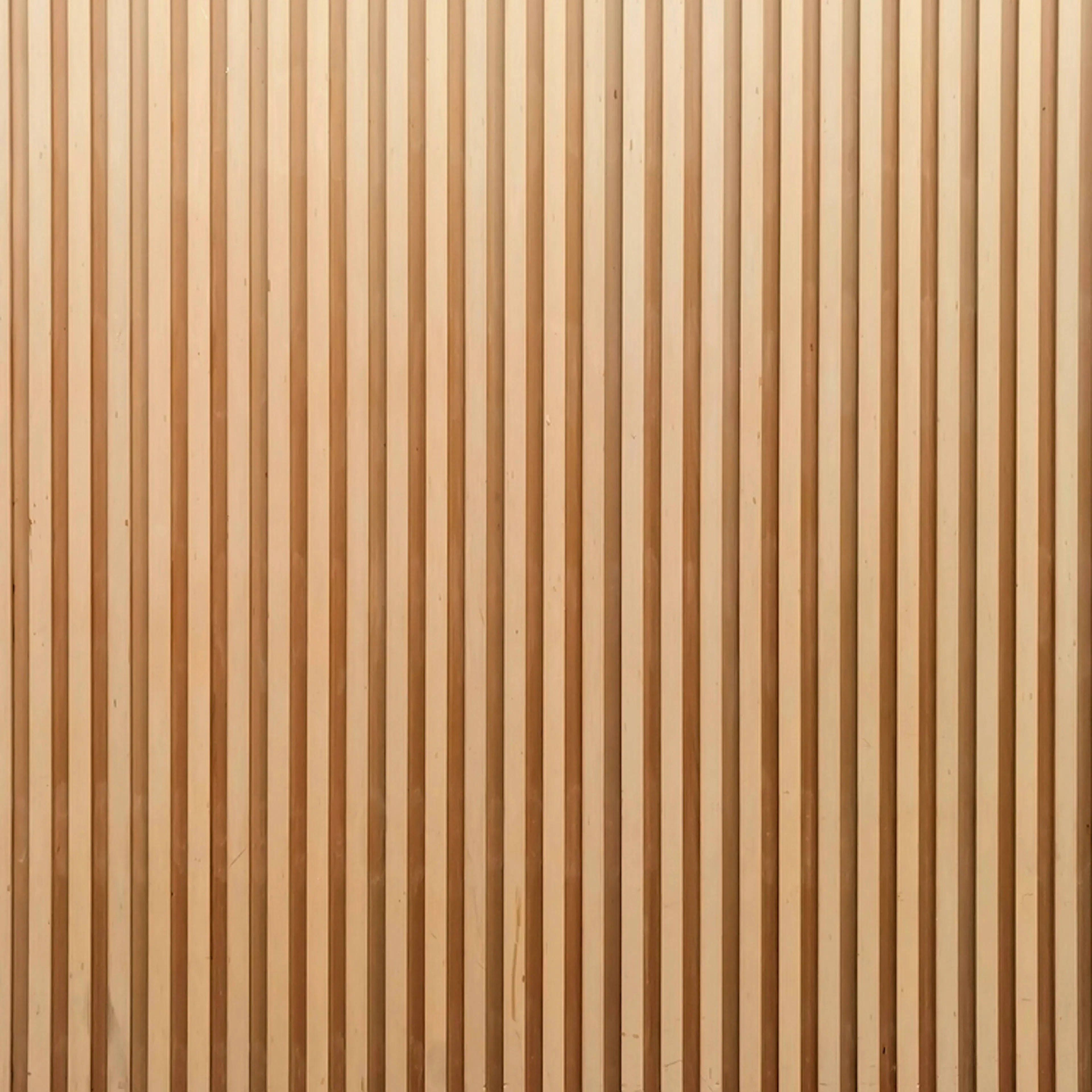

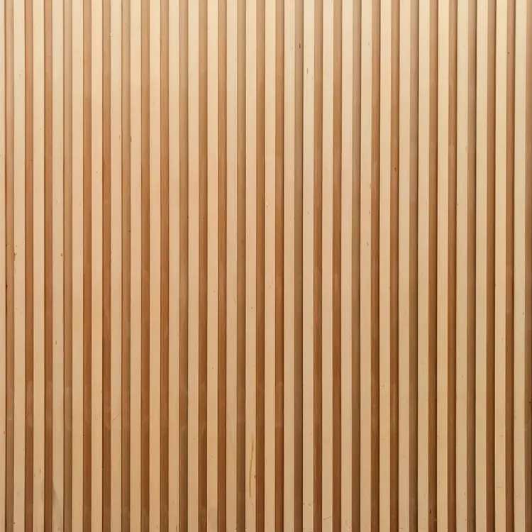

Wall cladding. Image Credit: Shutterstock.com/Purisitp

  3. Building and Construction: TPO is used in roofing membranes, wall claddings, window profiles/seals, and piping systems in the construction industry due to its durability, weather resilience, and low-cost processing.
