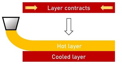

Warping in 3D printing is the deformation that occurs when printed material lifts, curls, or peels away from the build surface as layers cool and contract. Warping manifests as raised corners on rectangular parts, curved edges on long prints, or entire sections detaching from the bed during printing. The deformations distort the intended geometry and lead to layer separation, poor surface alignment, and weakened structural integrity.
Warping occurs because the thermoplastic filament shrinks as it cools, and uneven temperature distribution creates internal stress that pulls the part upward. Prints produced through material extrusion–based 3D printing processes are susceptible to warping because non-uniform cooling between layers creates residual thermal stress that accumulates throughout the build. The effect becomes more visible on large, flat models such as trays, enclosures, and panels where contraction forces accumulate across wide surface areas.
Why Does Warping Occur in 3D Printing?
Warping occurs in 3D printing because thermal contraction, uneven cooling, and inadequate bed adhesion combine to create upward lifting forces. Thermoplastics shrink as they transition from the molten to solid state, and when cooling occurs faster at the edges than at the center, differential thermal contraction causes stress to concentrate along corners and perimeters. Poor bed adhesion allows residual thermal stress to exceed interfacial bonding strength, resulting in lifting or curling instead of remaining anchored to the build plate.

  • Thermal contraction: Thermoplastic filaments contract as they transition from the molten to solid state due to thermal shrinkage. The thermal contraction creates internal stress throughout the print, especially at layer interfaces and the base, where the part remains attached to the build surface. Corners lift, and edges deform when contraction forces exceed adhesion strength. The effect becomes more pronounced on larger prints with greater surface area and longer cooling paths.
  • Uneven cooling: Uneven cooling occurs when airflow, fan speed, or ambient temperature differs across the print. Drafts from open rooms, excessive part cooling fans, or inconsistent bed heating cause some areas to cool faster than others. The temperature gradients generate localized shrinkage that pulls edges upward while interior sections remain anchored, resulting in curling or peeling.
