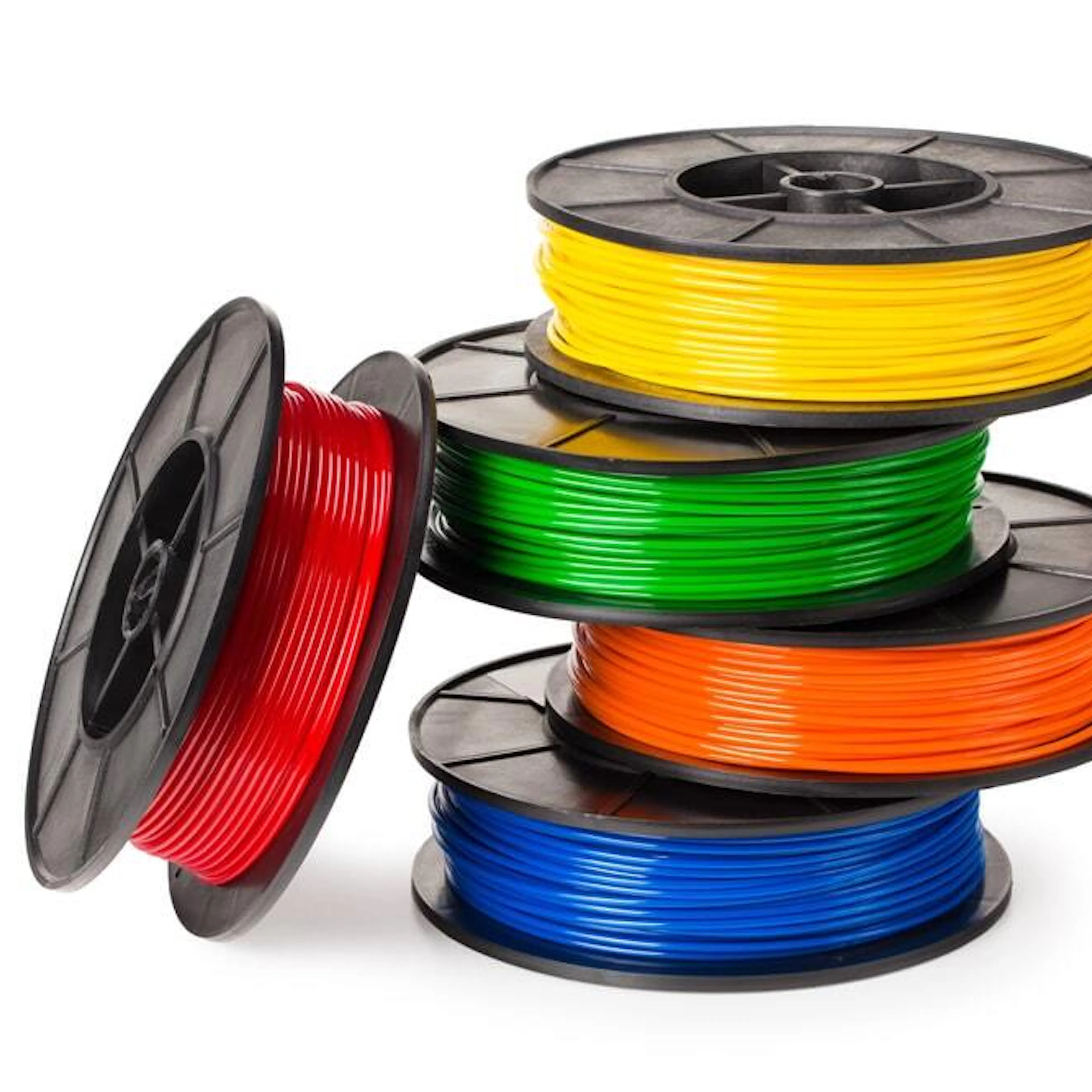

If you’ve ever wondered about ABS 3D printing filament, this article will guide you through what it is and how to use it.
Multi-colored filaments for 3D printing. Image Credit: Shutterstock.com/Eywa
