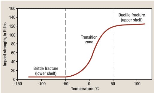

What Is the Temperature for A Charpy Impact Test?
The temperature for Charpy impact testing is 23 °C. However, these tests are performed at many temperature ranges to plot the materials' ductile-to-brittle transition temperature.

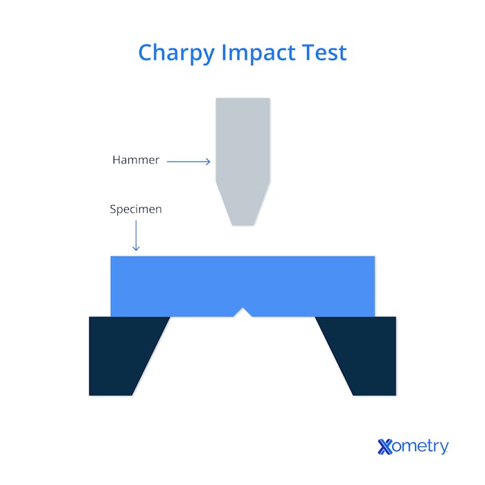

Charpy Impact Test Diagram: How Is It Represented?
The Charpy impact test diagram is presented by the following steps listed below.
  1. Present the Charpy Impact Test Diagram layout. A Charpy impact test diagram shows a rigid support frame with a pendulum mounted at a fixed height above the specimen. The design illustrates how gravitational potential energy converts into impact energy at the strike point.
  2. Show the arrangement in a Charpy Test Diagram. The Charpy test diagram displays the test specimen resting horizontally on two anvils with a defined span between supports. The notch faces toward the pendulum, so the fracture initiates at the highest stress concentration during impact.
  3. Depict the operation of a Charpy impact tester. The Charpy impact tester illustration traces the pendulum arc from release to specimen contact. The difference between the initial and rebound height represents the energy absorbed during fracture.
  4. Illustrate the energy measurement stage. The final diagram stage shows a mechanical scale or digital display connected to the pendulum axis. The measured energy loss directly represents the material’s impact toughness under sudden loading.

3. Temperature
Temperature alters material behavior by shifting the balance between brittle and ductile responses during impact loading. The Charpy impact tests are typically performed at 23 °C. However, higher and lower temperatures are used to plot a curve representing a material’s ductile-to-brittle transition behavior. Higher temperatures increase impact strength.
