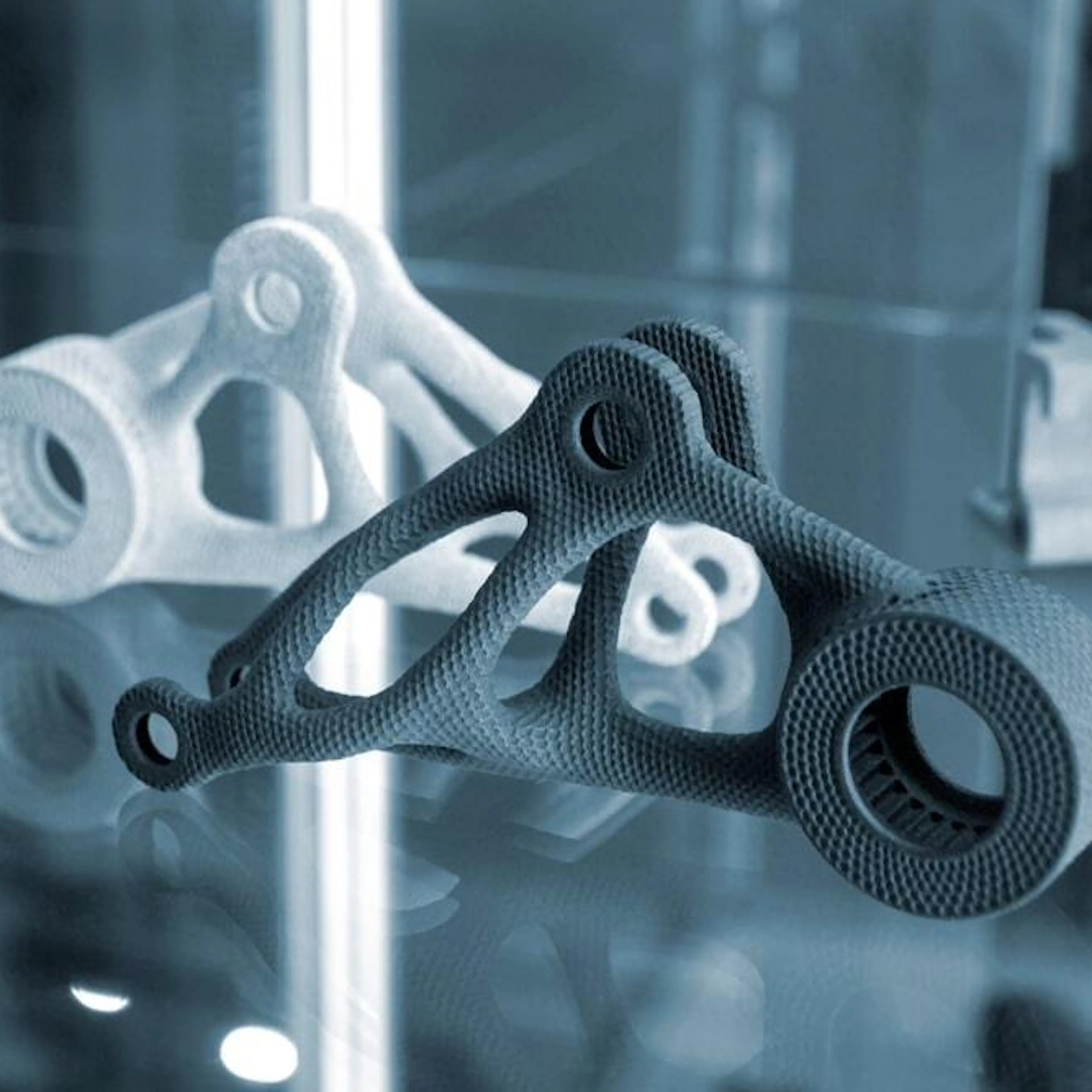

It works by applying a fusing and detailing agent to a thin layer of powder that’s been placed in the shape of the part’s cross-section at a pre-set height. The fusing agent is good for absorbing heat and the detailing agent helps the edges be crisper and sharper, as well as prevents the molten plastic from bleeding past the edges of the part. An infrared heat source then bonds the powder into the final part by sintering the particles together wherever the fusing agent is applied, which is followed by the print bed moving down by the thickness of one layer (usually around 80 microns), and the process repeats itself. The following image shows a part made using this process:
MJF part
MJF part

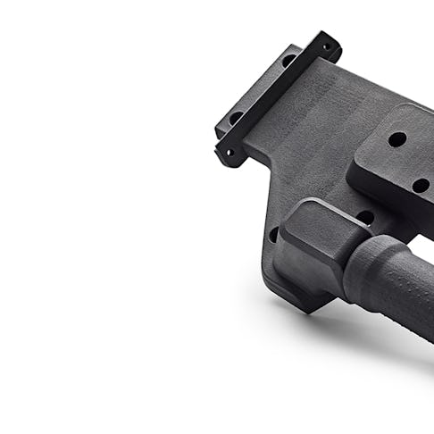

The image below shows a polypropylene part we made at Xometry using MJF:
MJF polypropylene part
