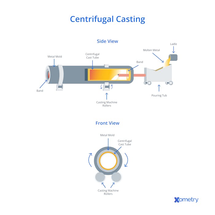

Centrifugal casting is a manufacturing process used to create cylindrical components with a central axis of rotation. This technique involves rotating a mold around a central axis at speeds typically ranging from 300 to 3000 rpm while pouring molten material into the mold. The centrifugal force generated by the rotation spreads the molten material against the inner surface of the mold, resulting in the desired shape of the finished product. This method is often employed for producing large pipes, cylinder liners, and hollow cylindrical components cast from a variety of materials, including metals, concrete, and glass. While centrifugal casting maintains tight dimensional tolerances on the outer surface, the inner diameter is typically cast slightly undersized, allowing for subsequent machining to achieve the precise inner diameter required.
centrifugal casting diagram
Schematic of the centrifugal casting process

What Are the Steps in the Centrifugal Casting Process?
The process is further explained in the following list of steps:
1. Prepare the Mold
The inner surface of the mold is coated with refractory material, typically between 1-1.15 mm in thickness. In true centrifugal casting, this coating process involves preheating the mold and then applying the ceramic slurry while the mold is spinning. Following this application, the coated mold undergoes a drying and curing process, ensuring the refractory coating adheres securely to the mold surface. Cleaning the mold surface before applying the refractory coating remains a crucial step to remove any contaminants or debris that could affect the surface finish and integrity of the cast part.
2. Pour the Molten Metal Into the Mold
The casting metal is heated beyond its melting point and poured directly into the mold through a spout, without the need for a gating system.
3. Pour the Molten Metal Into the Mold
The mold is either rotated while the molten metal is being poured into it or is set into rotation after the pouring is completed. The rotation rate generally falls between 300 and 3000 rpm, depending on the project specifics.
4. Centrifugal Forces Distribute the Molten Metal
The centrifugal forces generated by the rotation of the mold cause the molten metal to be pushed toward the outer wall of the mold cavity.
5. Maintain Mold Rotation Until Molten Metal Solidifies
The mold continues to spin after pouring is finished, allowing the part to cool and solidify completely. The rotation helps maintain a uniform material distribution around the inner circumference of the mold.
6. Remove Solidified Casting From Mold
Once the casting is solid and the desired part hardness is achieved, the mold is removed and opened to extract the finalized solidified casting. The specifics of the process can vary based on the type of centrifugal casting being performed, such as true centrifugal casting or semi-centrifugal casting.

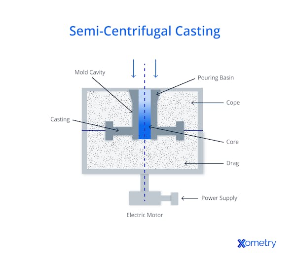

2. Semi-Centrifugal Casting
Semi-centrifugal casting is a technique that utilizes centrifugal force to create solid castings, as opposed to the tubular shapes produced by true centrifugal casting. In the illustrated example of the semi-centrifugal casting in Figure 2 below, the molds are configured with a riser located at the rotation axis to facilitate the flow of molten metal.
semi centrifugal casting diagram
Semi centrifugal casting diagram
A disposable or permanent mold is arranged around a central sprue, where molten metal is poured. This molten material then flows into a rotating mold under the influence of the centrifugal force induced by the rotation. Pouring is stopped once the mold and sprue have been filled. Rotation persists post-pouring. The ongoing rotation ensures that the parts of the casting furthest from the axis of rotation remain fully dense throughout the solidification phase. Once the castings have fully solidified, the equipment discontinues rotation, allowing for the extraction of the finished cast pieces.
This method is used to craft various components, including pulleys, spoked wheels, gear blanks, nozzles, and brass bushings. Parts made by semi-centrifugal casting display higher density in their outer regions than at the central axis. This process finds particular application in fabricating items such as spoked wheels, which exhibit rotational symmetry, thereby eliminating the need for a central casting region. This removal of the center section concurrently eliminates the lowest-density part of the cast.
