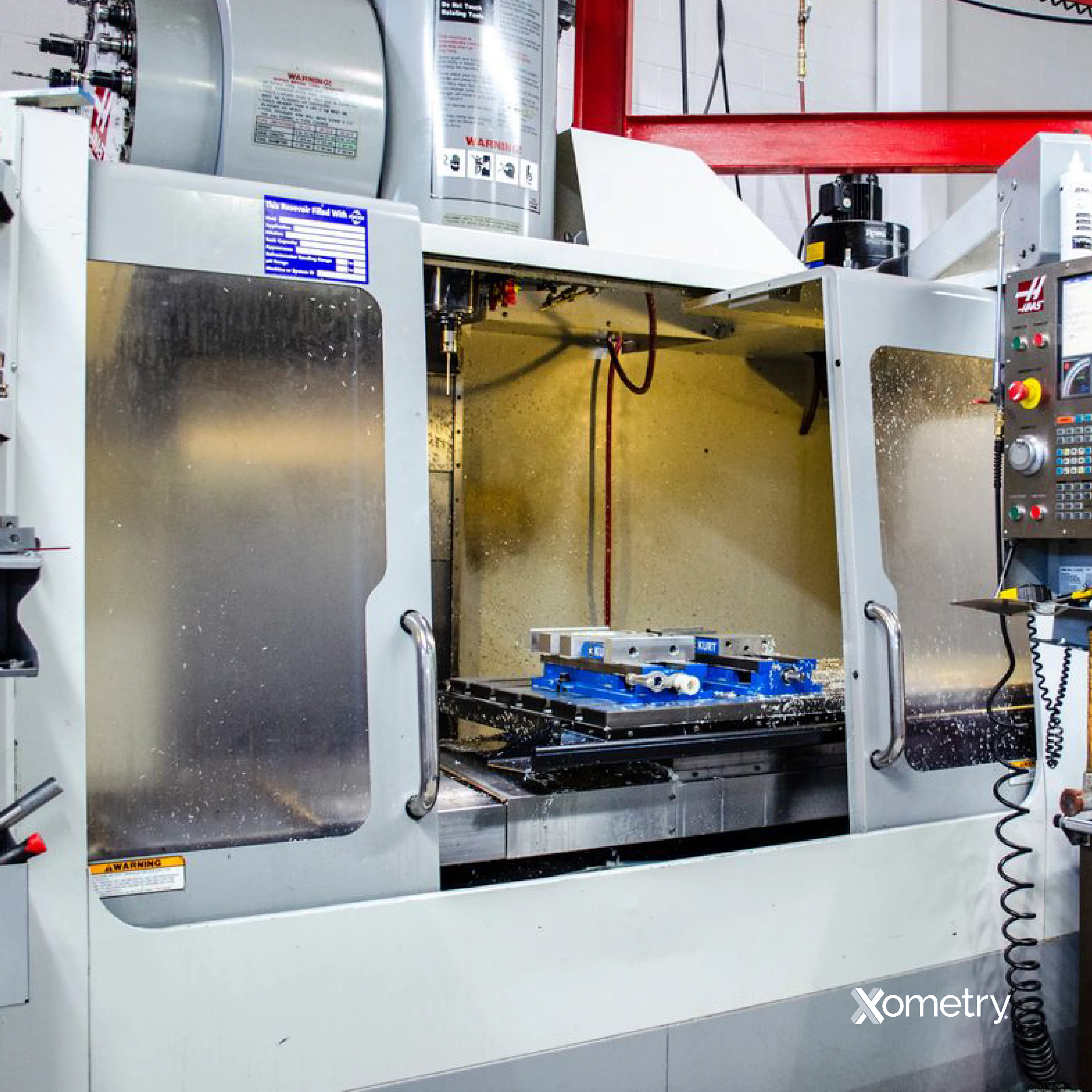

What Is a 3-Axis CNC?
A 3-axis CNC machine, such as a lathe, mill, or machine tool center, moves its tool (whether it’s a cutter, drill, or mill) along the X (left to right), Y (front to back), and Z (up and down) axes. More specifically, it can move either horizontally (X-Y axes) or vertically (Z axis) to control the cutting depth. This is what a 3-axis CNC machine looks like:
This type of machine can cut and plane to specific depths, depending on the tool used and the material being worked on. Its limited range of motion and the fact that it can’t automatically rotate the workpiece make it best for making simpler parts with straightforward shapes and designs and minimal details. These machines are best for making 2D and 2.5D parts and shorter production runs, and they’re reasonably priced, making them ideal for startups or small to medium-sized businesses.
To learn more, see our full article on Types of CNC Machines.
What Can a 3-Axis CNC Do?
A typical 3-axis CNC machine is capable of carrying out a variety of machining tasks, including: cutting, drilling, and milling. Others are designed as CNC lathes. However, in terms of part complexity, the constraint of those three axes means the machine has some distinct limitations. The best 3-axis machines are used to produce parts with straightforward geometries and minimal design or detail requirements. 2D and 2.5D parts are the best targets for 3-axis CNC machines.

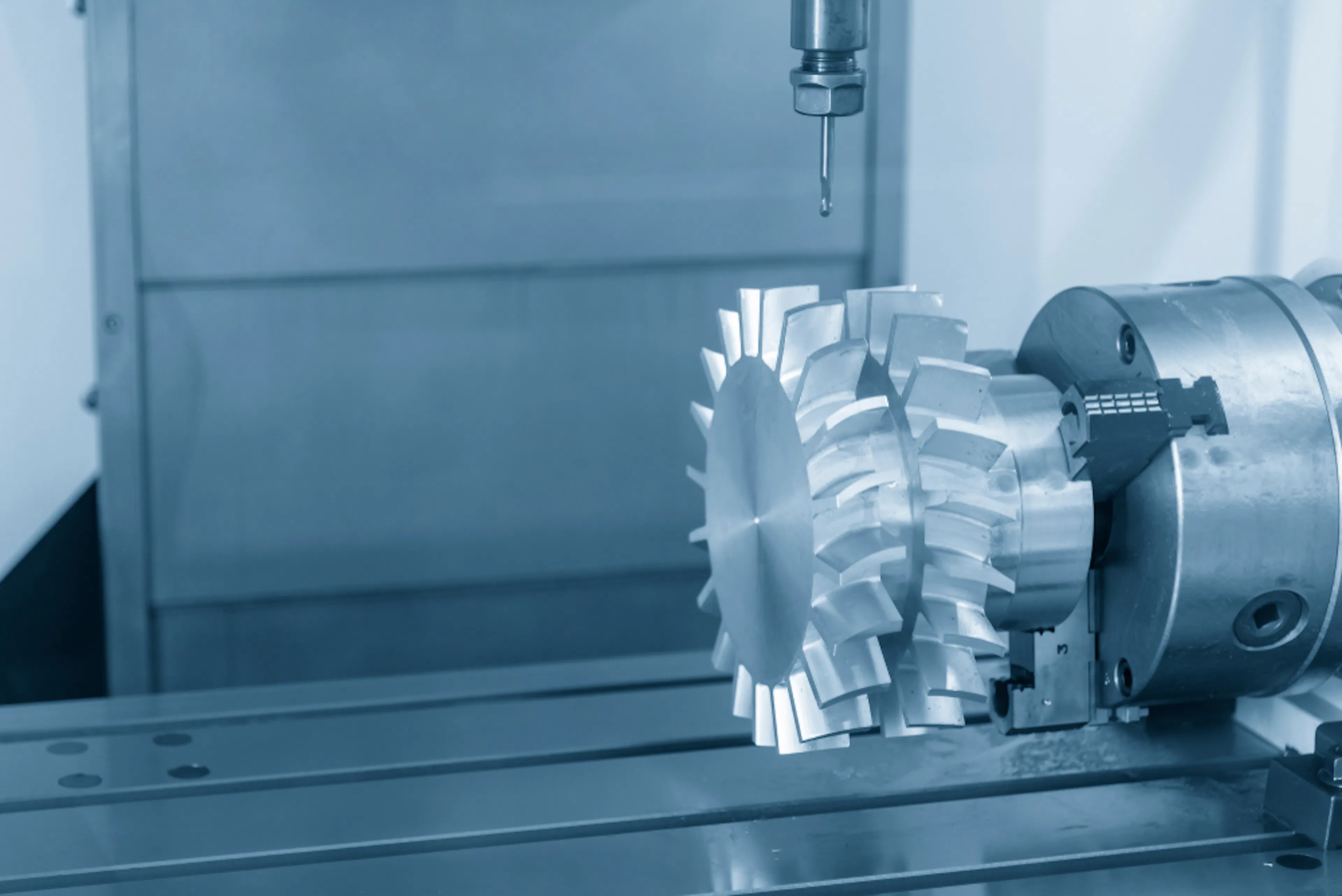

What Is a 5-Axis CNC?
As well as left–right, front–back, and up–down, a 5-axis CNC machine has two more movements up its sleeve: it can also rotate its tool around the other two axes (A and B). You can see how the process works in the diagram below.
Process Diagram for 5-Axis CNC Machining

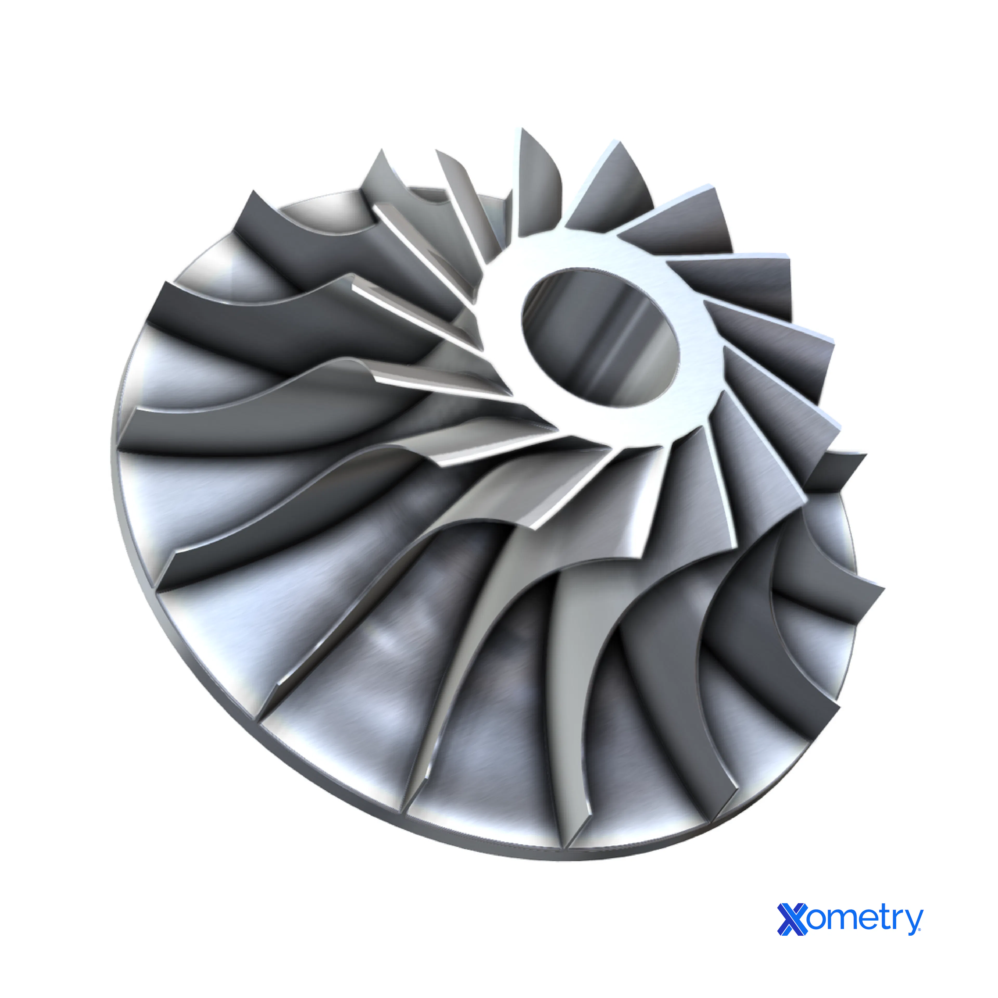

With a full five-axis range of motion, these machines can work at multiple angles to precisely make complex and intricate parts with smooth surfaces, angles, and contours. They can also perform continuous milling, which saves a lot of time, and don’t need any manual intervention as they rotate the workpiece automatically. These high-tech CNC and milling machines or routers can make turbine blades, molds, and impellers, such as the one in the below image.
5-axis impeller
5-axis impeller
What Can a 5-Axis CNC Do?
A 5-axis CNC can create geometries that demand multiple angles and contours. It can move the cutting tool along five axes, leading to smoother surfaces and more precise parts. A 5-axis CNC machine can also perform continuous milling, which enables the cutting tool to follow the material's curvature and produce fewer marks and steps.
A 5-axis CNC machine can be used to create parts such as: impellers, turbine blades, molds, and aerospace components. For instance, it is used in the aerospace industry to create intricate shapes for aircraft engine components. 5-axis capability is also important for medical implants and prosthetics.
