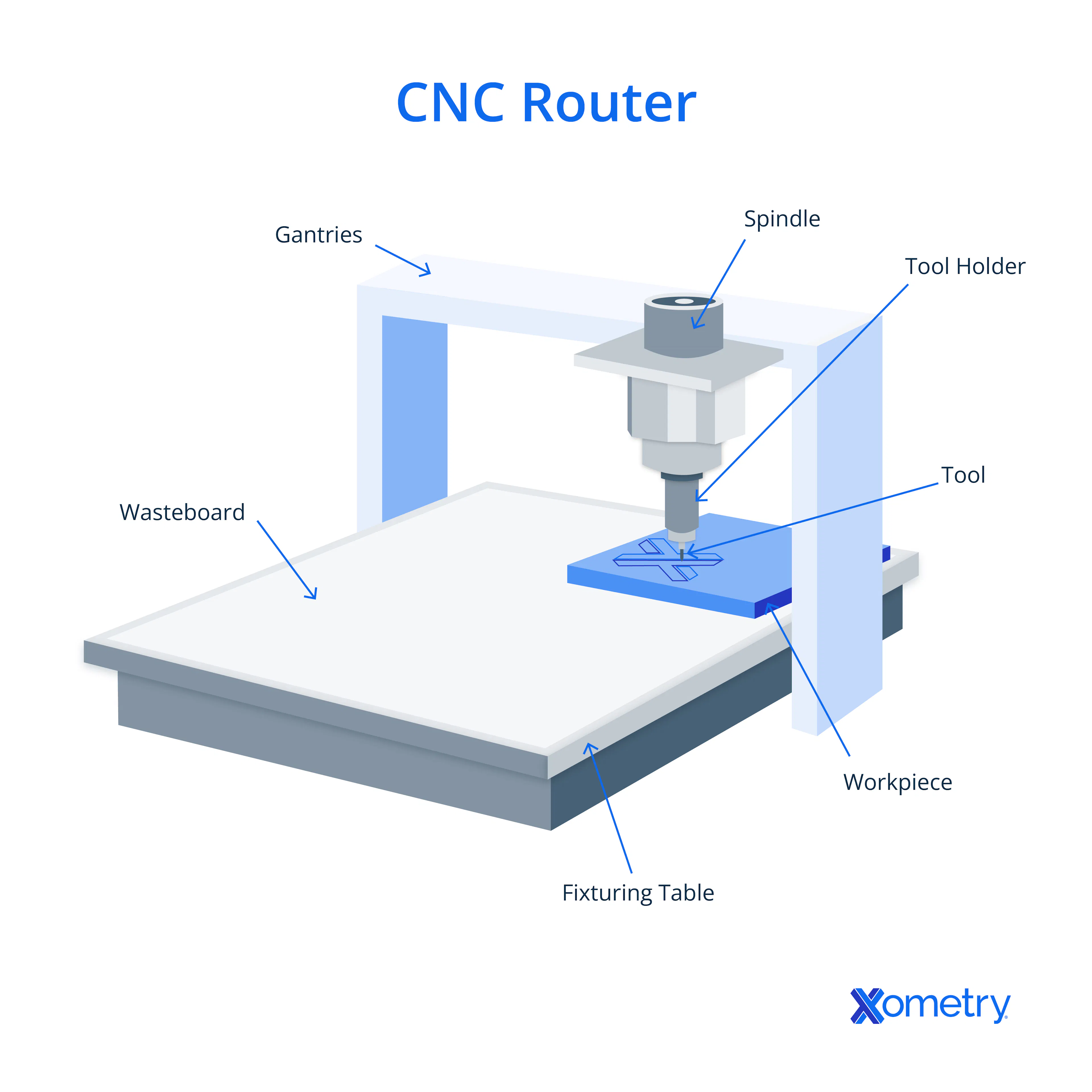

3. CNC Router
The CNC Router structure is shown in the table below.
The CNC Router is classified under the Cutting category, with 3, 4, and 5 axis configurations and a gantry machine structure. Its primary operations include cutting and routing, making it suitable for applications in woodworking, plastics, and soft metals. The router offers a precision level ranging from ±0.1 mm to ±0.25 mm, and it operates at spindle speeds between 6,000 and 24,000 RPM. Automation is rated from medium to high, enabling efficient production, while it is best suited for low- to medium-volume production.

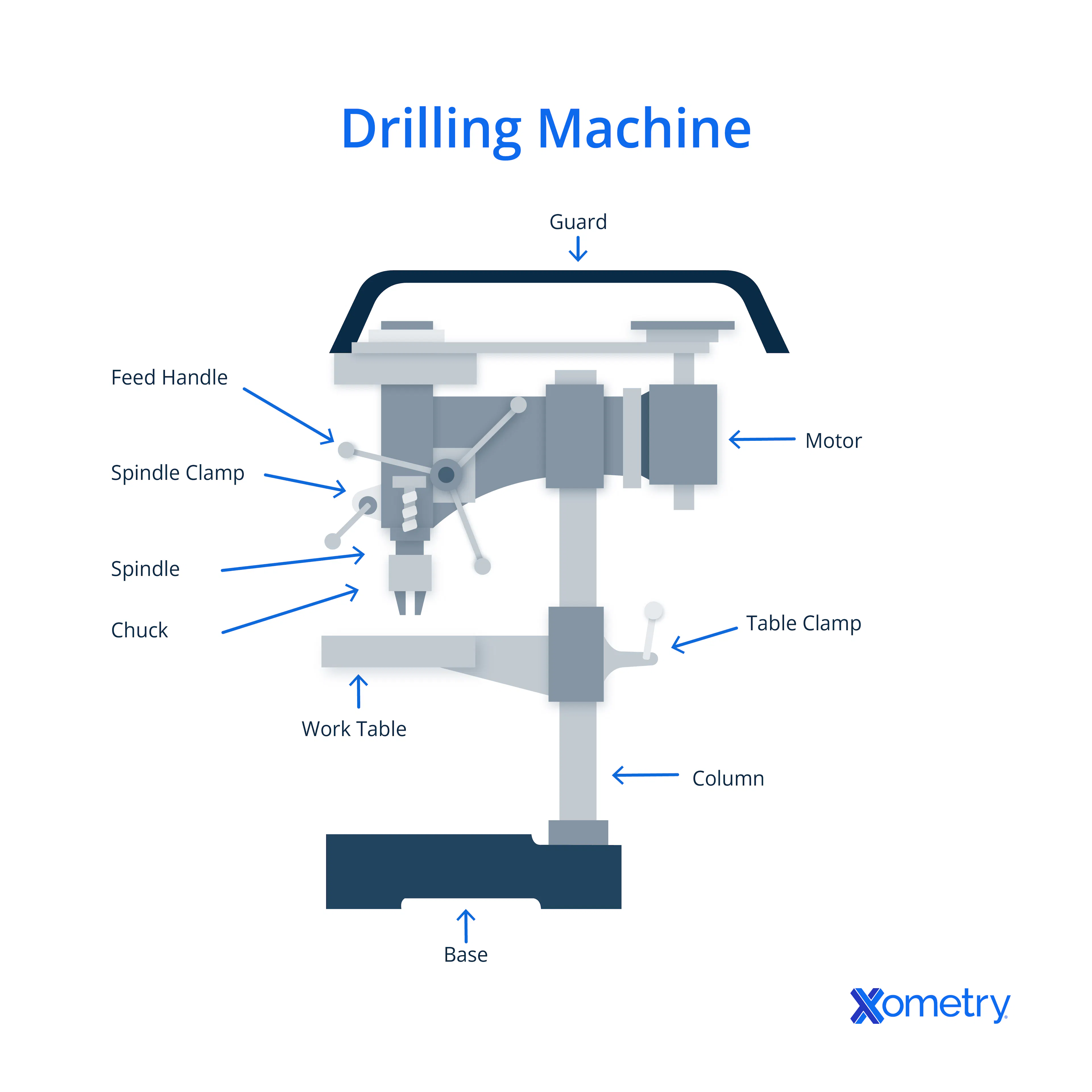

4. CNC Drilling Machine
The CNC drilling machine structure is shown in the table below.
The CNC Drilling Machine falls under the Drilling category, featuring 3-4 axis configurations and available in vertical and horizontal machine structures. Its primary operation focuses on drilling, with secondary operations that may include tapping, reaming, and boring. Commonly used in industries such as automotive, aerospace, electronics, and metalworking, it supports materials like metals (steel, aluminum, and titanium) and plastics. The machine offers a precision level of ±0.01 mm to ±0.05 mm, with spindle speeds ranging from 1,000 to 20,000 RPM, depending on the specific model and material. The automation level is medium to high, providing enhanced efficiency, and the machine is suitable for low- to high-volume production.
drilling machine diagram
Diagram of a drilling machine

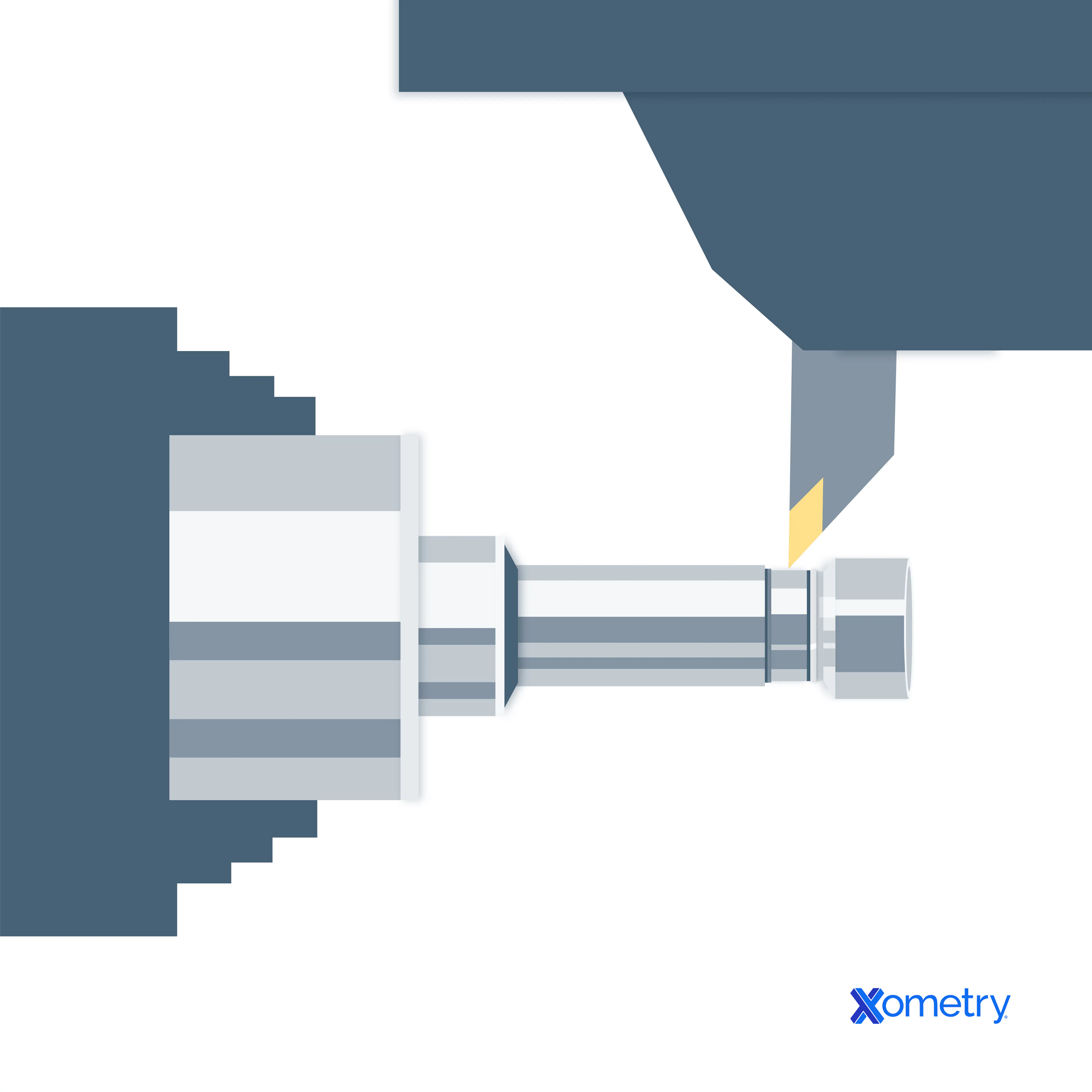

5. CNC Lathe Machine
Here is the table for the CNC Lathe Machine following the requested structure:
The CNC lathe machine falls under the turning category, with 3, 4, and 5 axis configurations and vertical or horizontal machine structures. Its primary operation focuses on turning and machining cylindrical parts, and it is commonly used in industries (aerospace, automotive, and metalworking). The machine offers a precision level ranging from ±0.01 mm to ±0.05 mm, with spindle speeds between 1,000 and 6,000 RPM. Automation levels are medium to high, improving efficiency for low- to high-volume production.

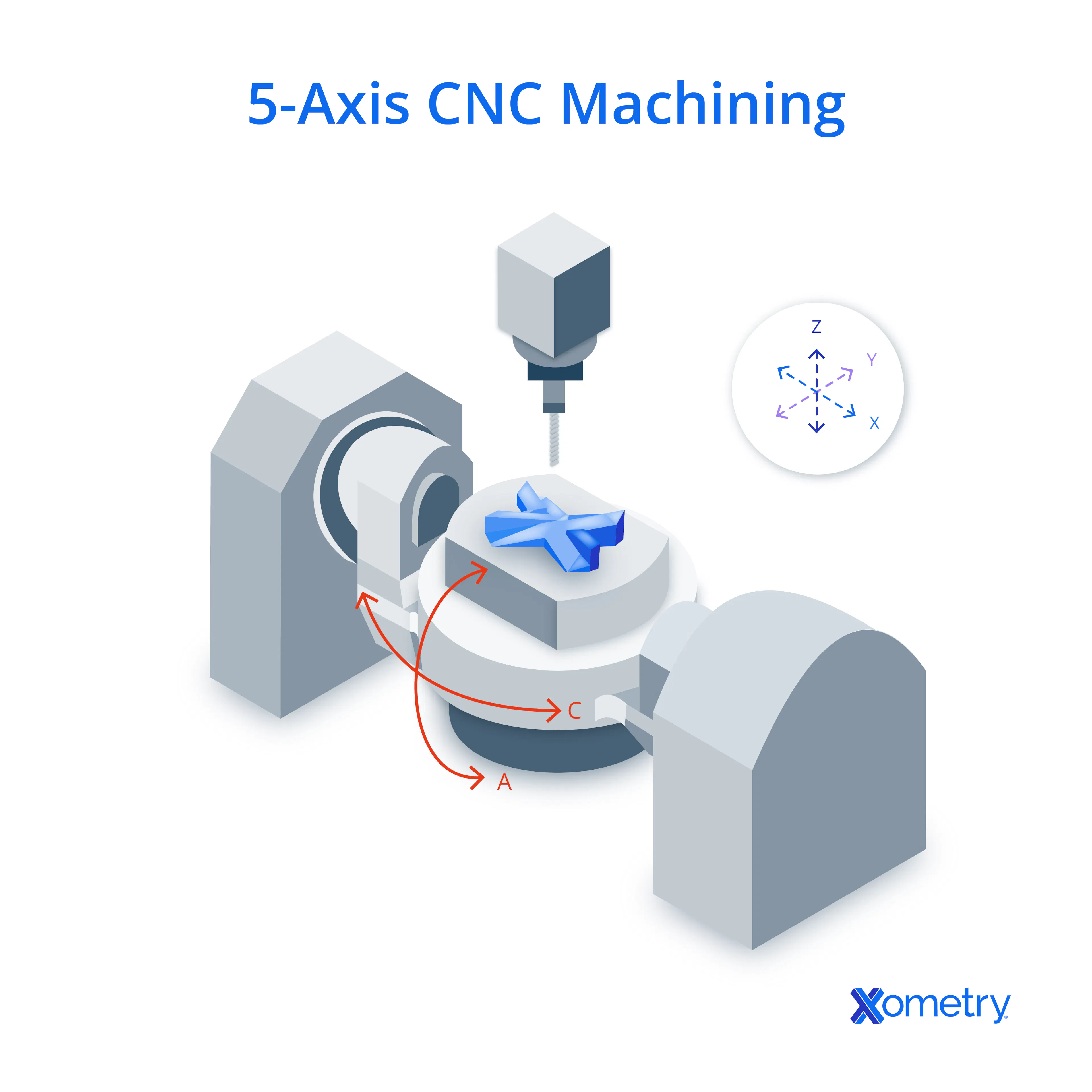

6. 5-Axis CNC Machine
The 5-Axis CNC Machine structure is shown in the table below.
The 5-Axis CNC Machine is classified under the Milling category, featuring 5-axis configurations and available in vertical, horizontal, or gantry machine structures. Its primary operations include complex milling, drilling, and turning, making it ideal for applications in aerospace, automotive, medical, and mold making. The machine offers a precision level of ±0.01 mm to ±0.03 mm, with spindle speeds ranging from 50–30,000 RPM. Automation is rated as high, and it is suitable for high-volume production and complex prototypes.

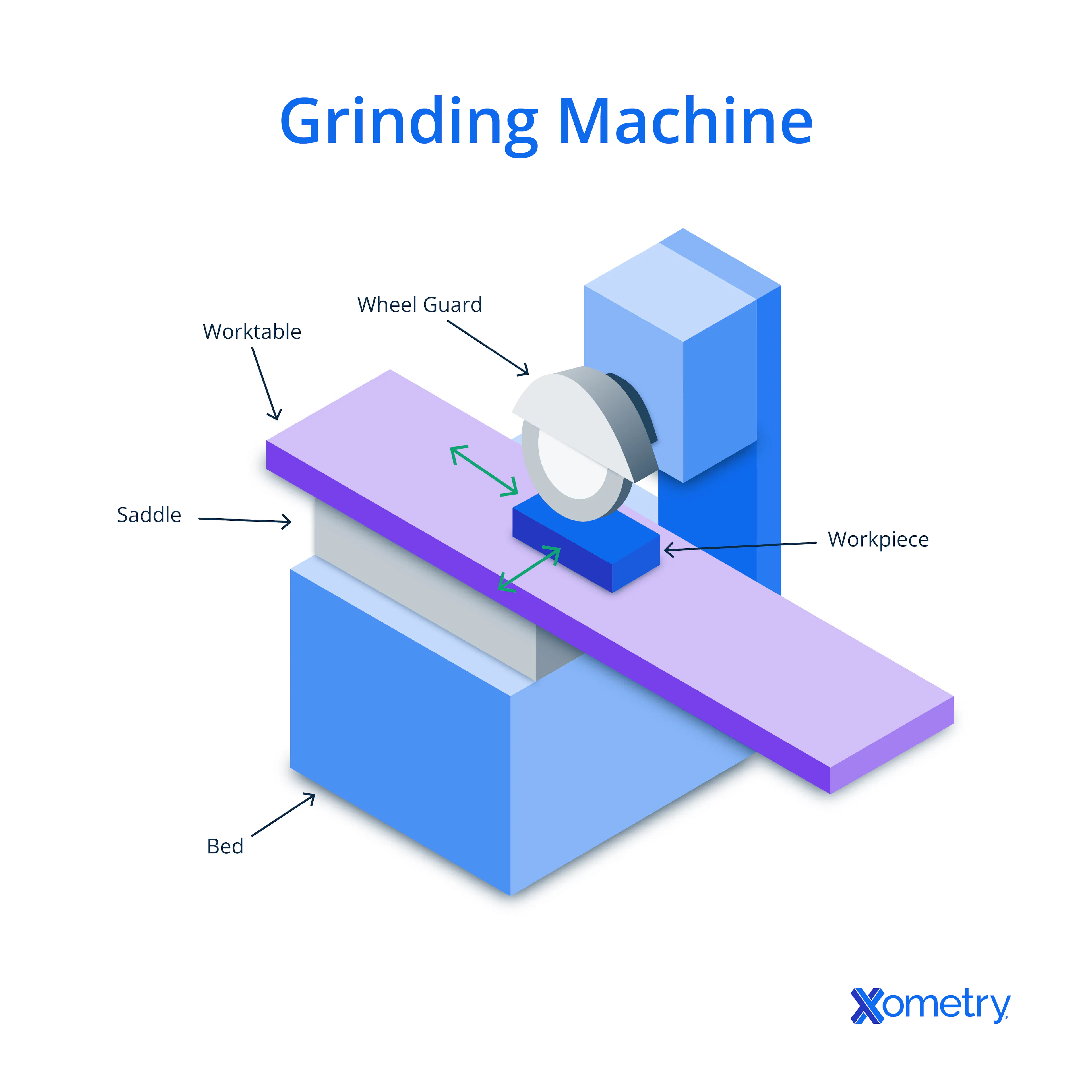

11. CNC Grinding Machine
The CNC grinding machine structure is shown in the table below.
The CNC Grinding Machine is categorized under Grinding, featuring 3, 4, and 5 axis configurations and Surface, Cylindrical, or Centerless machine structures. CNC Grinding machines’ primary operation is grinding, and it is widely used in industries (automotive, aerospace, and tooling). The machine offers a precision level ranging ±0.0005 mm to ±0.01 mm, with spindle speeds between 3,000 and 15,000 RPM. Automation is rated as medium to high, and it is suitable for low- to high-volume production.
