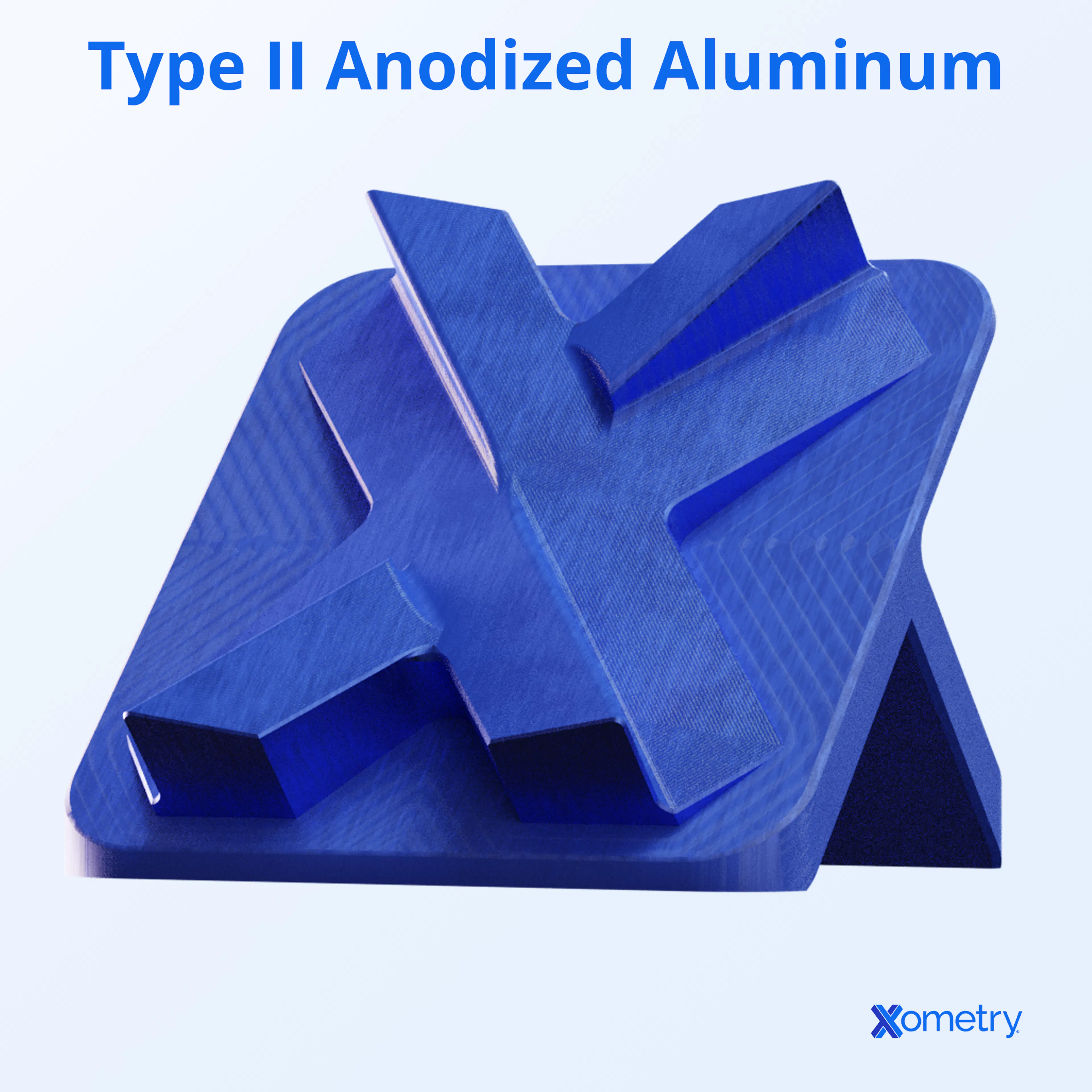

The image below shows a Xometry logo that has been anodized using the type II method:

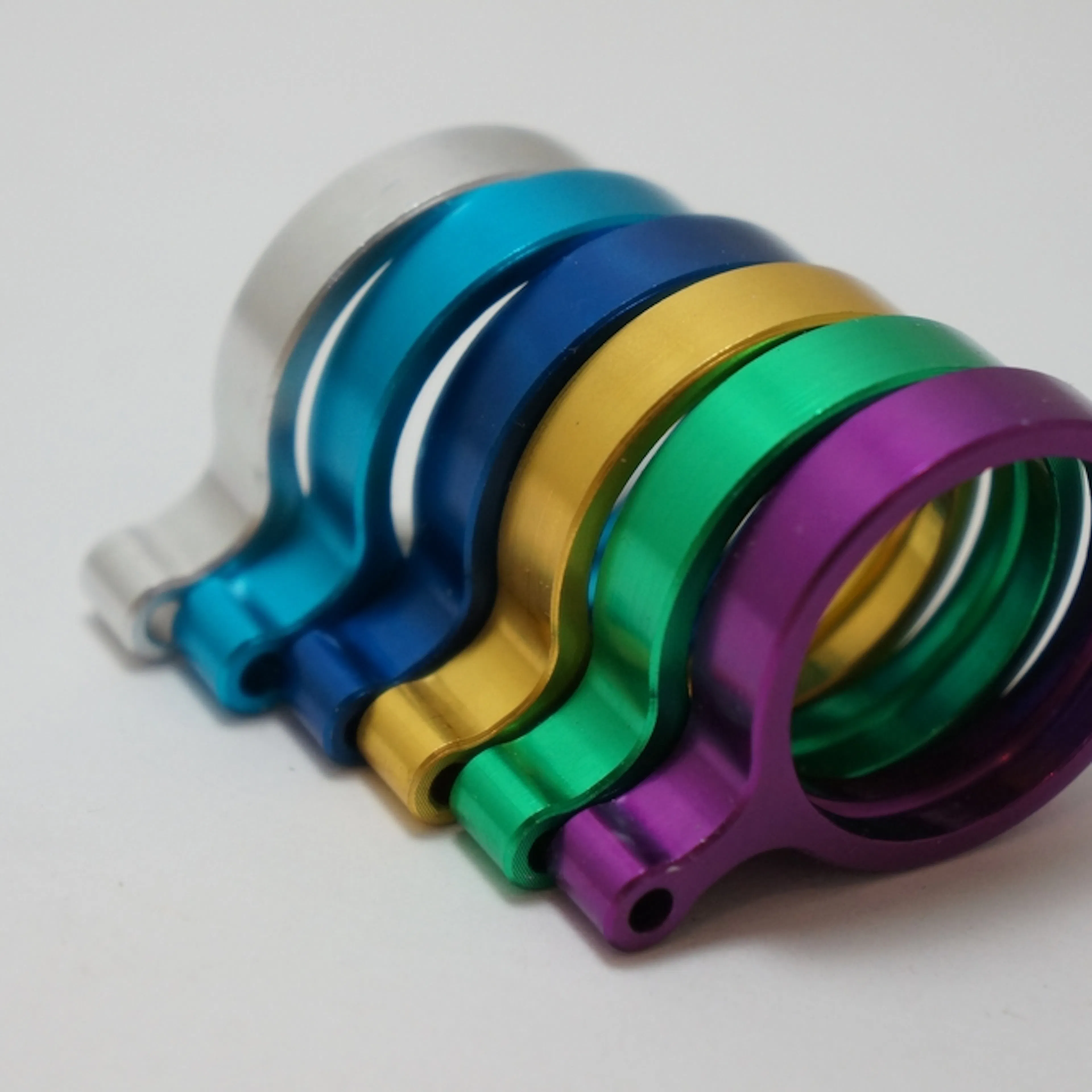

The range of colors that aluminum can be anodized include:
- Gold
- Bronze
- Blue
- Green
- Red
- Copper
- Black
- Silver
- Gray
- Bronze
