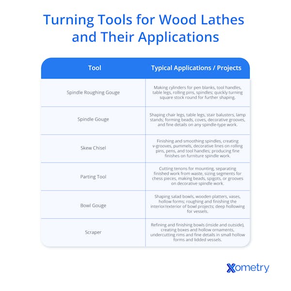

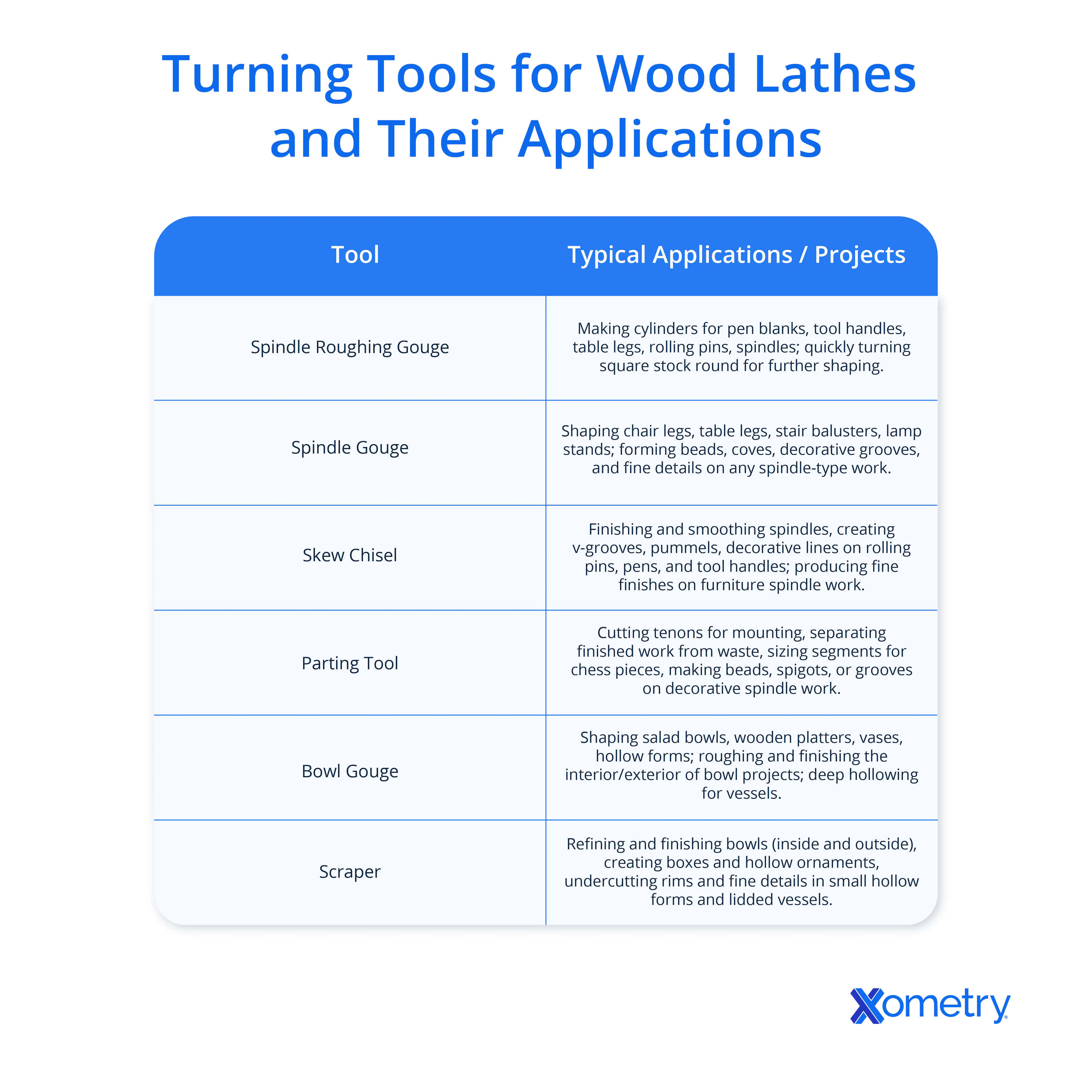

A table showing turning tools for wood lathes and their applications.
1. Spindle Roughing Gouge
A spindle roughing gouge is typically the first wood lathe turning tool used when starting a new project. For this particular tool, a wide U-shaped flute extends out from the grip. This tool allows users to quickly remove unwanted material and convert a square workpiece to a round one. By doing so, users can center their work on an axis running along the length of the workpiece. Spindle roughing gouges are often made from HSS (high-speed steel) and are available in different sizes, typically costing $20-$120.
2. Spindle Gouge
Spindle gouges (shallow fluted gouges) are wood lathe turning tools that have a noticeably smaller flute than roughing gouges. These tools are used to shape workpieces into desired shapes by creating features such as beads, coves, and ridges. The cutting edge of these tools is ground and beveled to obtain smooth surface finishes on workpieces. Spindle gouges come in a range of sizes, with typical prices from $10-$110.
3. Skew Chisel
Skew chisels have a flat blade and are used for “planing” or creating smooth surfaces on wooden workpieces. Additionally, the skew chisel is used to finely remove material to obtain desired thicknesses and make shallow curves, V-cuts, and pommels. This wood lathe turning tool is notorious for being difficult to handle and requires patience to use correctly.
It is recommended to keep the skew chisel’s bevel rubbing on the wood and present the cutting edge at a slight angle to the workpiece, while avoiding cutting with the corners. Using the corners can cause the workpiece to “catch,” which can be potentially dangerous. However, once familiar with the tool, the skew chisel is one of the most useful and versatile wood-turning tools. Skew chisels are available in different blade shapes and sizes, with typical prices from $10-$80 and premium versions up to $200.
4. Parting Tool
Parting tools are primarily used to cut narrow grooves, define diameters, and separate finished work from waste, though they can also add details such as fillets and spigots. Parting tools come in different sizes and styles, with prices typically ranging from $20-$100.
5. Bowl Gouge
Bowl gouges (deep-fluted gouges) are faceplate wood lathe turning tools that are ideal for shaping the interior and exterior curves of bowls and similar items. Bowl gouges have a long, deep-fluted blade (deeper than a spindle gouge). The tip of a bowl gouge is ground into different profiles, commonly a fingernail or swept-back grind, to suit various cutting styles. Bowl gouges are made in different sizes and shapes for specific applications, generally costing $20-$120.
6. Scraper
Scrapers are used for refining shapes and smoothing surfaces, though they do not cut as cleanly as gouges and can leave a less polished surface if not used carefully. There are several types of scrapers, including square-nose, round-nose, and specialized forms such as diamond-point or spear-point. Square-nose scrapers are used for finishing the outside of a bowl, while round-nose scrapers are used for finishing the inside of a bowl. While these are the two main types, there are other types for different applications. Scapers are useful because they can often reach areas that other wood-turning tools can’t reach. Scrapers typically cost between $15-$130.

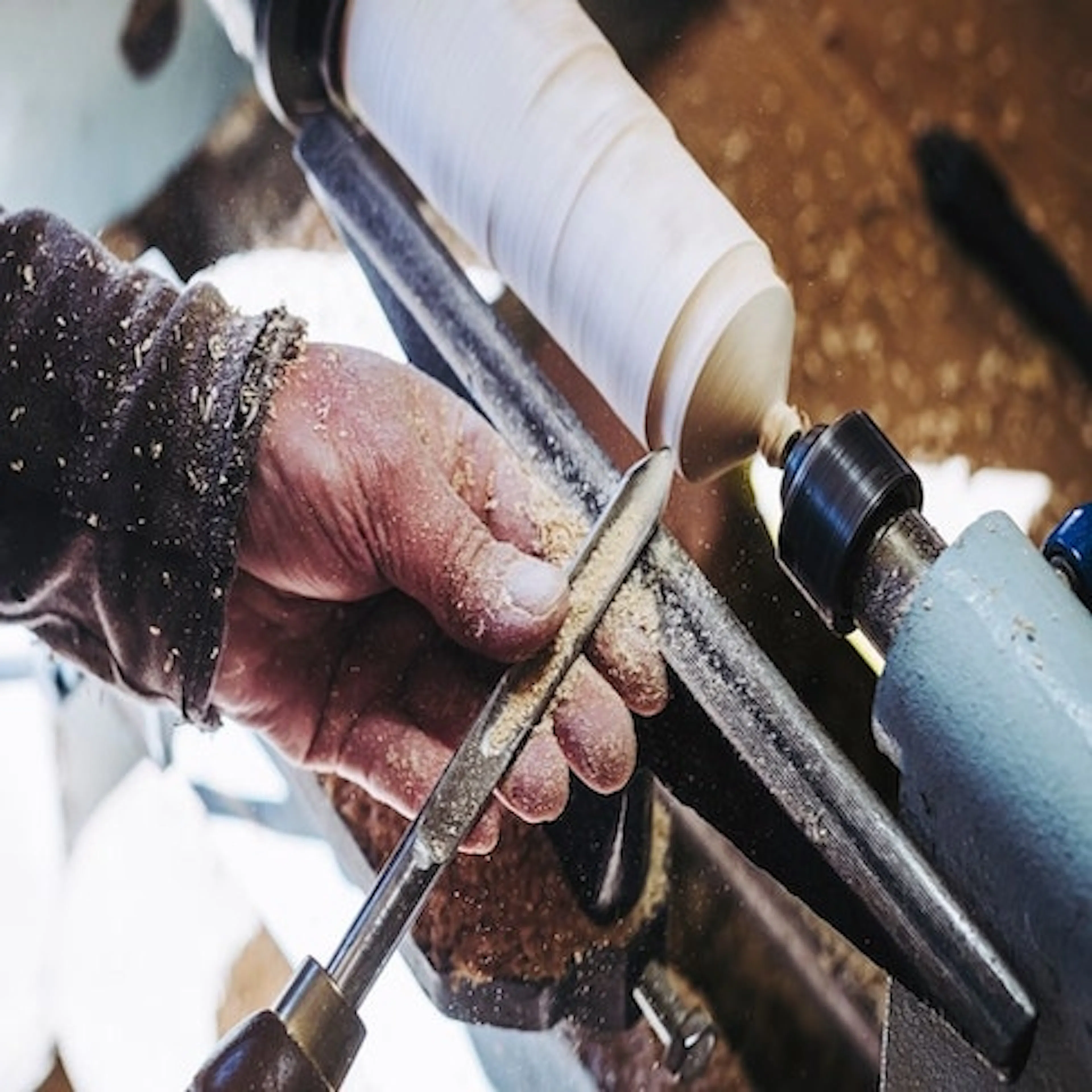

How to Use a Wood Turning Tool
Different wood lathe turning tools have various uses and therefore require different techniques and grips. The list below shows the steps on how to use a wood-turning tool:
  1. Position your hands so there is no way they can contact the workpiece. Use your dominant hand to guide the handle of the tool and your other hand to steady the blade on the tool rest. Maintain tool presentation so the cutting edge meets the wood at a controlled angle, with the bevel supporting the cut.
  2. Ensure the turning tool is always contacting the tool rest. Minimize the distance between the rest and the workpiece to about ¼ inch.
  3. Ensure the bevel of the cutting tool is rubbing on the wood just behind the cutting edge during the cut. This will help prevent removing too much material at once and also help prevent the tool from “catching” the workpiece.
  4. Cut with the grain, not against it. For faceplate work such as bowls, cuts usually start from the rim toward the center, following the grain. For spindle work, cuts typically follow the grain direction, from larger diameters toward smaller ones. Cutting against the grain, sometimes called cutting “uphill,” makes it much harder to control the tool.
