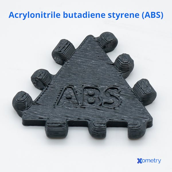

ABS plastic manufactured by Xometry

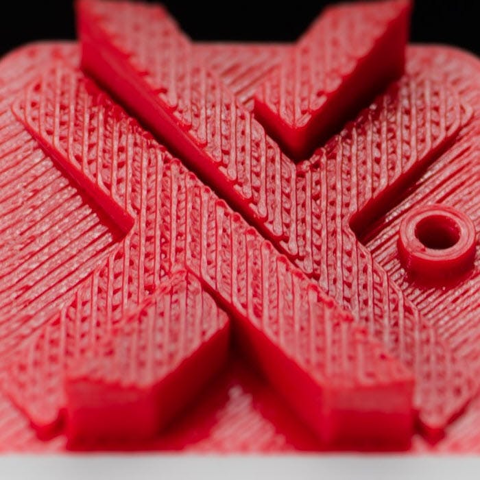

A sample of Xometrys ABS material.
A Xometry sample part made with ABS plastic
