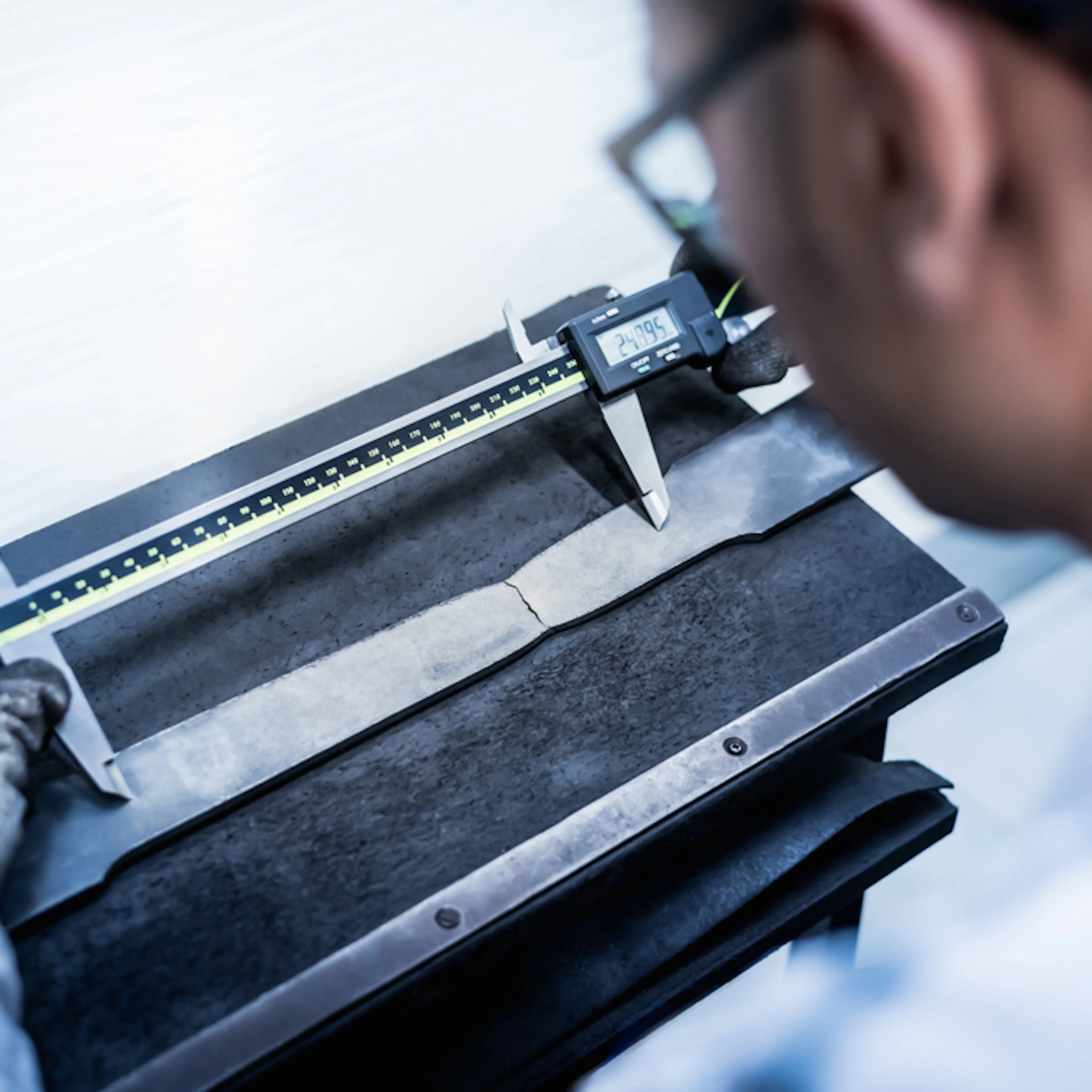

  1. First, measure the original length of your material before you start testing it
  2. Using one of the standard methods out there, complete a tensile test
  3. When the material gets to its breaking point (or fracturing fracture), take the measurements for the final length
  4. With those measurements you can fill out your equation to get the exact percentage

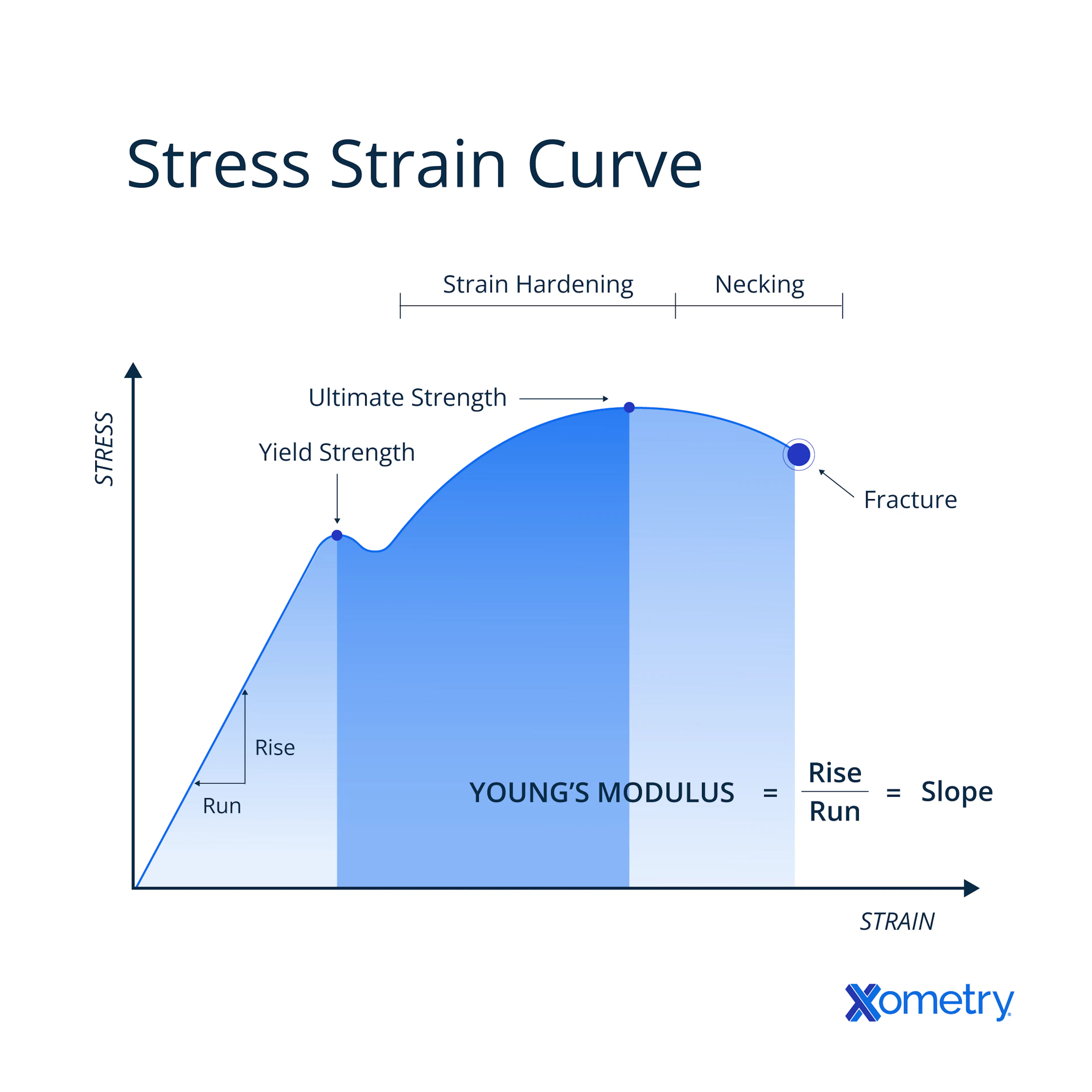

The image below is a visual representation of the stress strain curve and how elongation at break would be deciphered on a graph:
Stress strain curve
Stress strain curve
