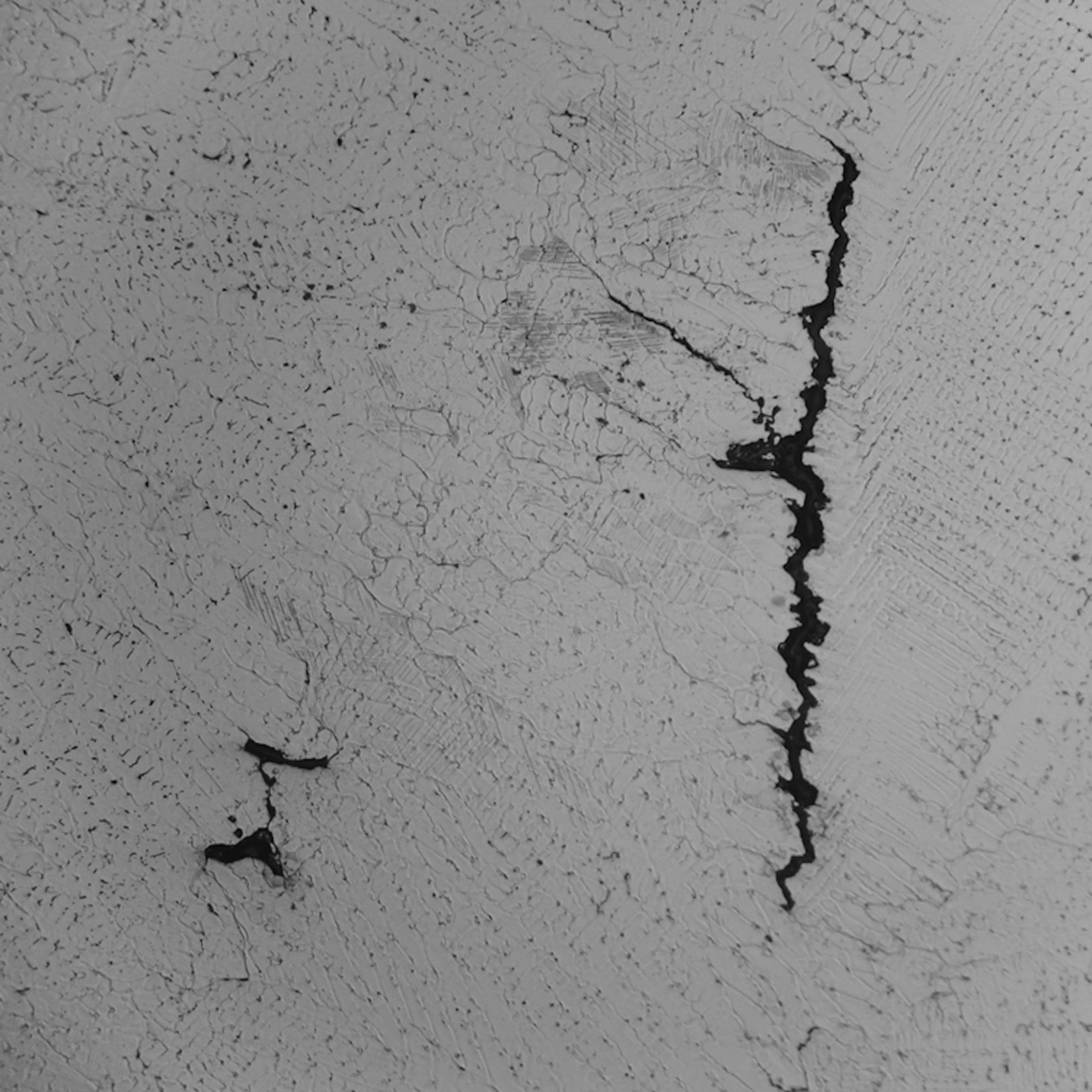

Ferritic stainless steel micrograph. Image Credit: Shutterstock.com/High Simple
