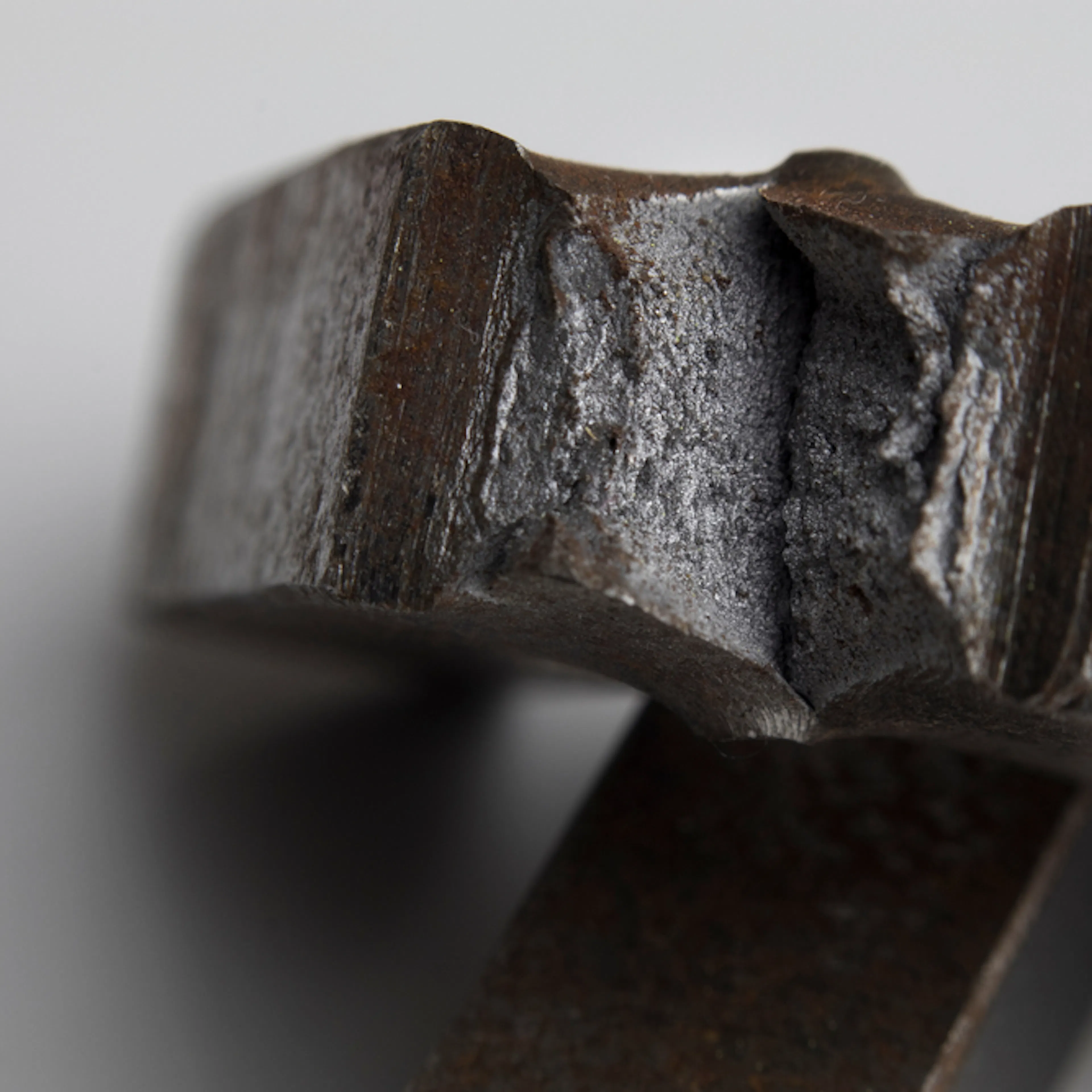

Ductile material impact test fracture. Image Credit: Shutterstock.com/bartu
