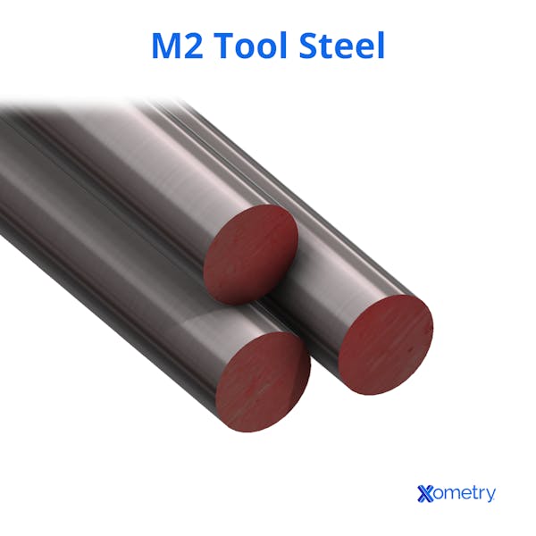

The properties of tool steel are engineered for mechanical durability by combining hardness with dimensional stability and controlled levels of toughness. M2 maintains its hardness during continuous operation where frictional heat is intense, whereas carbon steel softens under similar conditions and loses cutting capability. The M2 steel is less tough than some medium-carbon steels, but its wear resistance and hot strength are greater than what plain carbon steel achieve. The machinability of M2 differs, since the hardened material is harder to grind and machine, but it lasts much longer once processed. Each performance factor makes M2 Tool Steel a superior choice for drills, taps, end mills, and form tools where high cutting strength, heat resistance, and durability are required.
An illustration of M2 tool steel rods
