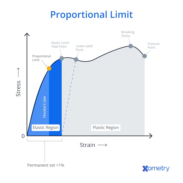

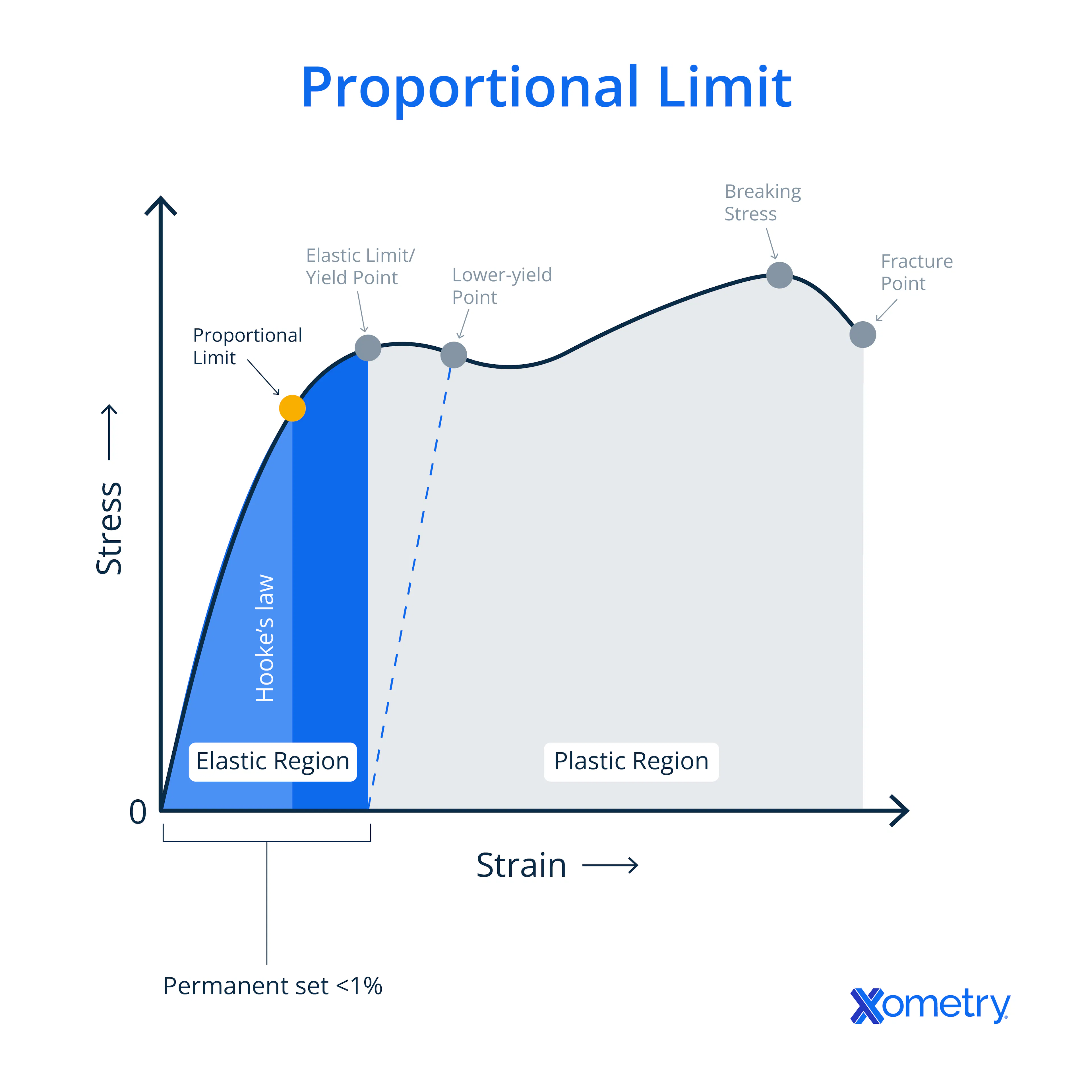

The stress-strain relationship describes how a material responds to applied forces, specifically in terms of the resulting stress (force per unit area) and strain (deformation per unit length). A stress-strain curve, which plots stress on the y-axis and strain on the x-axis, is used to represent it graphically. The proportional limit is an important location on this stress-strain curve. It represents the maximum stress that a material can experience and still maintain a linear relationship between stress and strain, in accordance with Hooke’s law.
A graph illustrating proportional limit.
Below the proportional limit, the stress-strain curve forms a linear relationship, indicating purely elastic deformation. Beyond this limit, the stress-strain relationship becomes nonlinear, though the material may still deform elastically until it reaches the elastic limit. To determine the proportional limit on a stress-strain graph, you calculate the slope of the linear portion of the curve, dividing stress by strain. The point where this slope starts deviating from linearity corresponds to the proportional limit.
