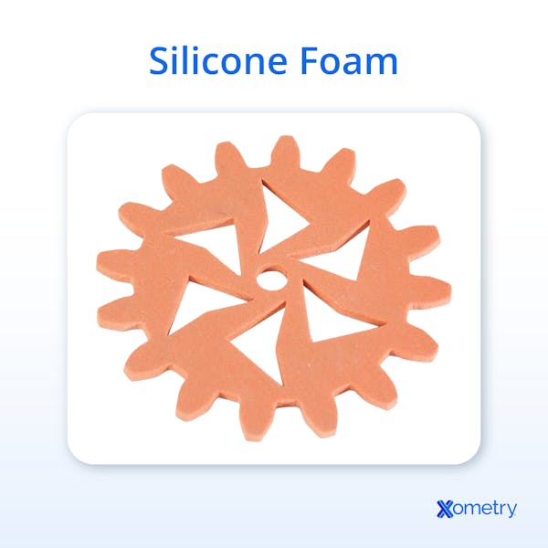

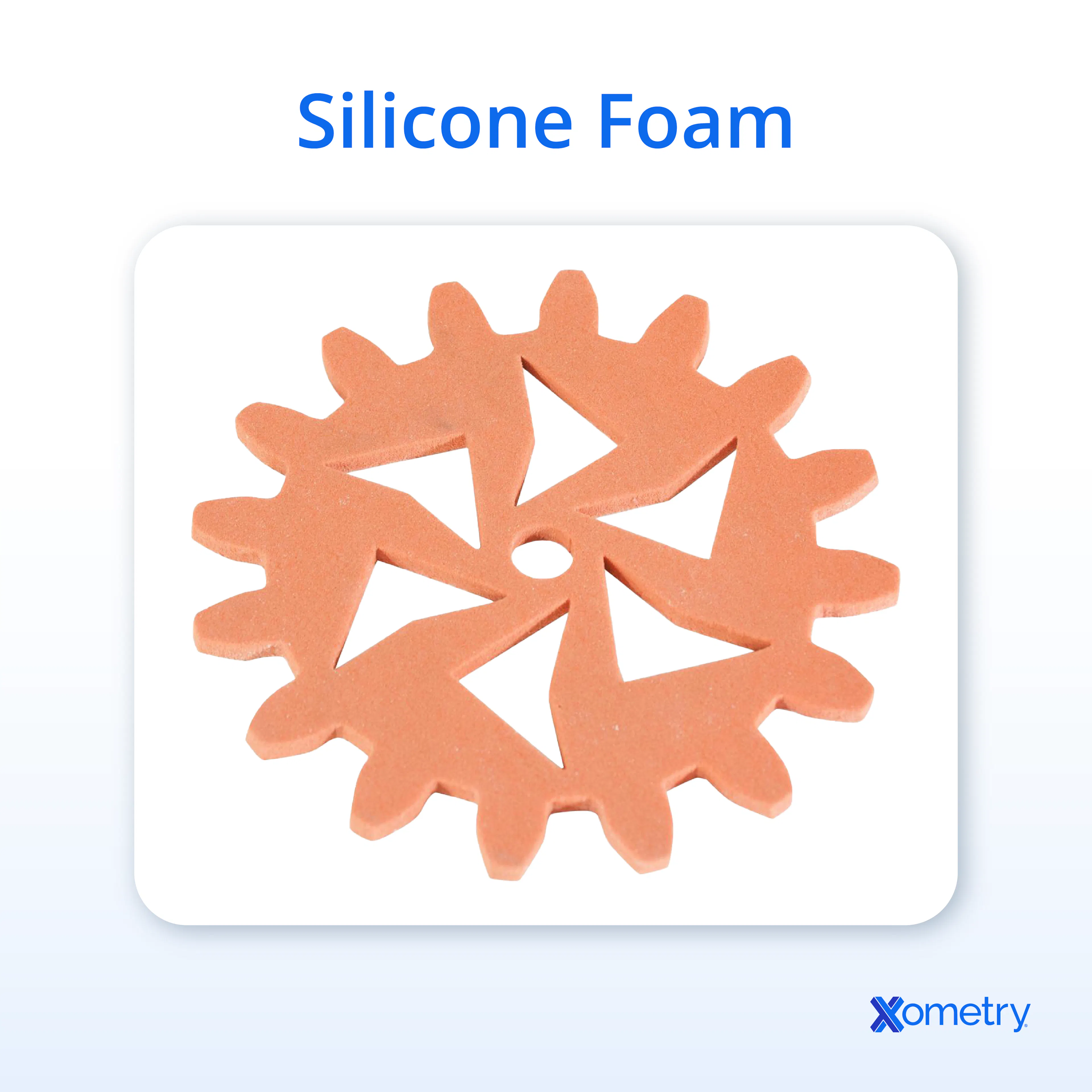

A photograph of silicone foam.

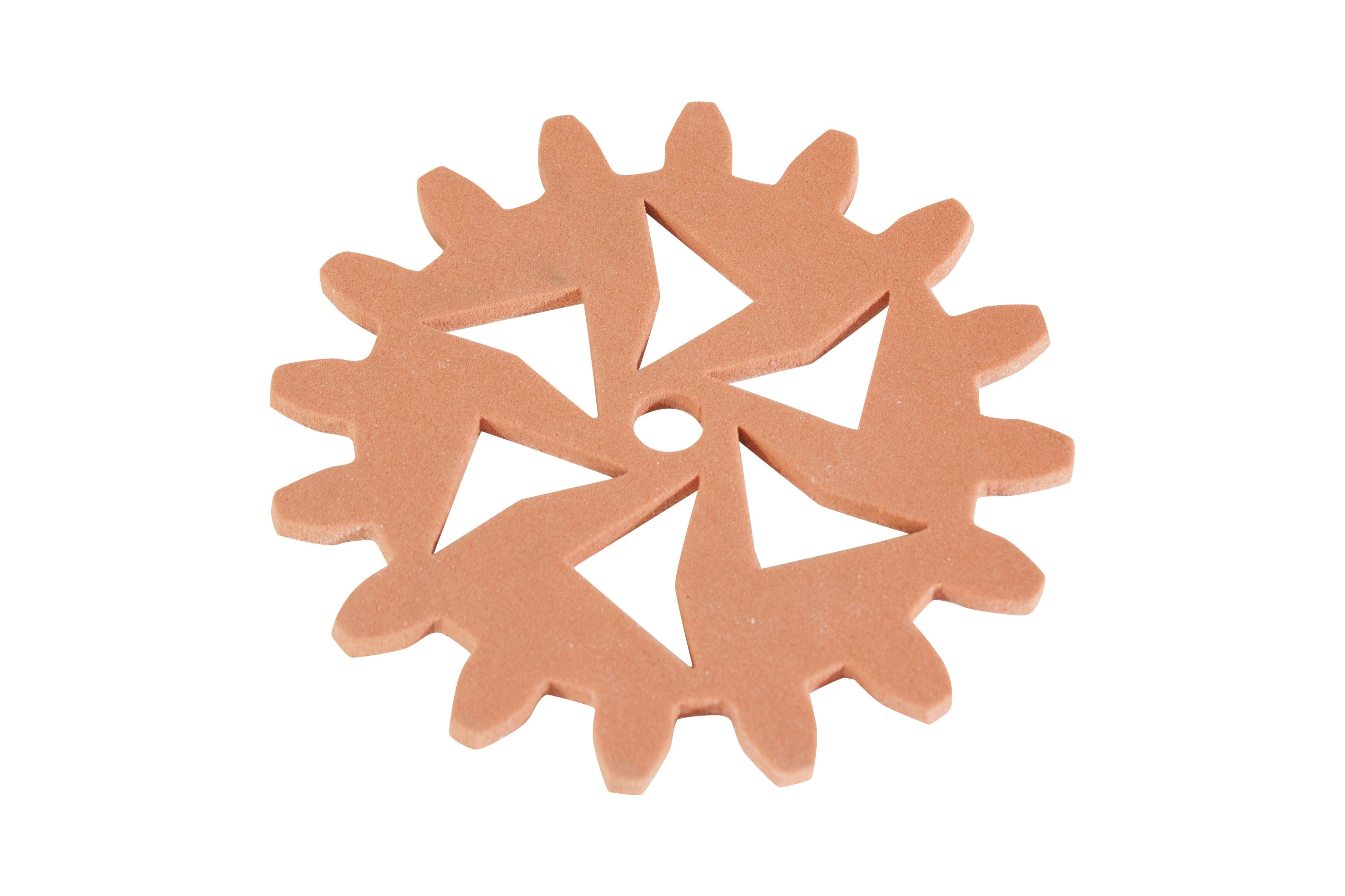

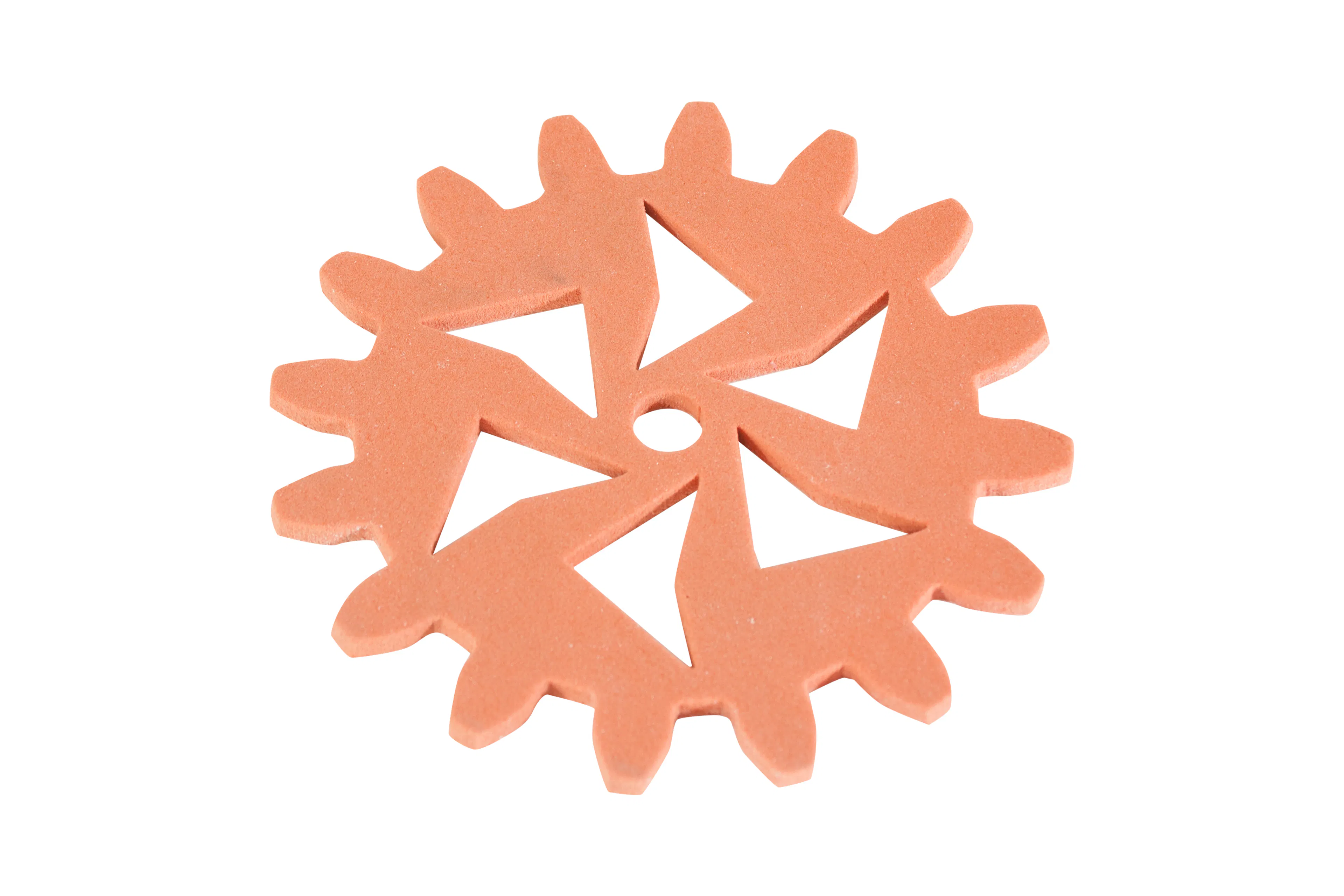

Silicone foam part
Silicone foam laser cut part
