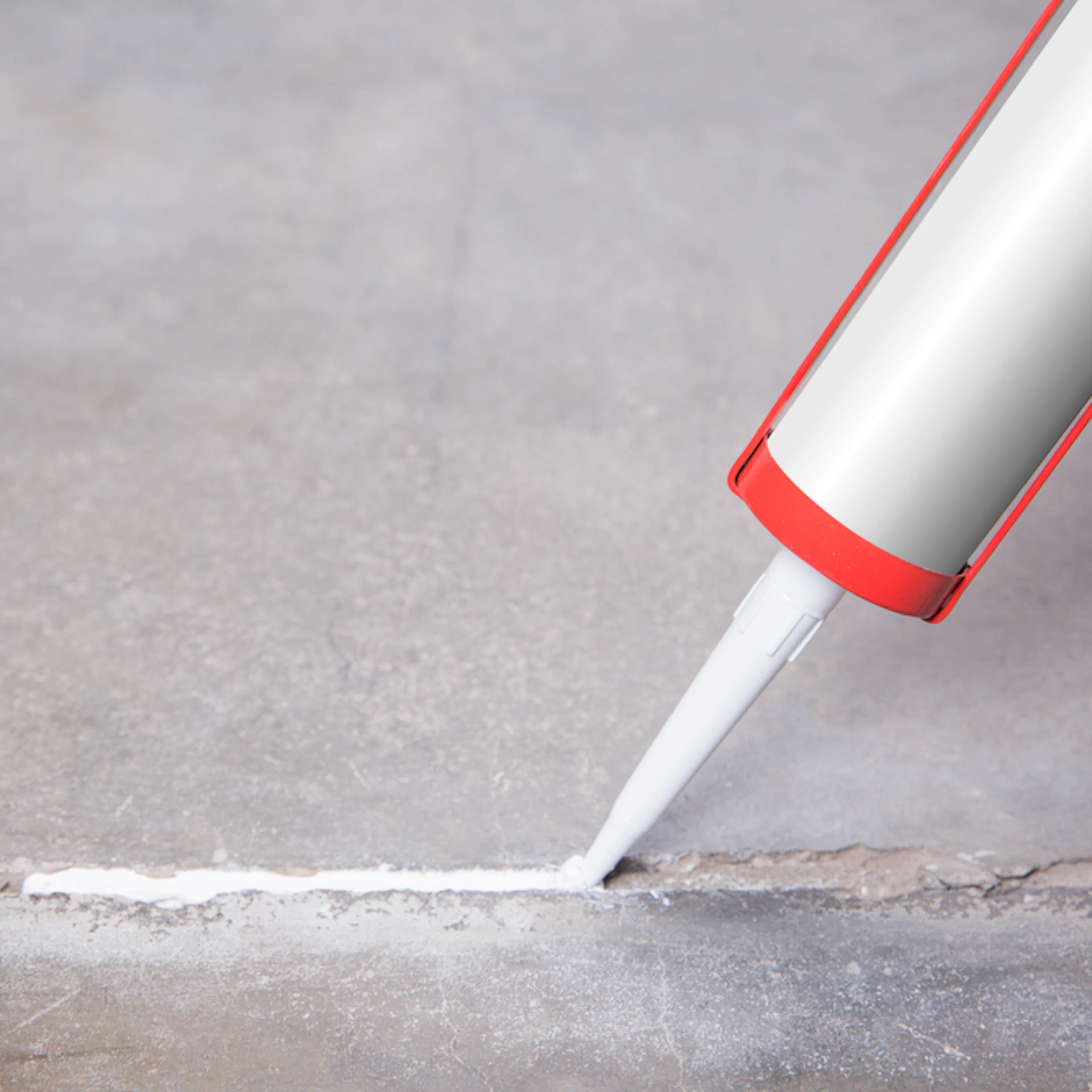

Sealing a crack with silicone. Image Credit: Shutterstock.com/Dimik_777
