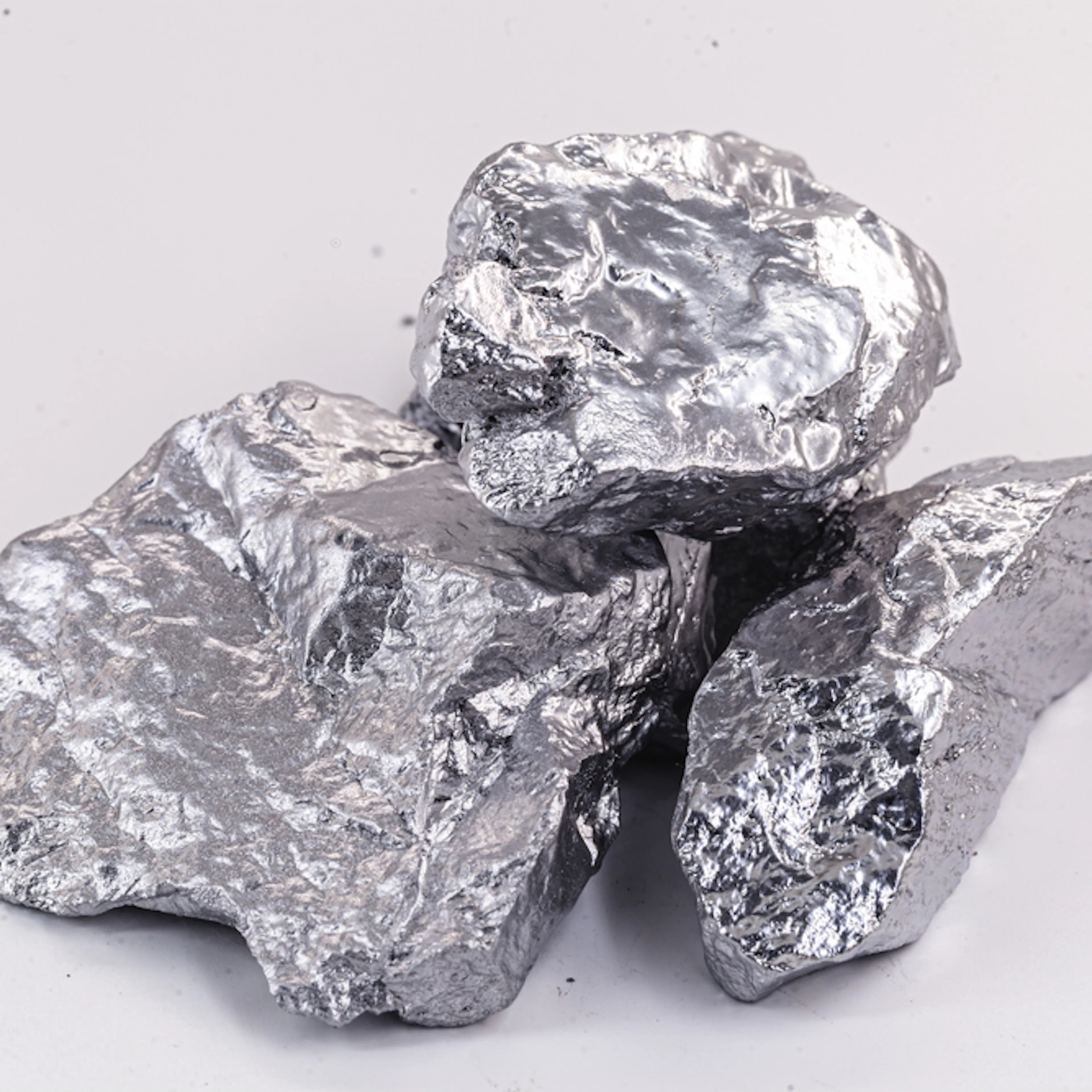

- Has a lustrous, gray-blue silver appearance.
What Is the Color of Tantalum?
Metallic tantalum is a lustrous, blue/gray silver color. Its ores, such as tantalite, are dark brown to black rocks.
What Does Tantalum Look Like?
Tantalum has the appearance of a bright metal. It retains its color as it suffers virtually no oxidation or other chemical reactions under normal environmental conditions.
