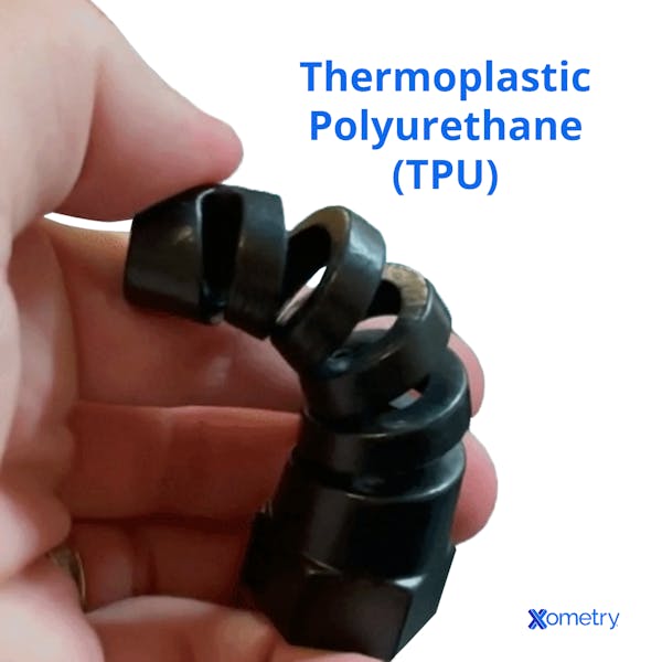

TPU or thermoplastic polyurethane is a broad category of polyurethane polymers with properties such as elasticity, transparency, wear resistance, and strong oil resistance. These thermoplastics feature alternating hard and soft polymer segments that give them both strength and flexibility.

TPU part manufactured by Xometry
