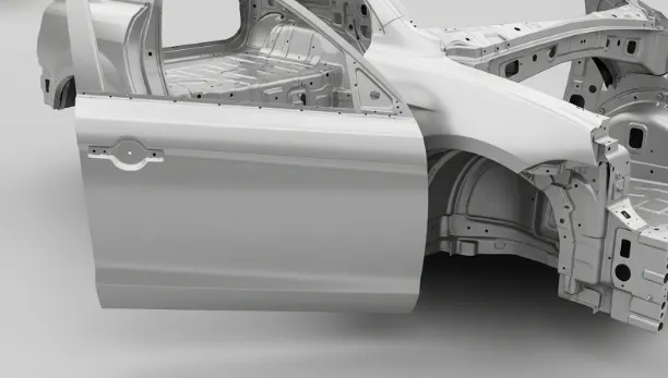

1. Transportation (Aluminum in automotive, aerospace, rail, marine components)
Aluminum is used in automotive, aerospace, rail, and marine components for structural members, body panels, extrusions, castings, and engineered assemblies. Vehicle lightweighting is a primary driver, since aluminum has low density compared to steel and most other structural metals. High specific strength supports stiffness and load-bearing performance at reduced mass. Corrosion resistance supports long service life in road salt, humidity, and marine exposure. Formability supports complex stamped shapes, while extrudability supports multi-functional profiles for crash management.
