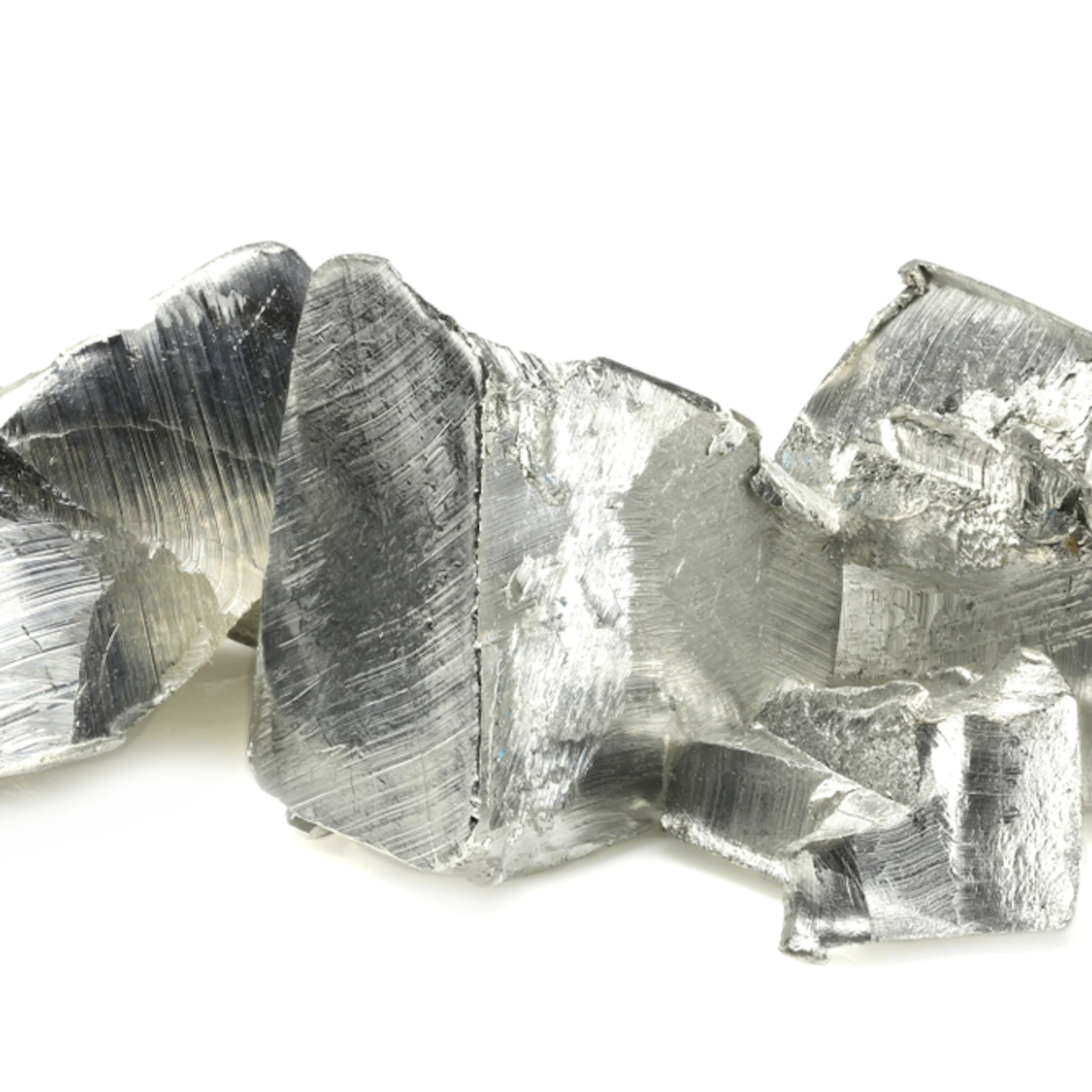

High-purity tin, unoxidized at room temperature. Image Credit: Shutterstock.com/Bjoern Wylezich

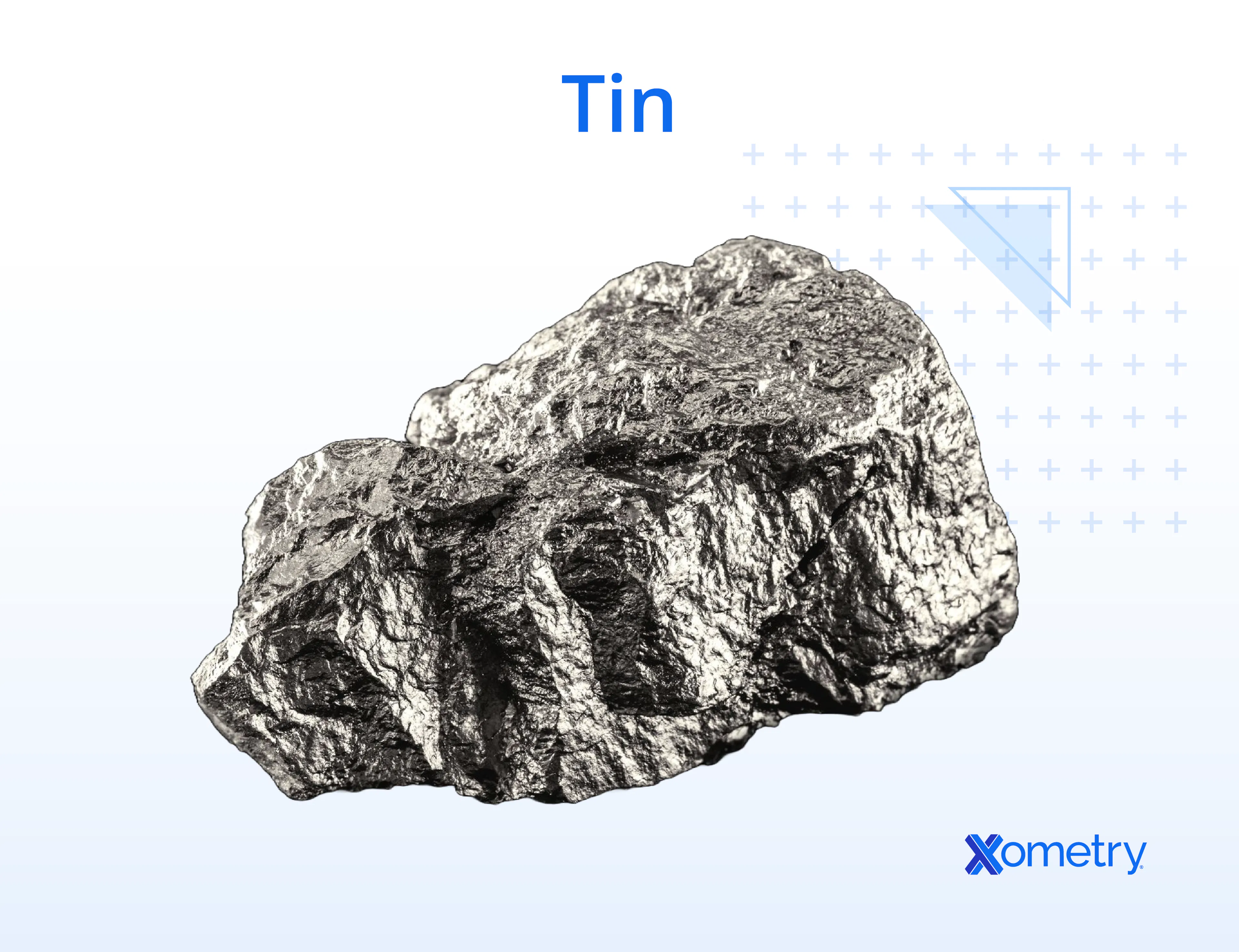

Tin is an elemental metal, meaning it is composed of only one type of atom and cannot be broken down into simpler substances. Tin atoms have 50 protons and typically around 69 neutrons, giving the most abundant isotope (¹¹⁹Sn) a mass number of 119.
A photograph of tin
A photograph of tin

What Is the Color of Tin?
Tin in its unoxidized state has a lustrous, silver appearance. It reflects light with near mirror-like precision when polished.
What Does Tin Look Like?
Tin appears silver and shiny when freshly cut or polished. Upon exposure to air, it gradually oxidizes, developing a gray or powdery-white surface layer.
