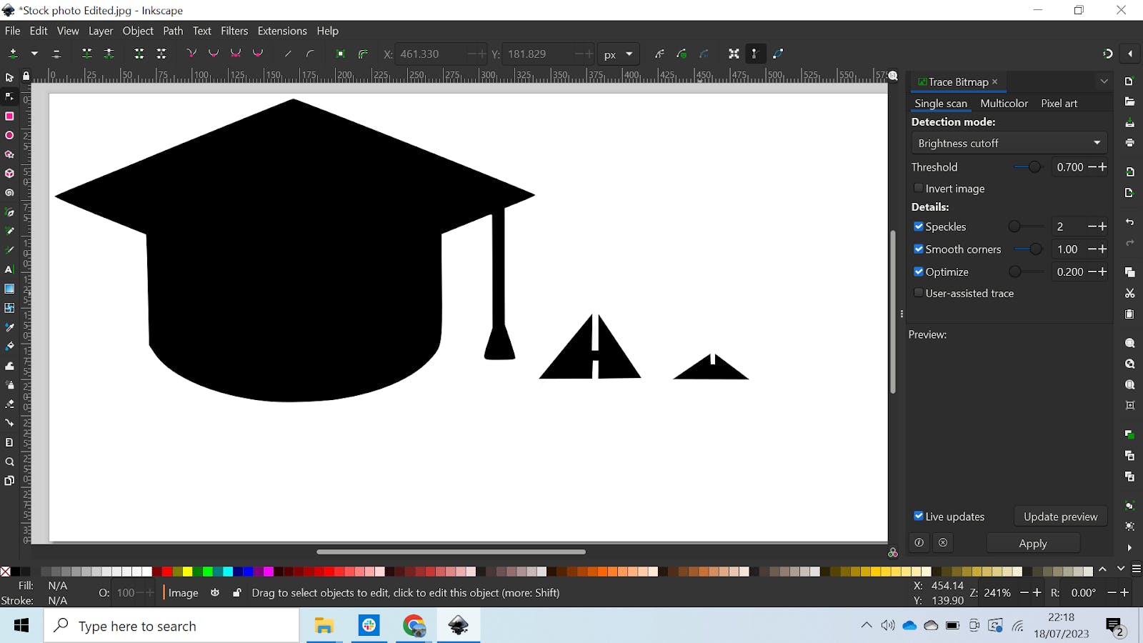

2. Edit Image Layers for Laser Cutting Guide
The image we selected will cause an issue when laser cutting if left unedited. You’ll see in the image below, that there’s a gap between the top and bottom parts of the image:
Gap in Mortarboard
If we were to upload the image into Inkscape like this, we’d have two problems to deal with. Firstly, the software will register this as two separate pieces and cut them out accordingly, which isn’t what we want. Secondly, even if that’s what we wanted, the lines are close enough to potentially cause the material to warp. So, the way to fix this is to remove the gap before inputting the image into Inkscape. Here’s how we edited it:
Edited Mortarboard

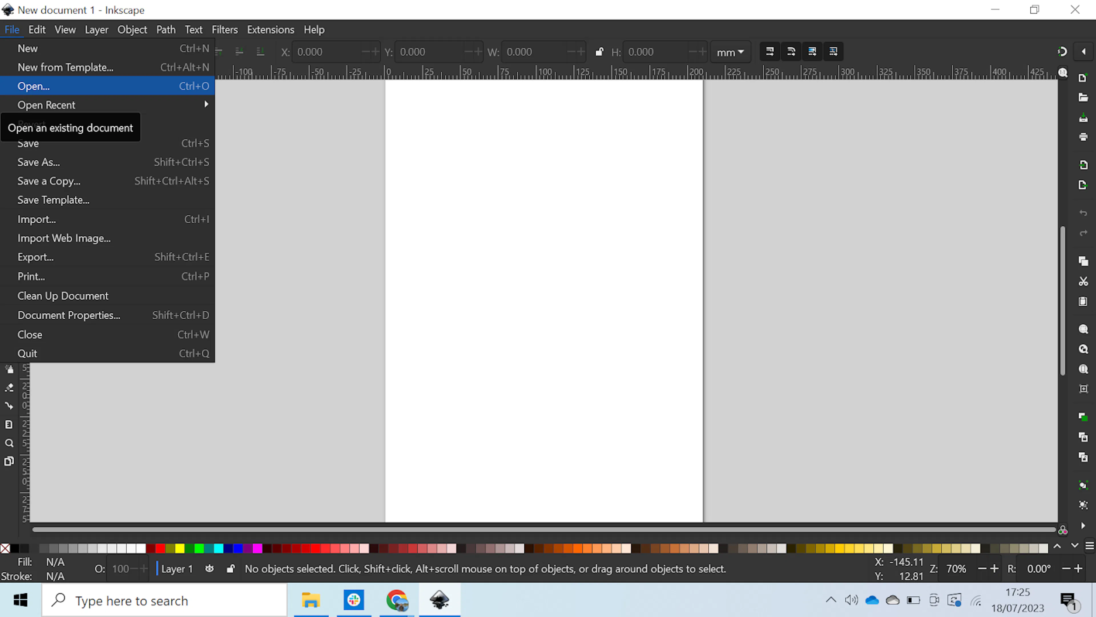

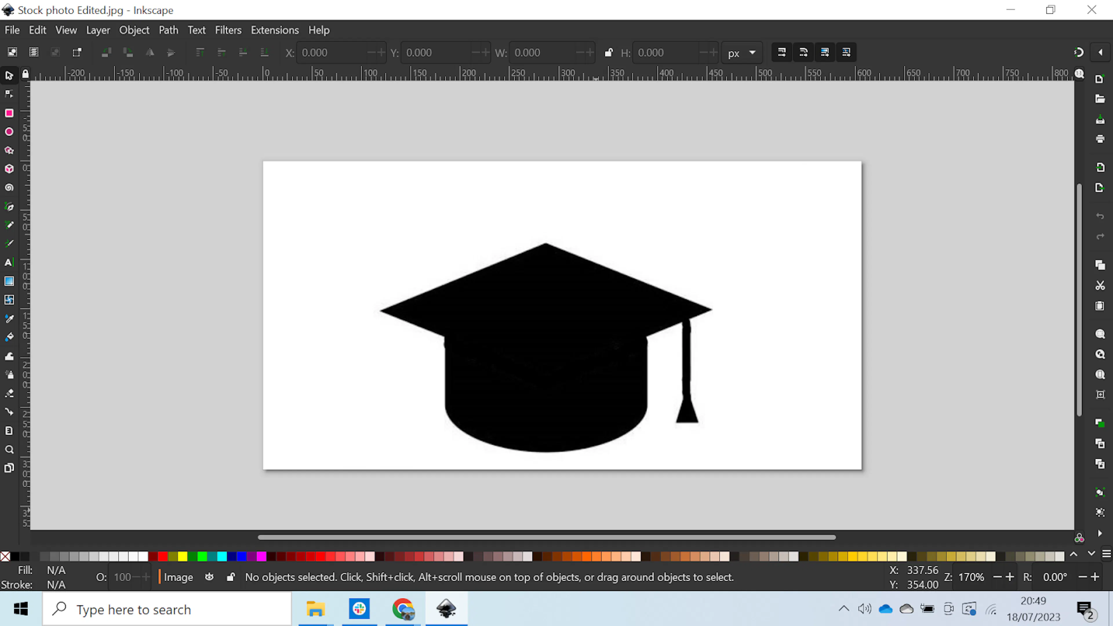

3. Import Into Inkscape and Trace Bitmap

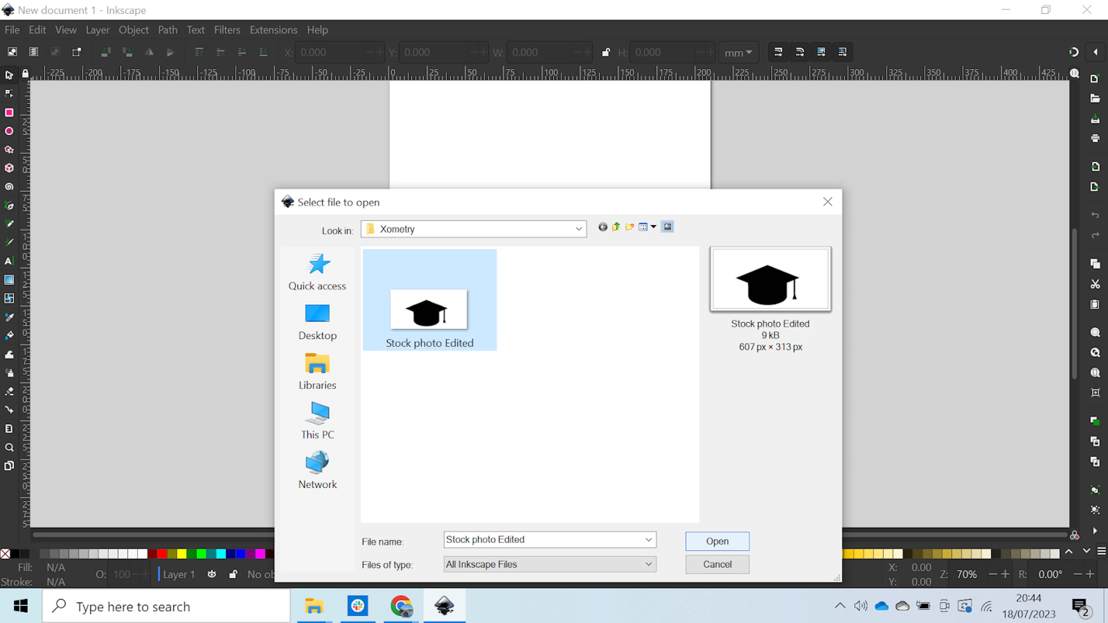

Once you’ve opened Inkscape, click on File > Open as shown below:
Inkscape Canvas

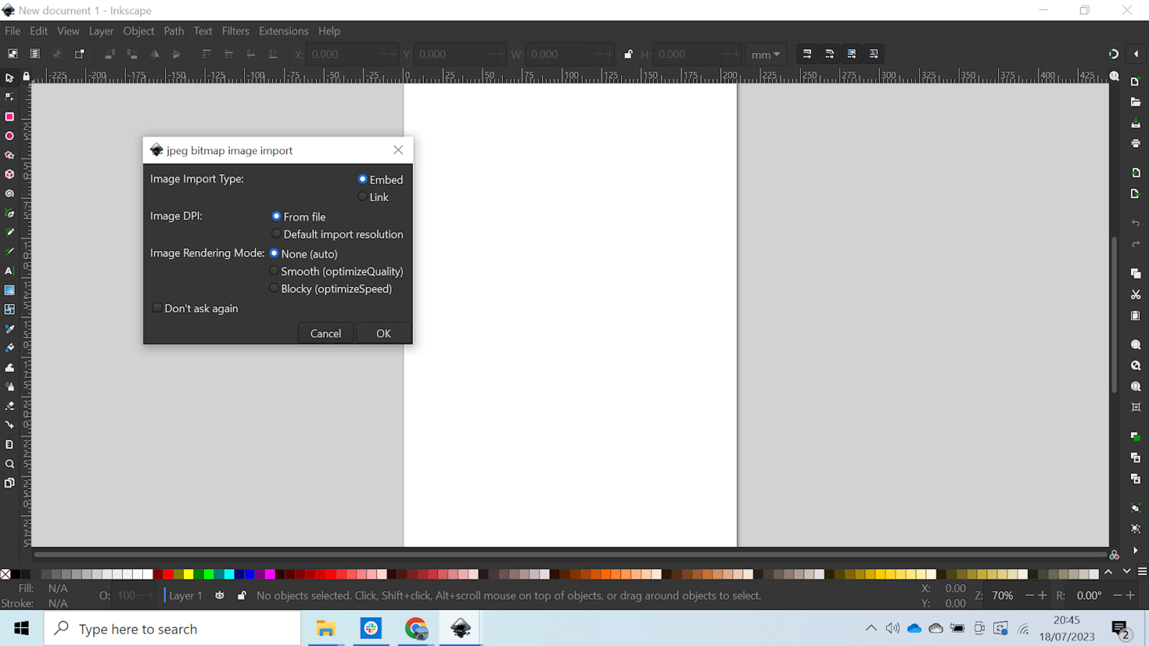

This will open a window that allows you to pick the image you want to import. Select it, and click “Open” like so:
Inkscape Open Folder
A box will appear that allows you to change the image settings, but you can leave these as standard and go ahead and click “Ok” as shown below:
Inkscape Dialog Box

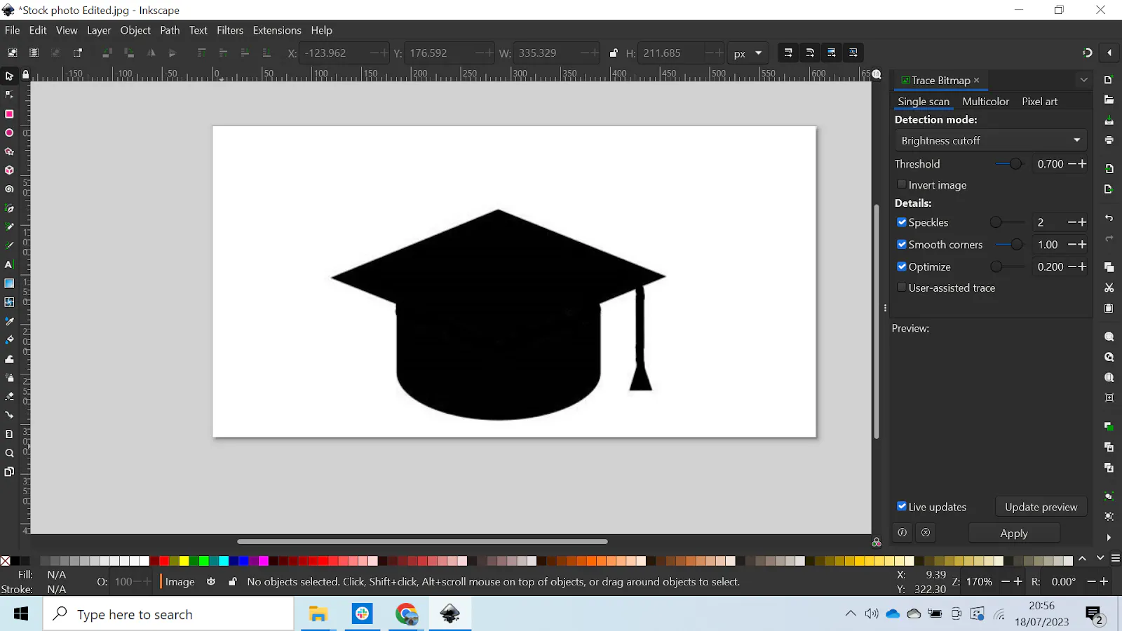

Your image should now be imported into Inkscape and look something like this:
Mortarboard in Inkscape

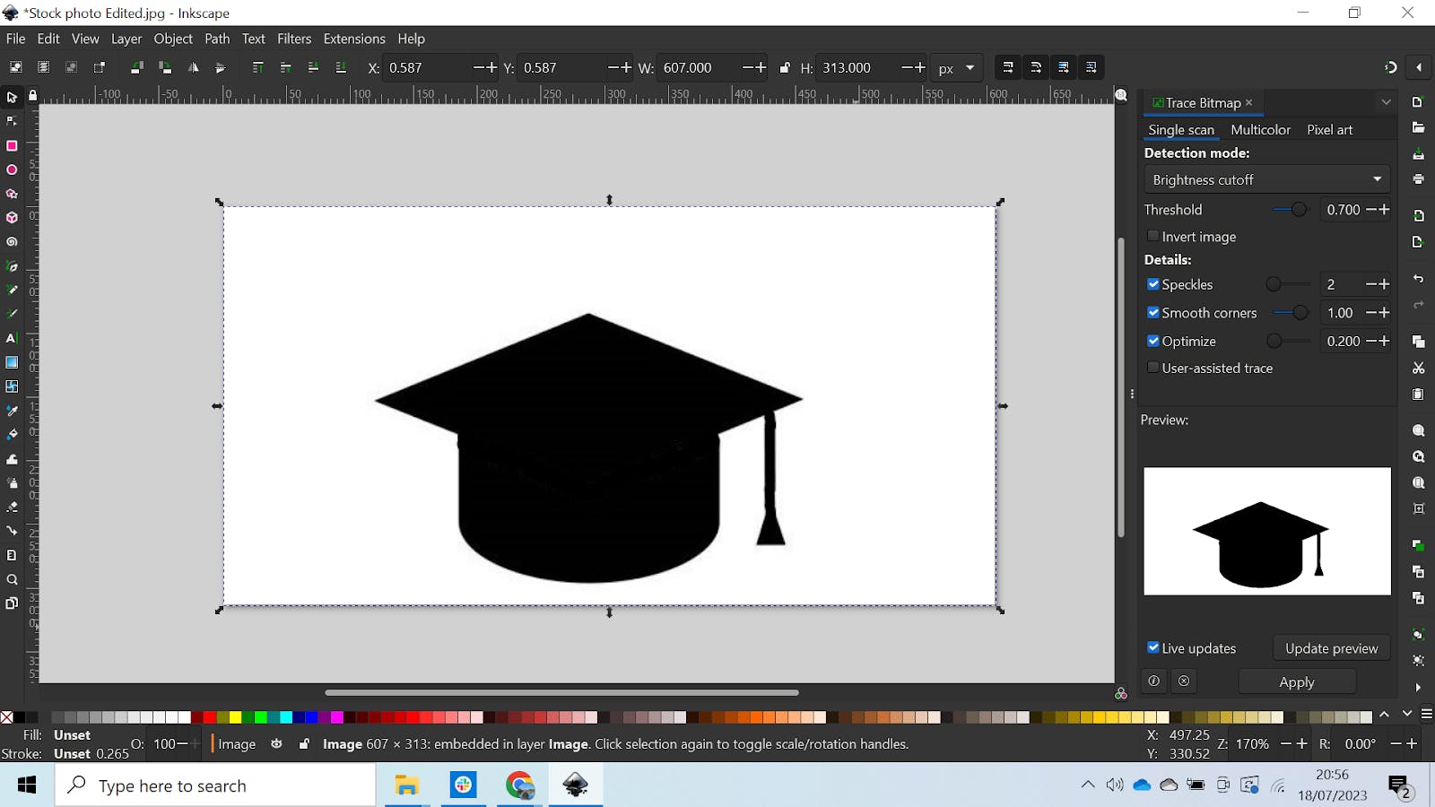

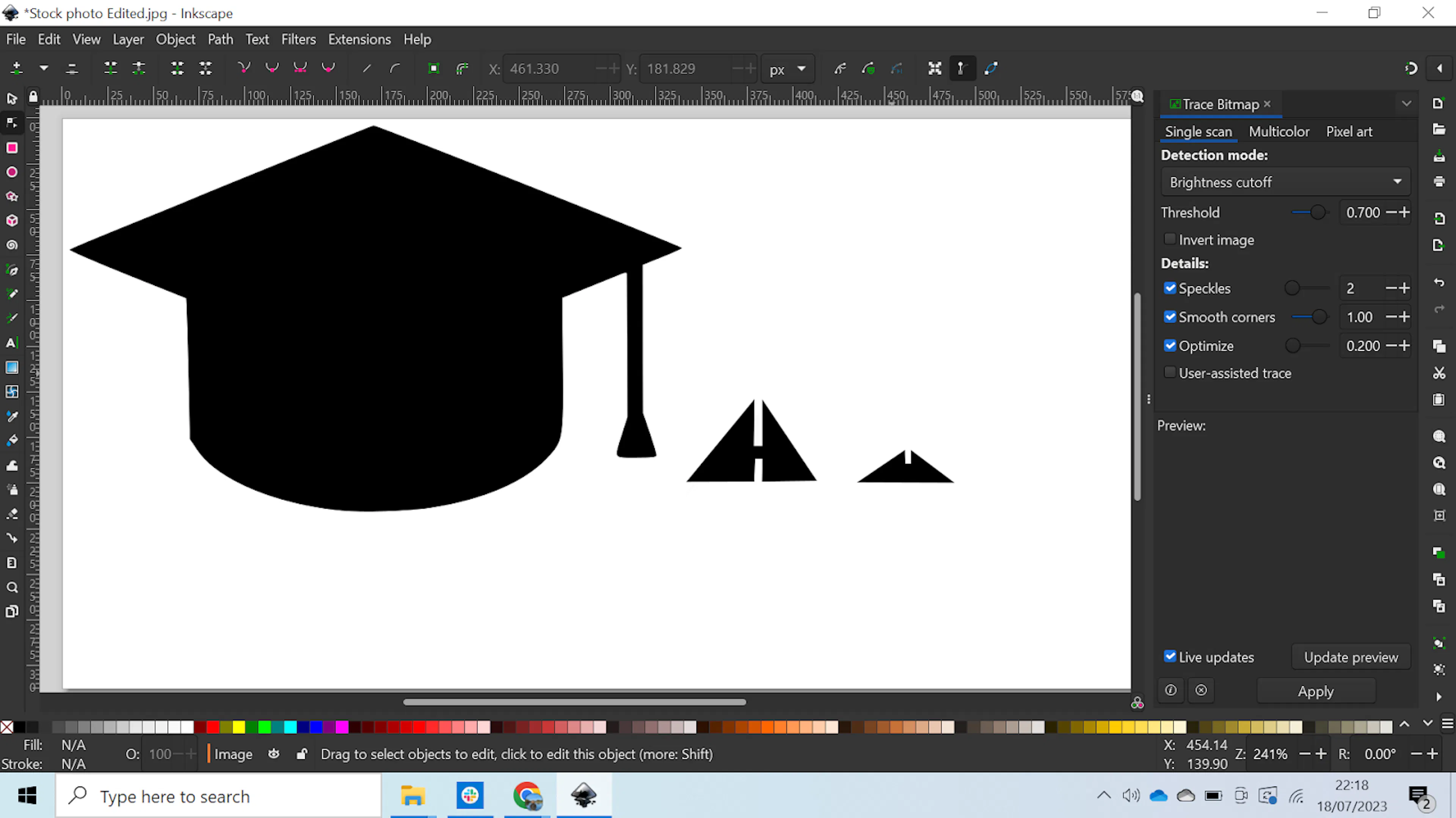

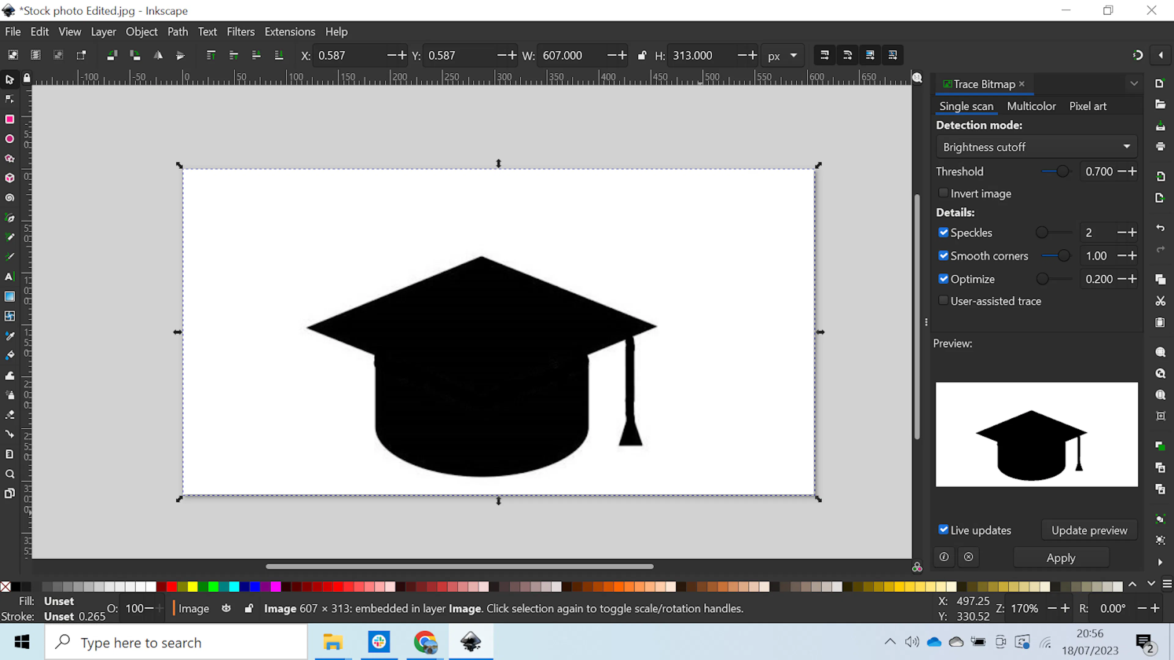

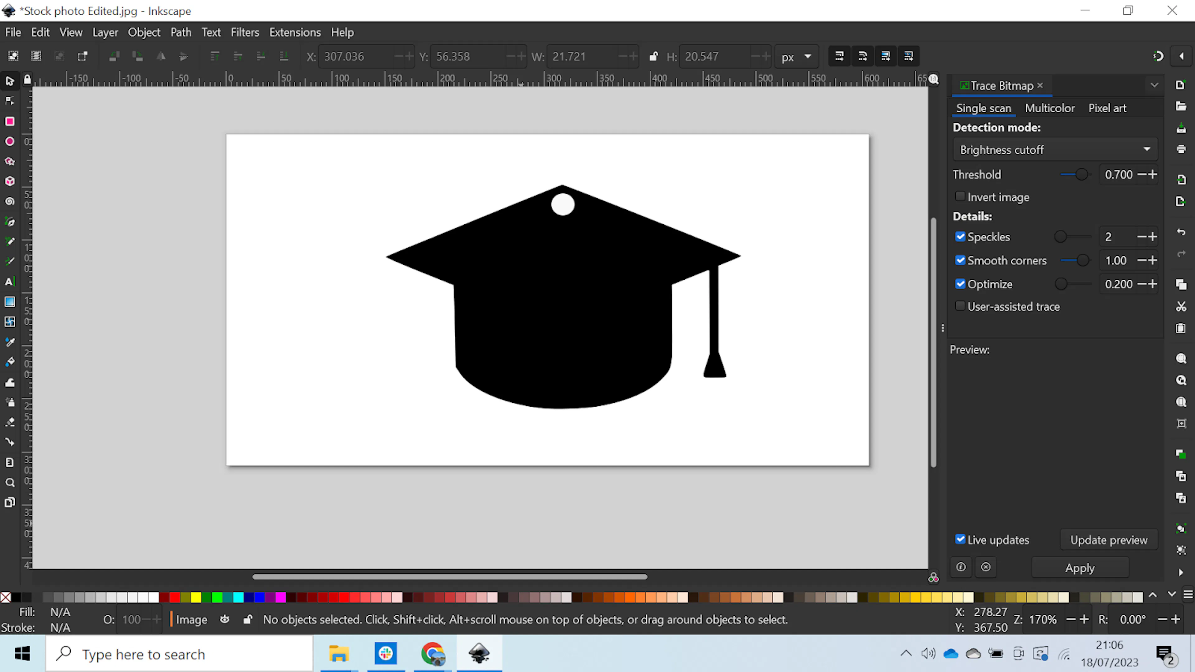

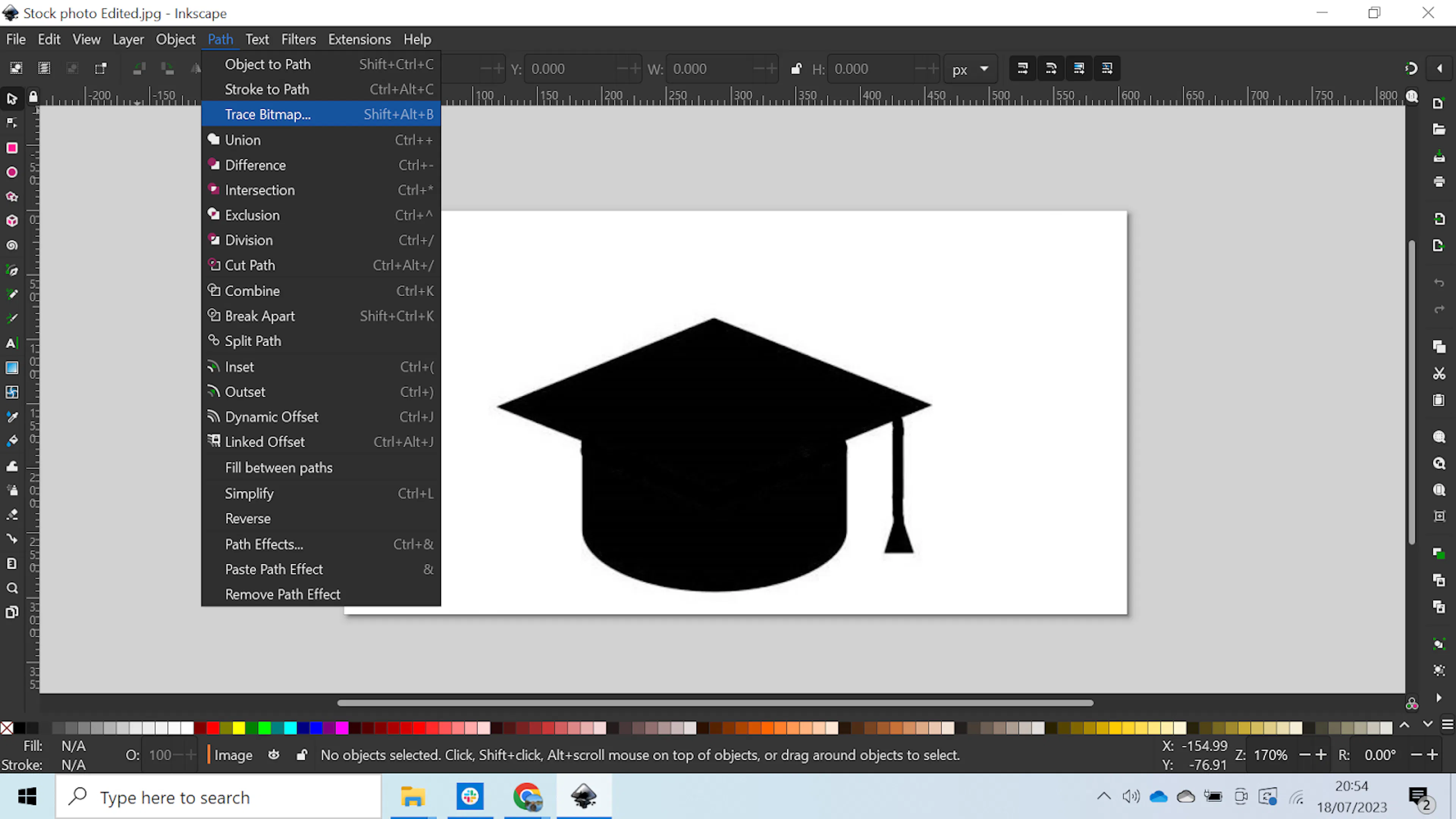

To trace the bitmap, select Path > Trace Bitmap. It should look like this:
Trace Bitmap

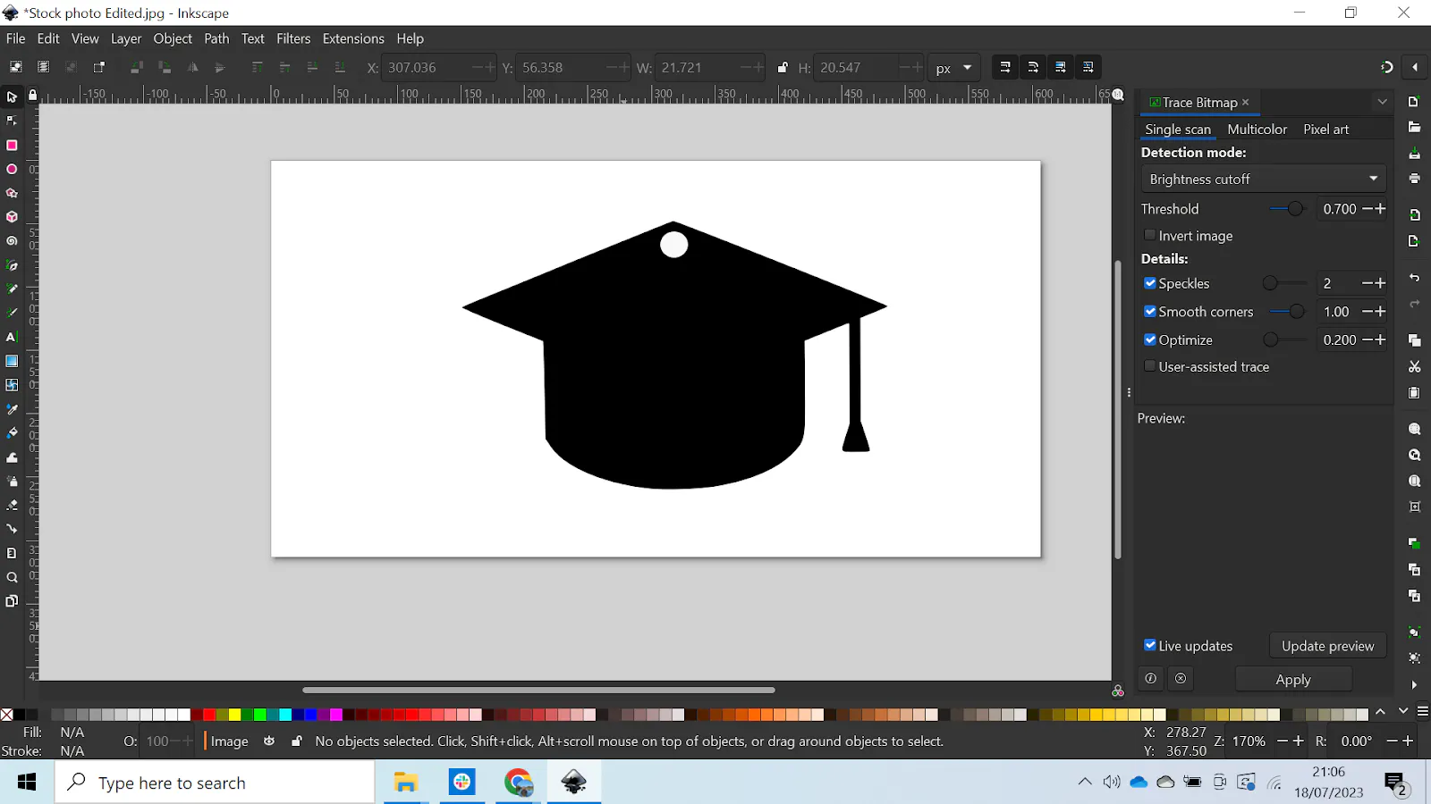

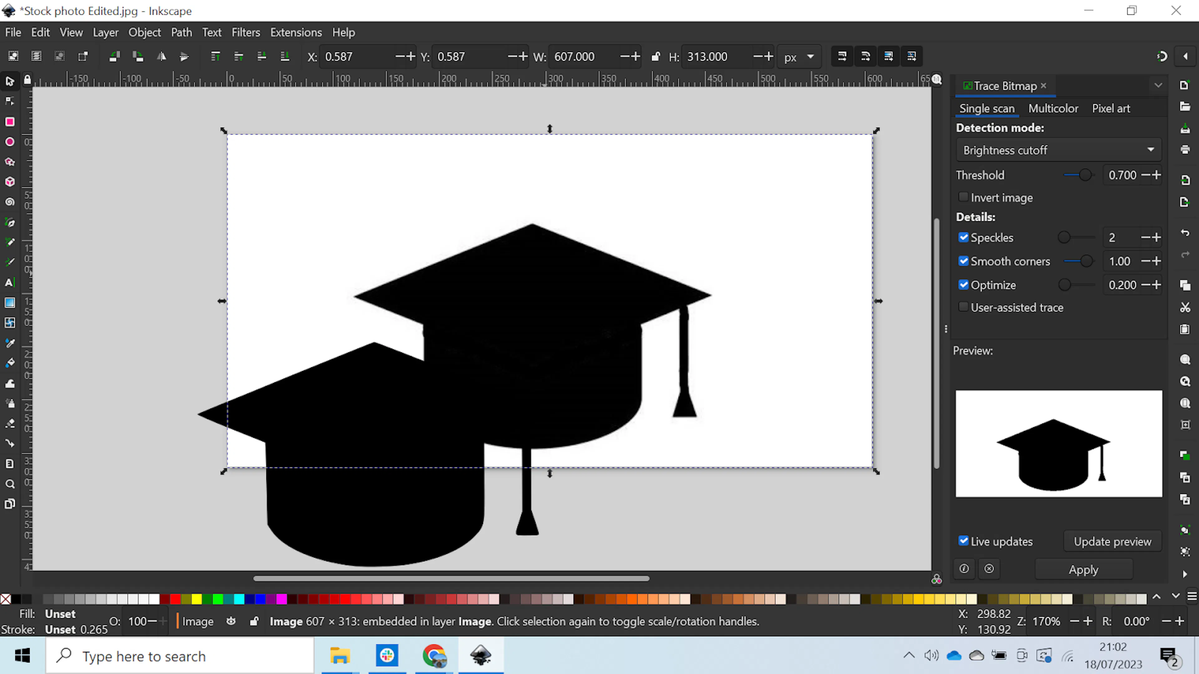

You’ll see a Bitmap menu appear on the right, which gives you further options. The point of this is to trace the silhouette and create a line for the laser cutter. Your screen should look a little something like this:
Trace Bitmap Applied
Make sure you select the image for this to work and click on “Apply.” When it’s done its thing, the silhouette will appear on top of the image like so:
Delete the Original Photo
Move the new silhouette to the side, and delete the original. Then you’ll just be left with the new image as shown below:
Silhouette

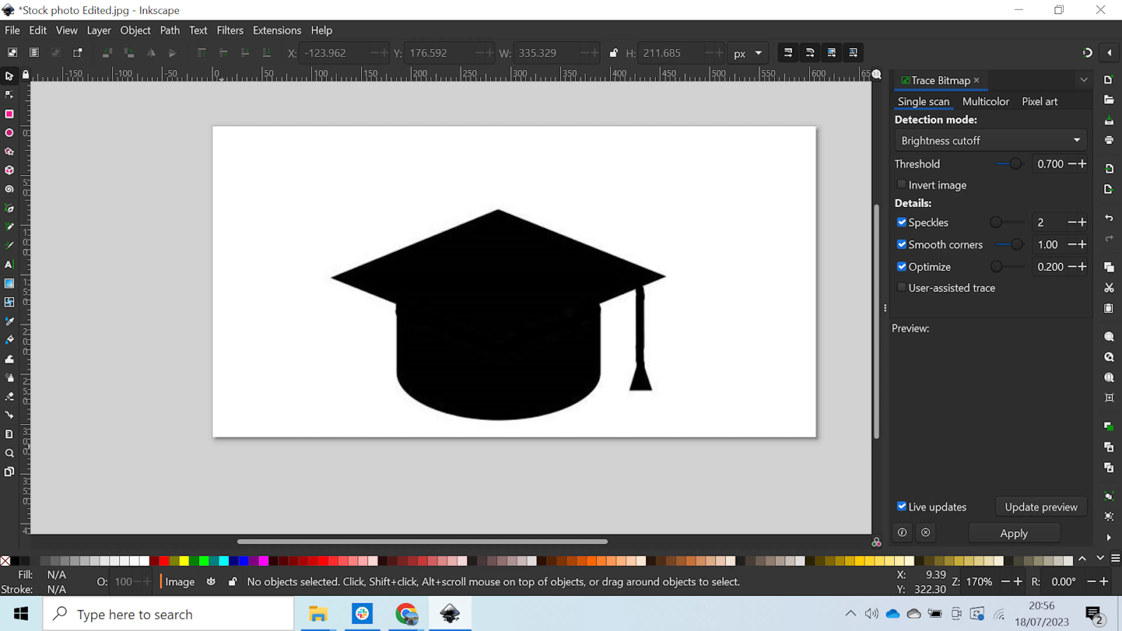

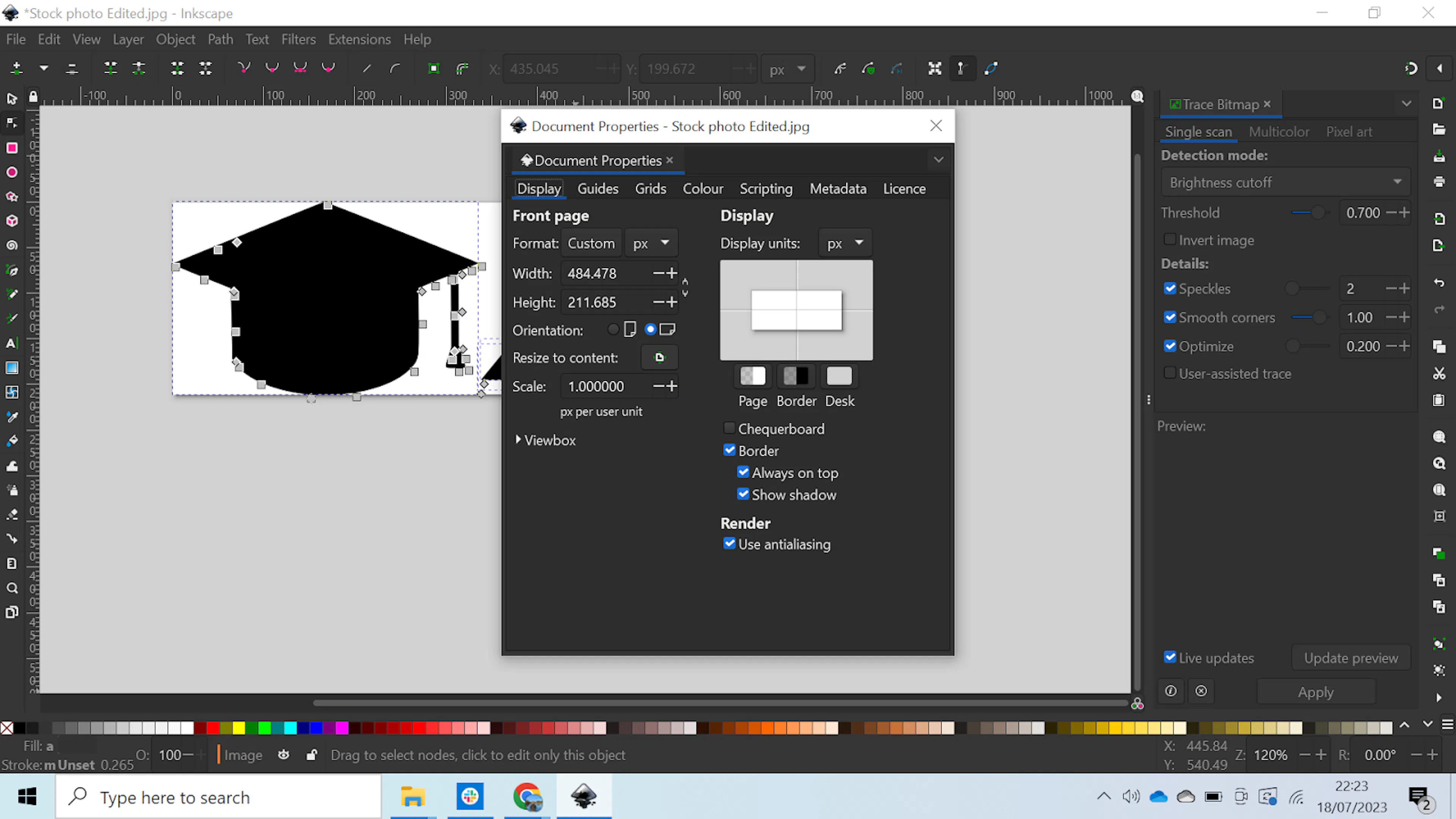

5. Making Page Orientation Changes To Enclose Base Design
When the software has mapped out and traced your image, it’s likely that it won’t all fit on the page, but don’t worry because it’s an easy fix. Select all the pictures and go to File > Document Properties. In the box that pops up (shown in the next image), click on “Resize to content.” That will make the page fit to your design and save scrap.
Resize Document To Fit Geometry

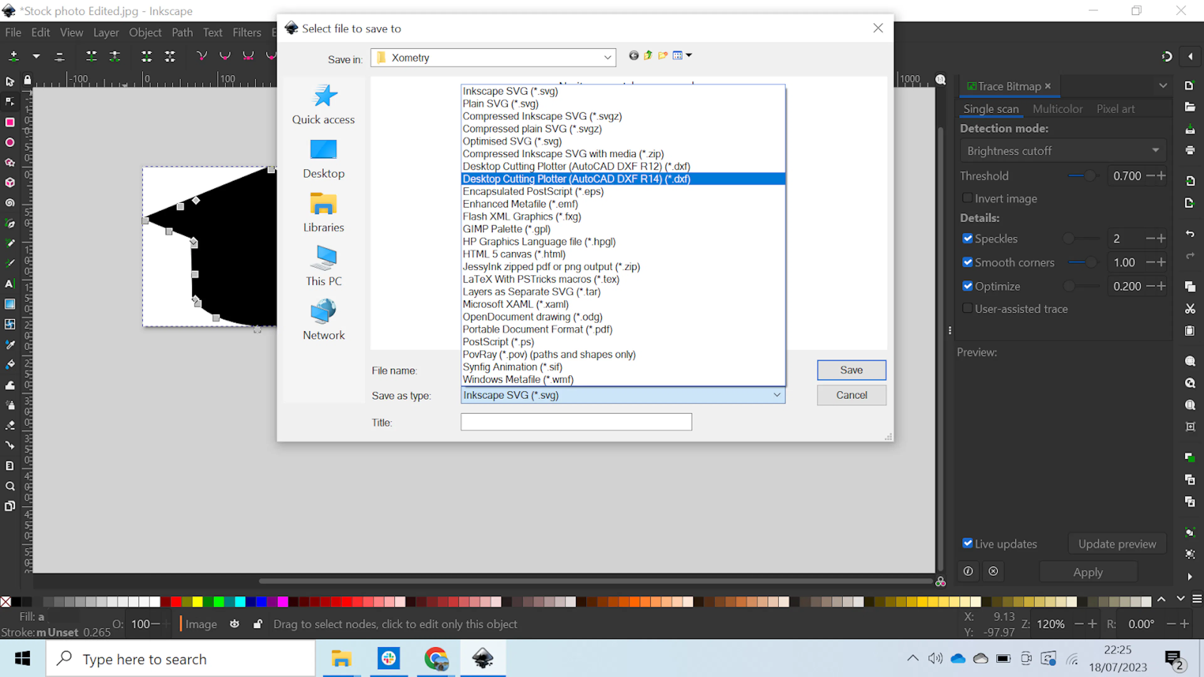

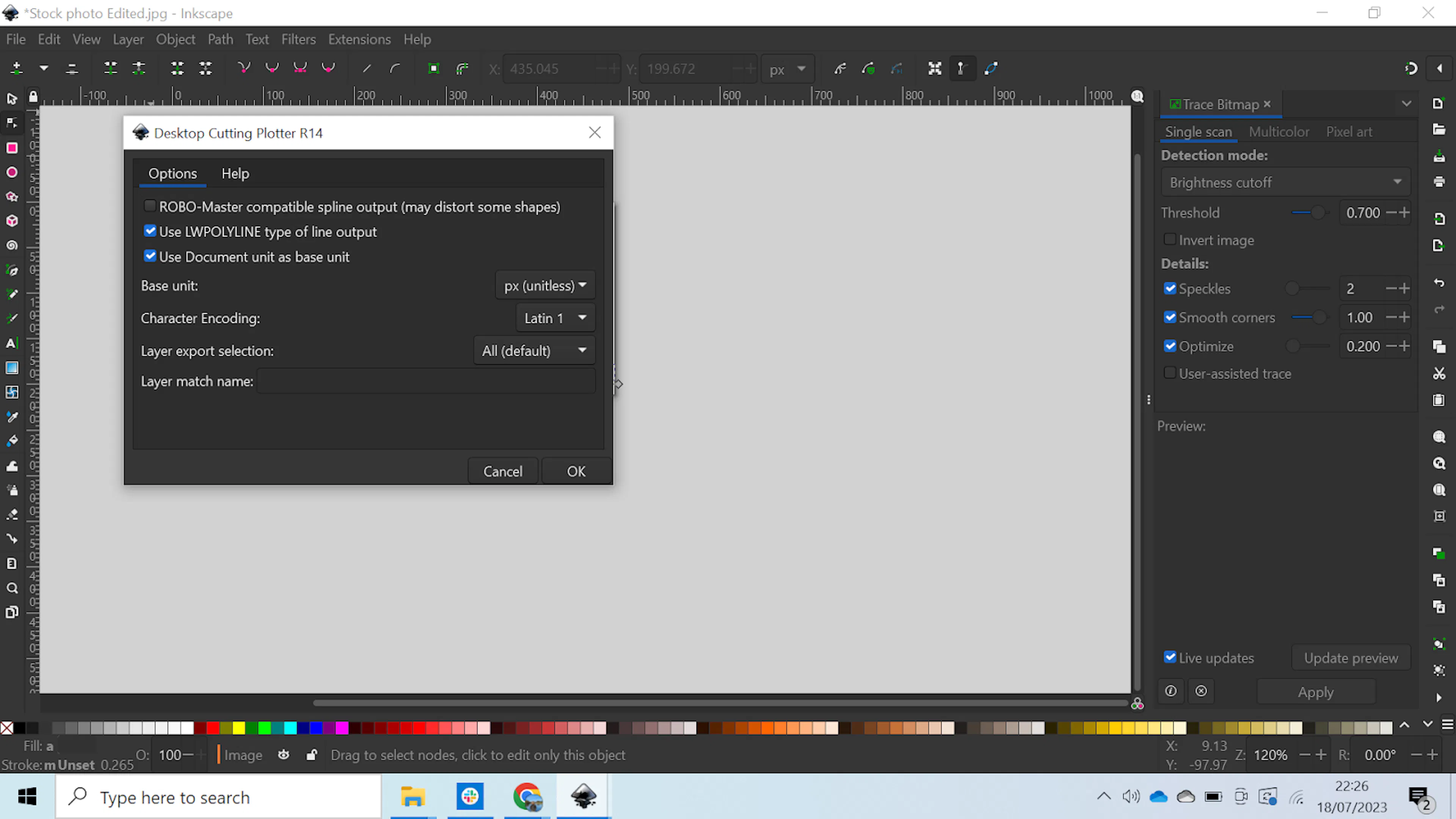

6. Exporting to DXF
When you're good to go, head over to File > Save as to export your design. In the dropdown, select “Desktop Cutting Plotter (AutoCAD® DXF R14)” as shown in the next image:
Save the File as DXF
When the dialog box pops up, go ahead and click “Ok” like so:
Click “Ok” in the Dialog Box
