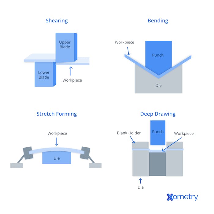

Different sheet metal forming processes.

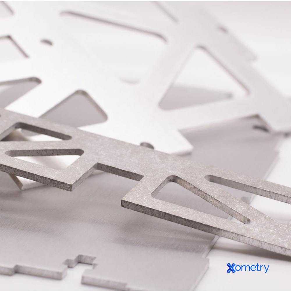

2. Laser Cutting
Before metal sheets get formed, many times the initial flat patterns are laser cut first. Laser cutting uses a high-powered laser to cut shapes into flat metal sheets. It’s one of the most precise methods and can make a plethora of shapes, patterns, and holes. To start laser cutting sheet metal, a blank sheet is attached to the cutter’s bed, and then the laser itself does all the hard work. The machine’s laser beam is controlled by a CNC (computer numerical control) system so that highly accurate and clean cuts can be made. The system can also pre-program different patterns and repeat them again and again.
There is very minimal post-processing needed with this method, and hardly any waste. It is commonly used in automotive, aerospace, and electronics. At Xometry we offer sheet cutting as a standalone service and offer many metals like steel, stainless steel, aluminum, and copper. A potential downside of this method is its high initial cost—the machinery is quite pricey. This is why many customers turn to Xometry for their laser cutting needs. Visit our sheet cutting services page to learn more about what we offer in this area.

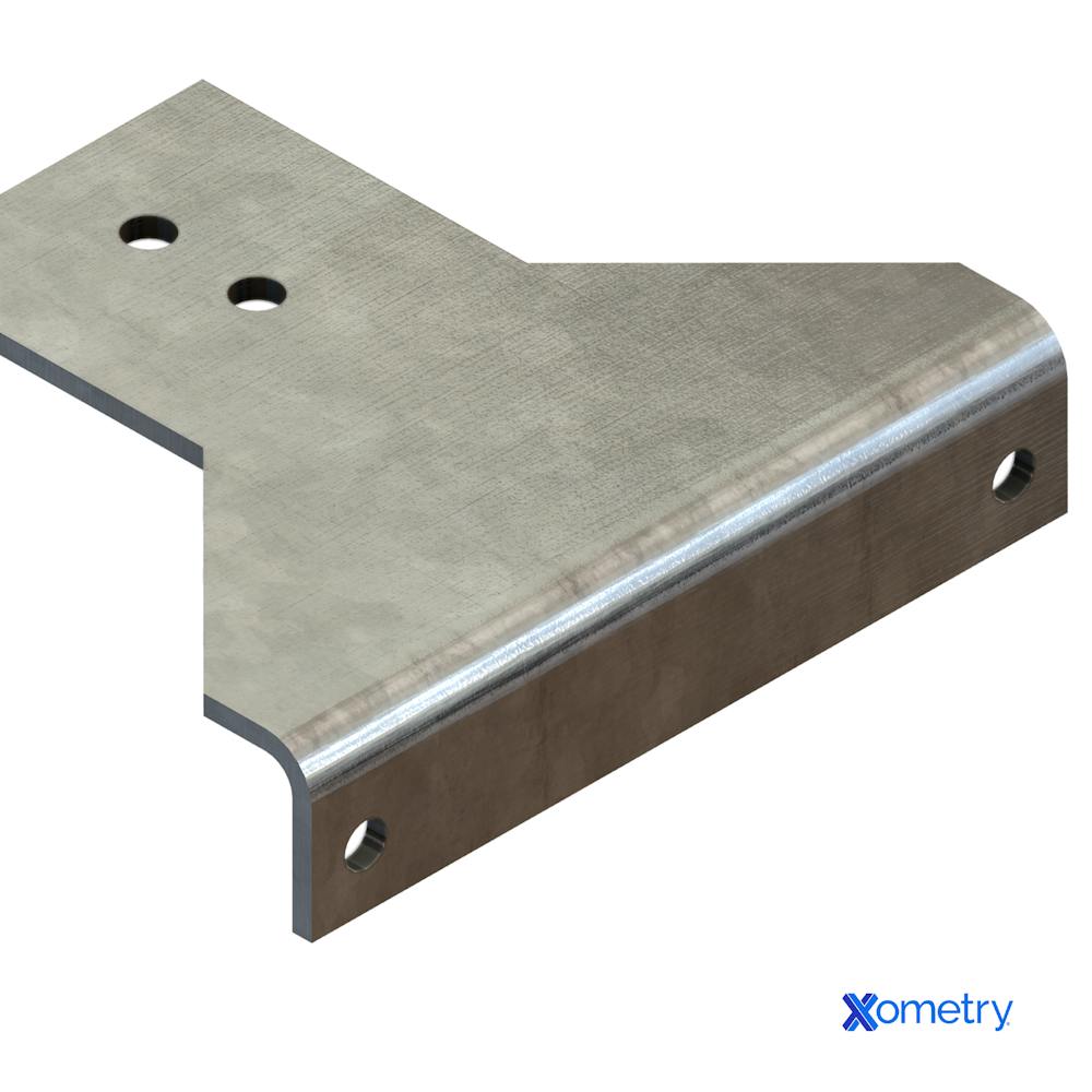

3. Bending
One of the most commonly utilized sheet metal forming processes at Xometry is bending. Bending sheet metal requires the use of specialized but fairly simple bending tools, like press brakes. The sheet metal bending process is quick, accurate, and one of the most inexpensive. The process is used to (as the name suggests) make bends and curves on the metal sheet in a straight line. With press brakes, the metal is put or clamped into place and then bent to the required angle.
This sheet metal forming process is often used for vehicle body parts, enclosures, and electrical components. It can be performed on most compatible sheet metal forming materials, like stainless steel, brass, aluminum, and galvanized steel. It does have some limitations, however; the metal needs to have the same thickness throughout, and thicker materials will understandably be much harder to bend.

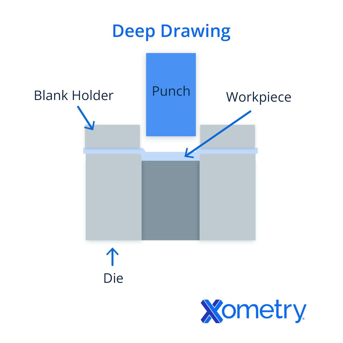

6. Deep Drawing
For intricate and hollow cylindrical shapes like cooking pots, beverage cans, and car door panels, many manufacturers turn to deep drawing. The process involves the sheet metal being placed over a die, then pressed with a punch into an open cavity, causing the material to undergo plastic deformation. The process allows for precisely made complex shapes and designs with deeper features.
Materials common in deep drawing include malleable metals like aluminum, copper, brass, and stainless steel. Minimal manual labor is needed with this method, and it’s cost-effective for high-volume production.
7. Shearing
Shearing is used to cut sheet metal along a straight line, which is helpful when either cutting the material into smaller pieces or trimming its edges. A shearing machine has two blades that slide past each other, like giant scissors, to cut the metal. A sheet has to be placed on the machine, clamped into place, and then its upper blade is lowered onto the material to make the cut. This is one of the most widely used processes for sheet metal forming, mainly because it’s convenient, quick, produces minimal waste, and reduces costs when making high volumes.
The manufacturing, construction, and auto industries all use it for shearable materials, like steel, aluminum, and stainless steel. The process does sometimes cause the edges to deform or burr, especially when working with thicker materials which some shearing machines might particularly struggle with. For more complex shapes, you’ll have to add in an additional forming process, as this one only does straight-line cuts.
