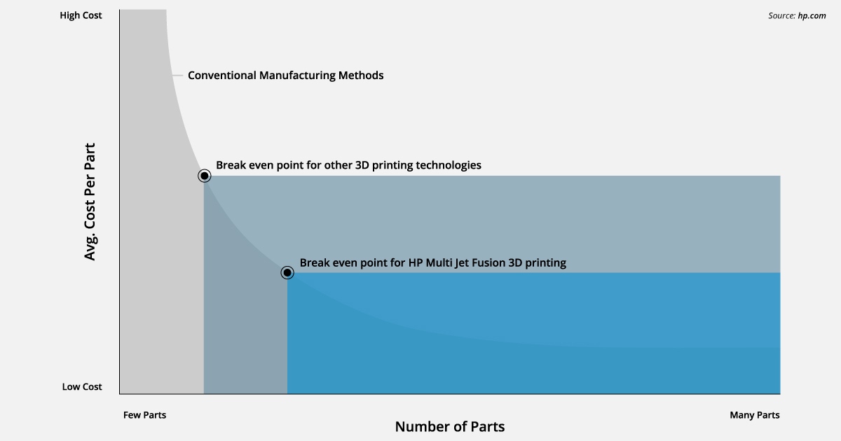

Use Multi Jet Fusion 3D printing when you need a technology that is fast and can produce highly detailed, dimensionally accurate features. Additionally, MJF is developed by HP, which has decades of experience in durable hardware development and end-user technical support.
Why Is MJF Excellent for the Production of End-Use Parts?
MJF 3D printing is excellent for the production of end-use parts since it is a high-volume additive manufacturing technology that was developed especially for this purpose. MJF makes use of nylon and polypropylene powders as raw materials. Both are engineered thermoplastics used in a number of industrial applications. MJF parts also have isotropic properties which is not always the case with other printing technologies such as FDM (Fused Deposition Modeling) and SLS (Selective Laser Sintering). MJF is able to produce highly detailed small features. The use of a detailing agent also ensures a smooth, albeit matte, outer surface finish.
