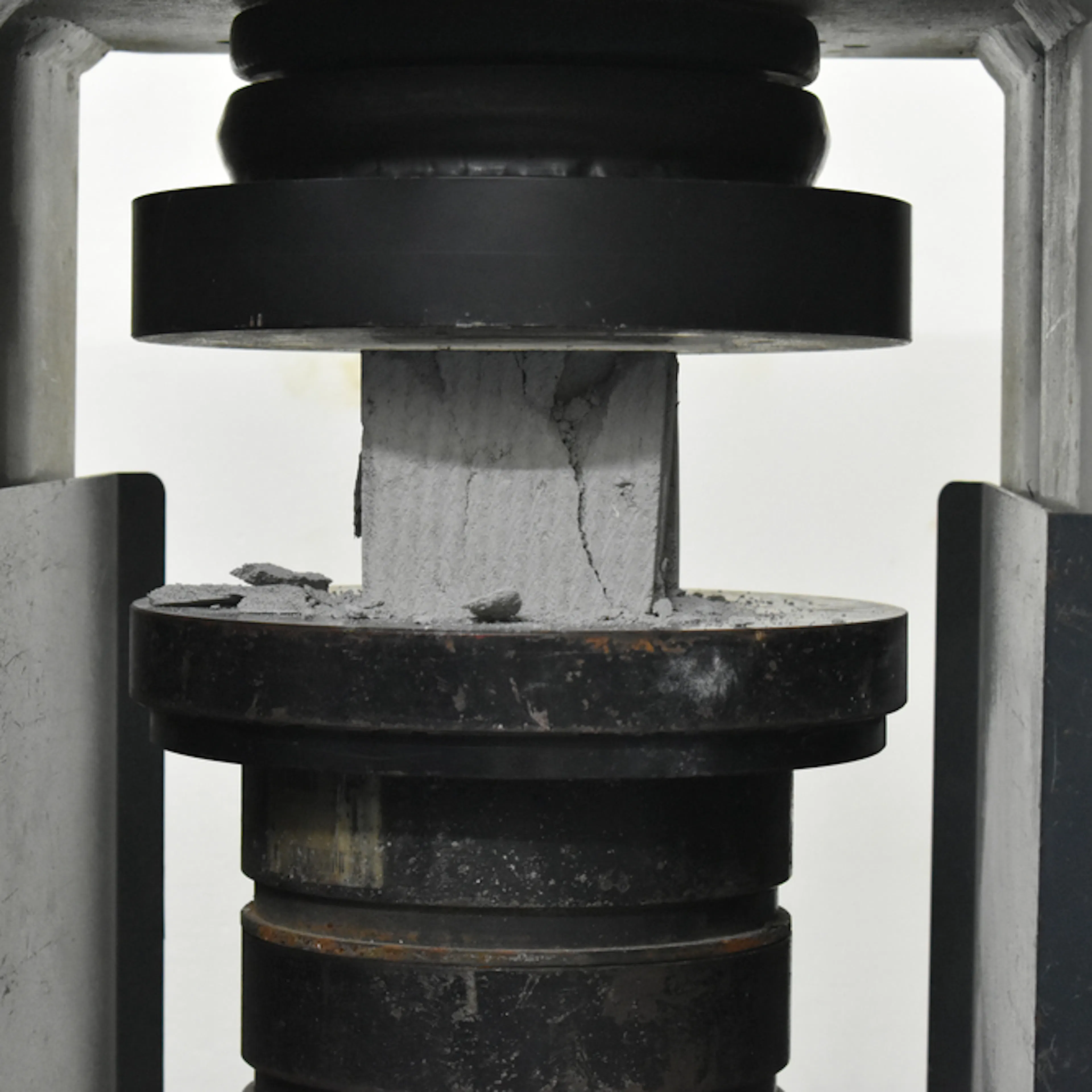

Performing the test and understanding the graph
Compression test of concrete cube. Image Credit: Shutterstock.com/Zubair Rashid

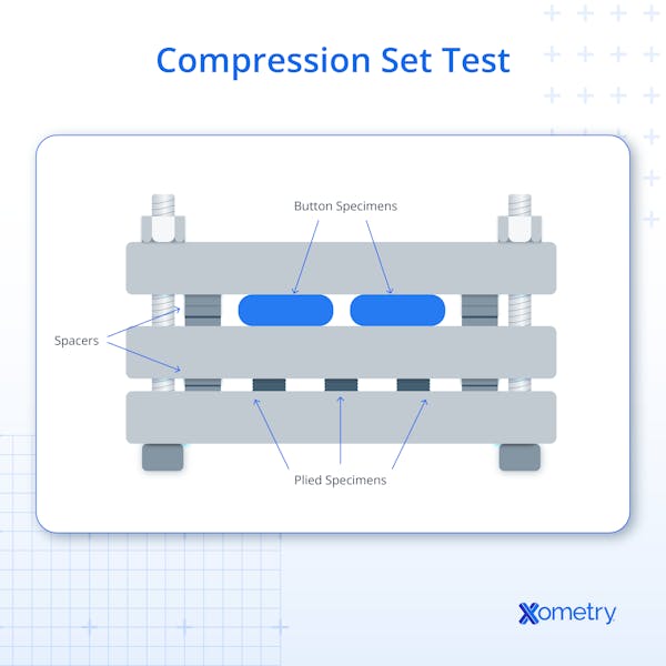

How is ASTM D395 Conducted?
To conduct ASTM D395, follow the six steps. First, prepare a rubber specimen with a standardized geometry and record the initial thickness using a calibrated thickness gauge. Second, select the test method (Method A, constant force or Method B, constant deflection) and set the target compression deflection (25% or 40%). Third, place the specimen in the compression fixture between flat, parallel platens and apply compression using spacers or fixture stops to lock the deflection. Fourth, age the compressed specimen for a defined duration (22 hours or 70 hours) at a defined temperature (70°C, 100°C, 125°C, or 150°C). Fifth, remove the specimen from the fixture while hot, release the load, and allow recovery for a defined time (30 minutes) at standard laboratory temperature (23°C). Lastly, measure the final thickness and calculate the compression set percentage from the unrecovered thickness change relative to the applied deflection.

What is a Compression Tester?
A compression tester is a measurement device that applies a controlled compressive load or controlled deflection to a material specimen to evaluate thickness change, force response, and permanent deformation after recovery. A compression tester setup uses flat, parallel platens, a calibrated force or displacement control system, and a thickness gauge or displacement sensor with a resolution of 0.01 mm. The operation starts by measuring initial specimen thickness, applying a defined deflection (25% or 40%) or a defined force, holding the condition for a set duration (22 hours or 70 hours) at a controlled temperature (70°C to 150°C), then measuring final thickness after a defined recovery time (30 minutes). Accurate results require platen alignment within 0.05 mm, lubricated contact surfaces, and repeatable specimen placement to prevent edge loading. Compression testers support ASTM D395 compression set testing and compression deflection force testing for rubber, silicone, EPDM, FKM, and TPU.
How is it Used to Measure Compression Set? A compression tester measures compression set by compressing a specimen to a defined deflection (25% or 40%), holding the deflection during oven aging, releasing the load, and then measuring permanent thickness loss after recovery. Initial thickness is recorded first, then the specimen is clamped in a compression fixture with spacer stops. Aging runs for 22 hours or 70 hours at 70°C to 150°C. Recovery lasts 30 minutes at 23°C before final thickness measurement and calculation.
1. Compression Set A
A compression set A is the ASTM D395 method that measures compression set under constant force, where a specified load compresses the rubber specimen, and the final permanent deformation is measured after aging and recovery. Method A uses a spring or force-controlled fixture to maintain a target compressive force rather than a fixed thickness reduction. The setup is used when installed parts experience variable squeeze under load rather than a fixed deflection. A practical example is a rubber pad or mount that sees a sustained clamping force where the thickness varies slightly with load and temperature. The compression set A results are reported as a percentage of the original thickness.
2. Compression Set B
Compression Set B is an ASTM D395 test method that evaluates permanent deformation after an elastomer is held at a fixed deflection during thermal aging. The specimen is compressed to a defined thickness reduction and mechanically restrained at the target deflection through spacers or stop-controlled fixtures. Common deflection levels include 25% and 40% of the original thickness, depending on the application and material class. The method aligns with sealing design because gaskets and O-rings operate under a controlled squeeze rather than a controlled load. A representative case involves holding an O ring at 25% deflection for 22 hours at 100 °C, unloading the specimen, allowing a defined recovery interval, and measuring unrecovered thickness to calculate compression set. Method B is widely used for comparing elastomer compounds when fixture control and repeatable deflection are required.

Compression set test
