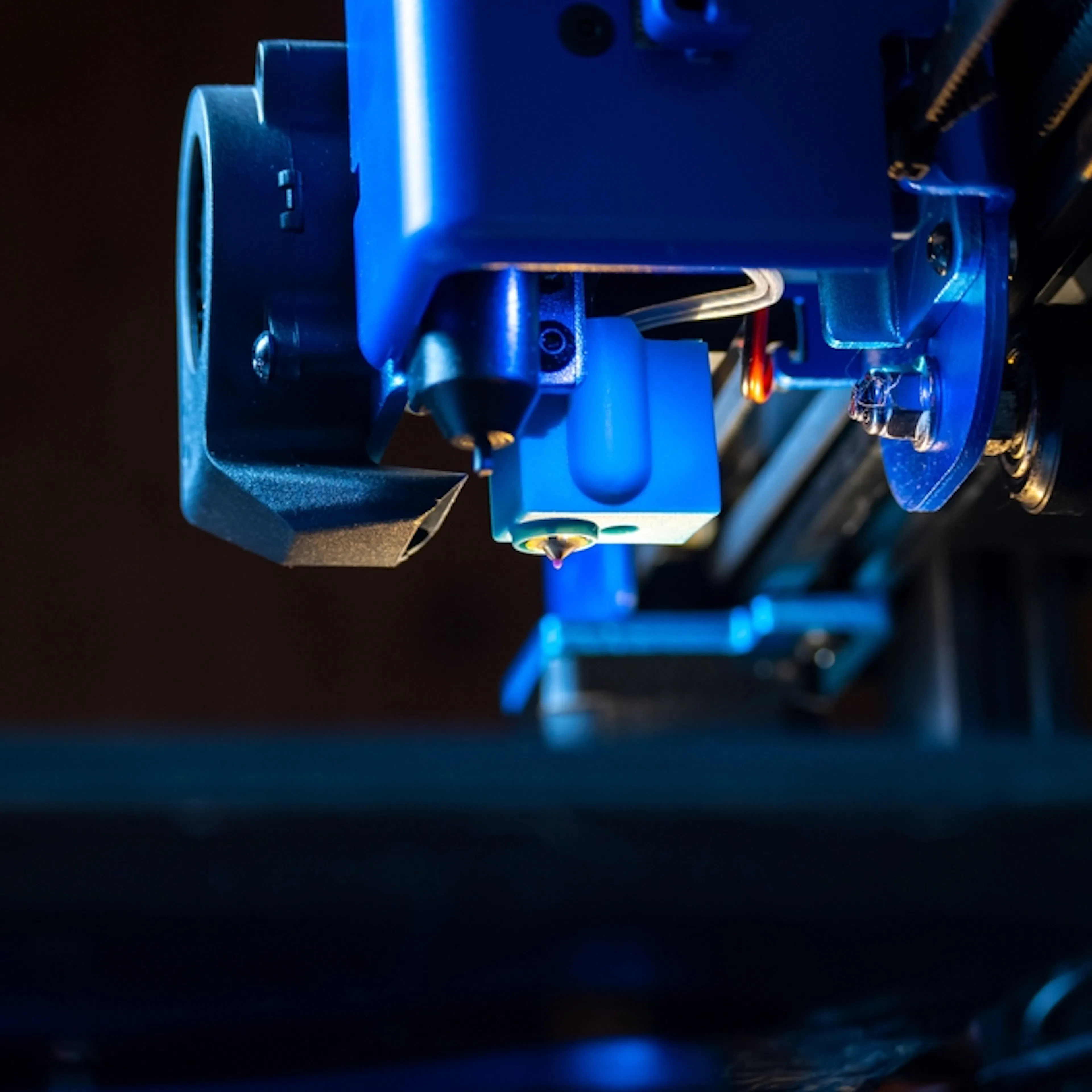

3D printer extruder. Image Credit: Shutterstock.com/G. Soler Tomasella
A direct extruder is a type of 3D printer extruder mechanism that directly feeds filament into the hot end assembly of an FDM® (fusion deposition modeling) or FFF (fused filament fabrication) machine, without the need for additional tubing or Bowden cables. It is commonly used in desktop FDM® direct-drive 3D printers. The direct extruder consists of: a stepper motor, a drive gear, and an idler arm mounted directly above the hot end. When the motor rotates, the drive gear grips the filament and pushes it downward into the hot end, at which it is melted and deposited onto the build platform layer by layer. Direct extruders are known for their precise filament control, which allows for better print quality, especially with flexible or soft materials. They are suitable for a wide range of filament materials, including: PLA, ABS, PETG, and TPU.
This article will discuss what a direct extruder is, including its use, how it works, and the materials suited for it.
What Is a Direct Extruder?
A direct extruder is a mechanical device that sits directly above the hot end of the printer and feeds filament to it, controlling the dispense rate and start/stop events by pushing the filament into the hot end or by withdrawing it to end the print operation.
