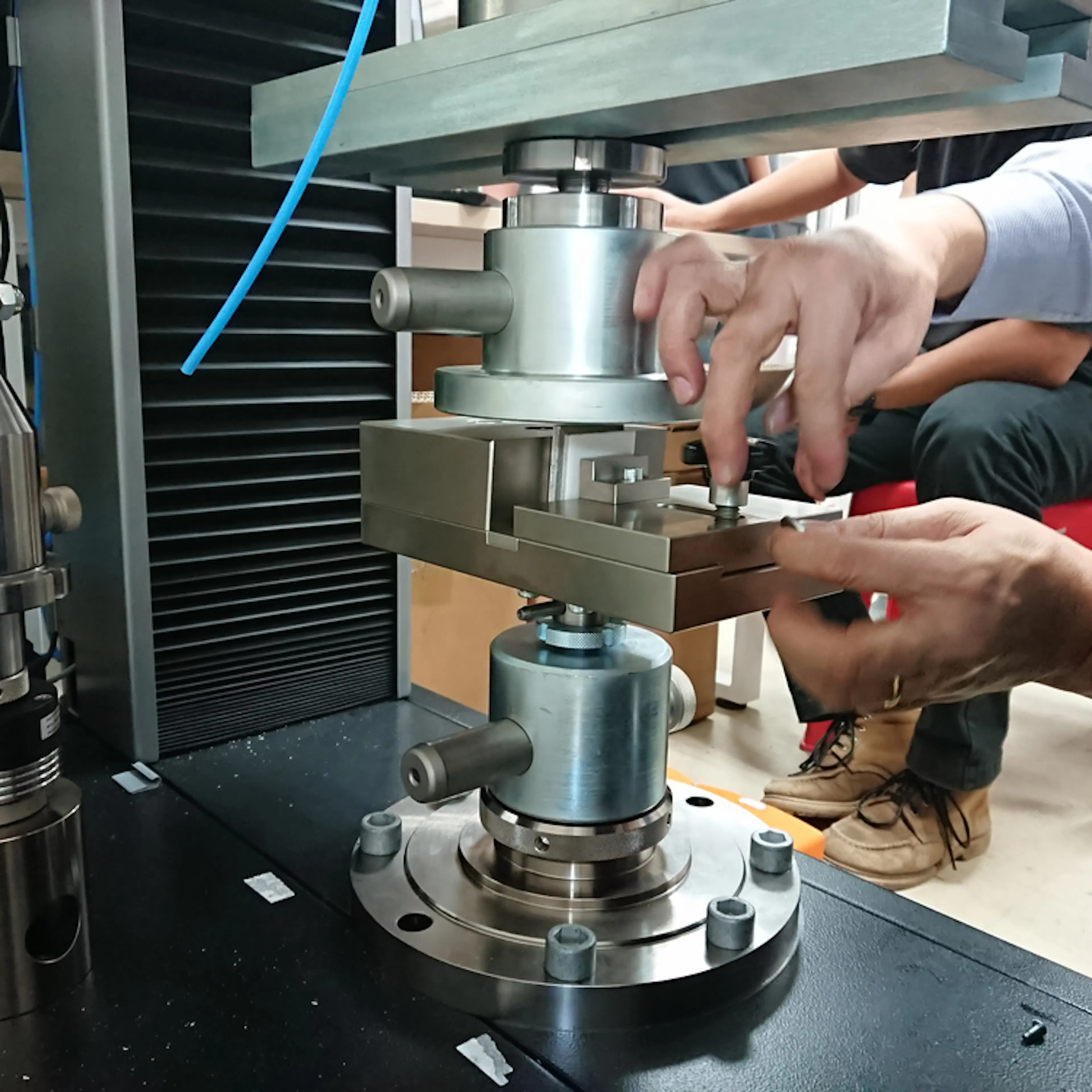

Flexural strength test in industrial construction. Image Credit: Shutterstock.com/Mrs_ya

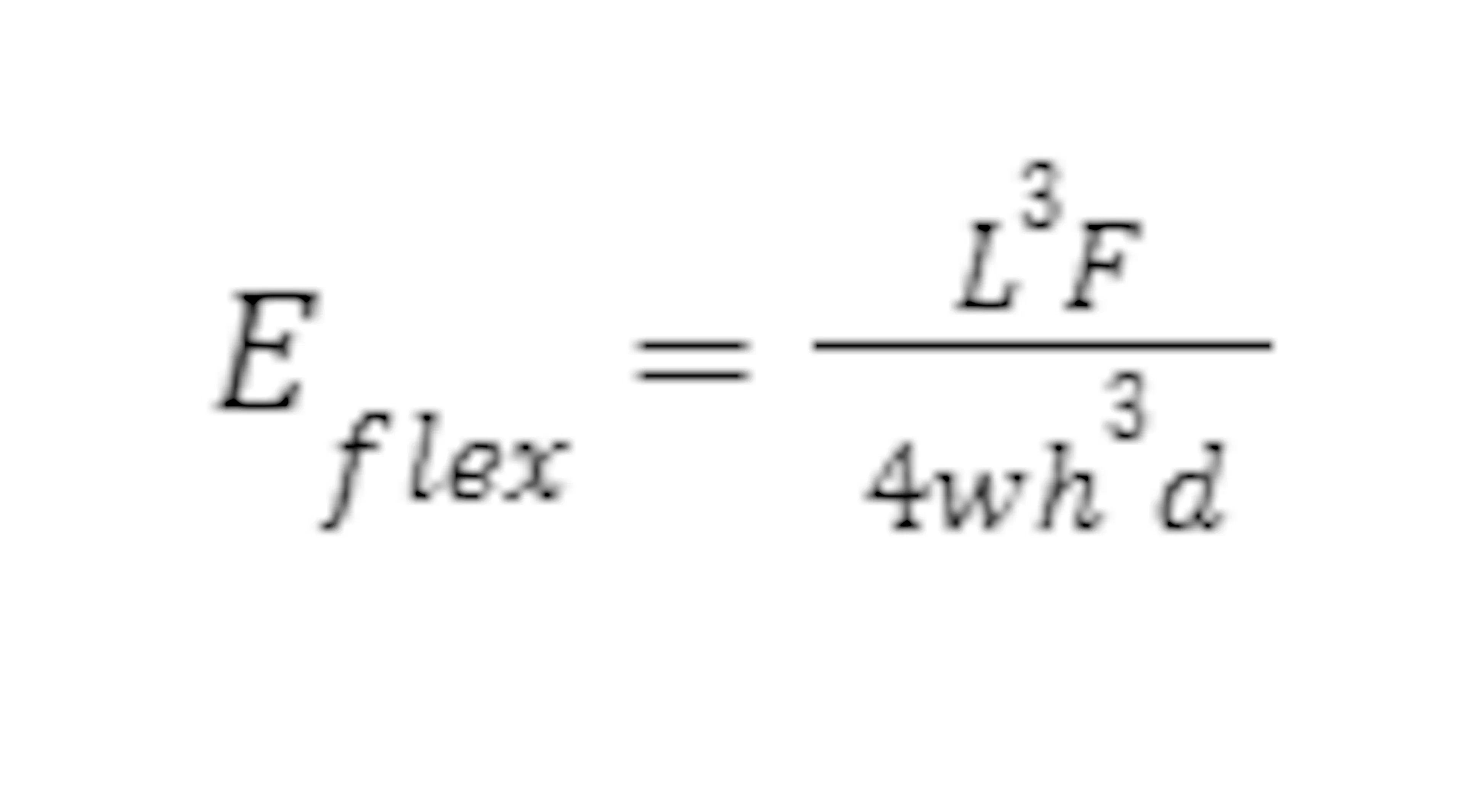

What Is the Formula for Flexural Modulus?
The flexural modulus (also called the modulus of elasticity in bending) quantifies a material's stiffness during bending. It is defined using the following formula derived from beam theory:
Flexural modulus formula.
Where:
  1. E  is the flexural modulus (in Pascals, Pa)
  2. L is the support span (length between the two supports)
  3. F is the applied force at the center of the specimen
  4. 𝑤 is the width of the specimen
  5. ℎ is the height (or thickness) of the specimen
  6. 𝑑 is the deflection at the midpoint due to the applied force
For isotropic materials, Eflex is equal to Young’s Modulus of the material due to the derivation of the elastic beam theory and the second moment of inertia for a rectangular beam.
