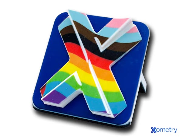

Xometry rainbow logo made with PolyJet color 3D printing
PolyJet is a method that allows you to print using various materials in one job, and parts will usually maintain their material properties after being post-processed. Materials of different properties can even be mixed simultaneously to simulate different material properties, such as mixing different ratios of rubber-like with rigid photopolymers to create pieces with different durometer ranges. The downsides to using this technique, though, are that the parts tend to be very fragile and fine features can easily be broken during or after post-processing. We do not recommend using PolyJet for end-use parts. The printing and post-processing can also take longer compared with MJP, which can affect overall cost. Learn more about PolyJet 3D printing in our dedicated article.
