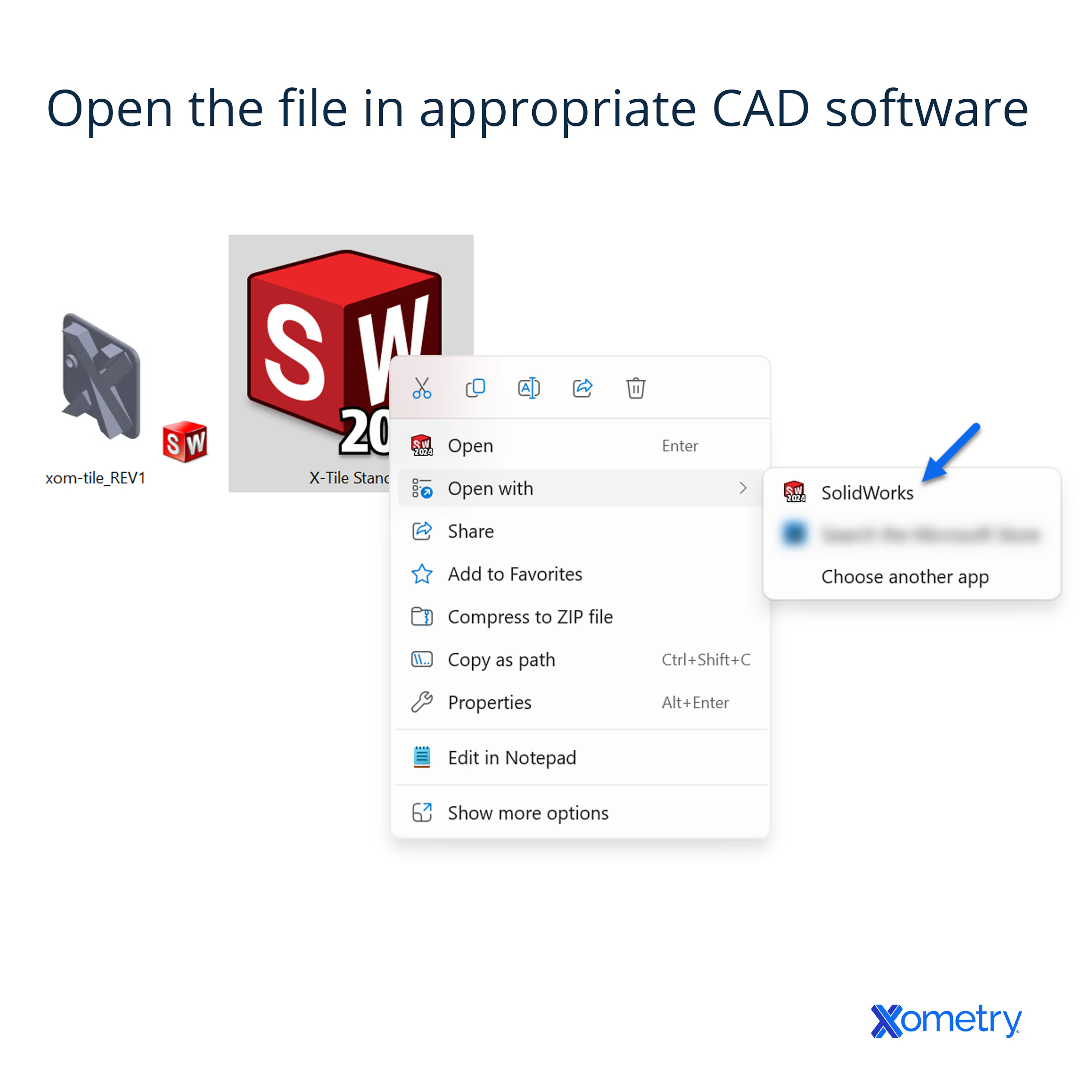

  1. Open the STEP file. A CAD program loads the STEP model into the workspace, forming the foundation for conversion. Clear display of surfaces and features ensures the model enters export without structural issues.

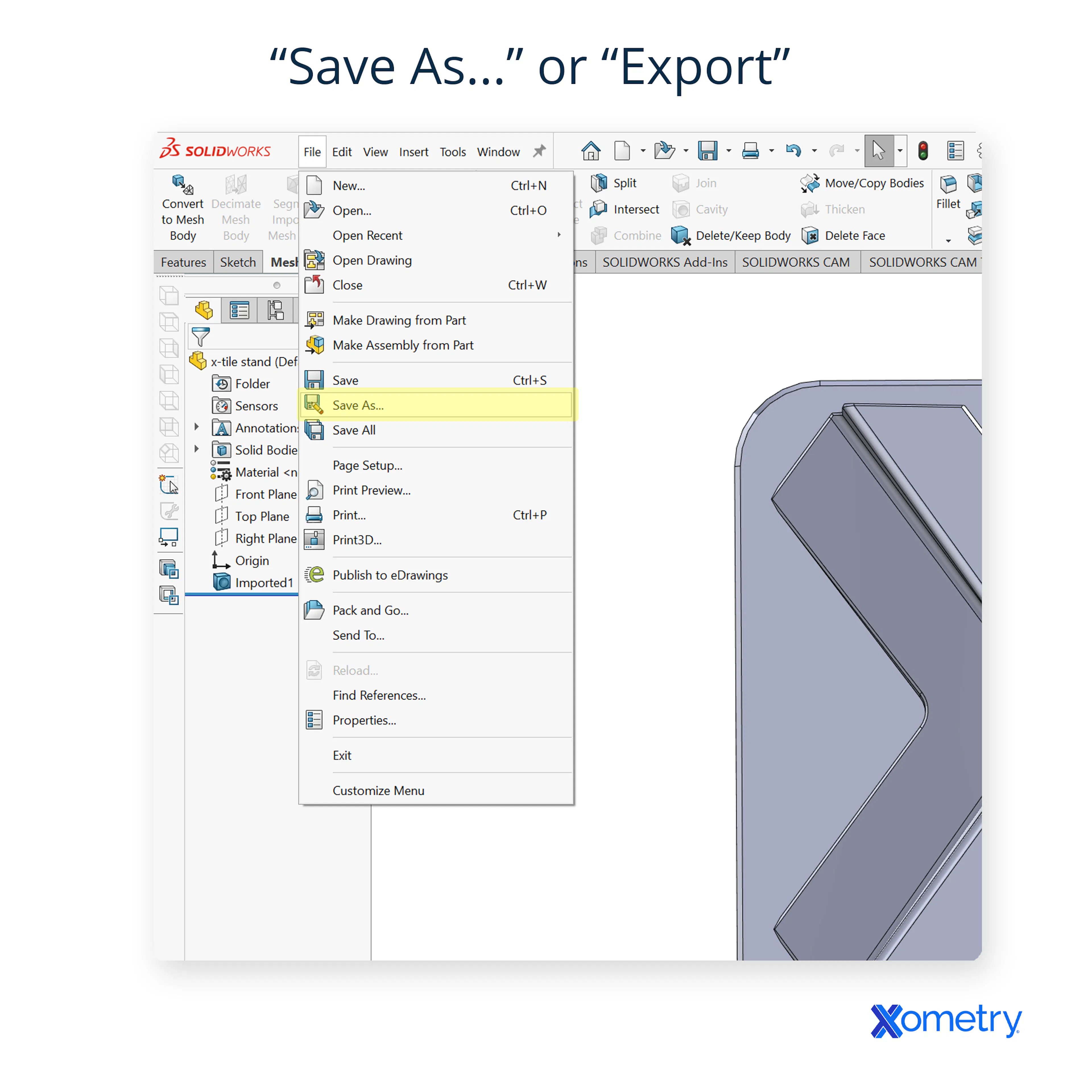

  2. Open the file export settings. An export menu offers format options and pathways for converting the model into a mesh file. A review confirms the export panel has the correct format tools.
  3. Select STL as the file format. An STL option in export assigns a mesh format for additive manufacturing, shifting the model from solid geometry to a triangulated surface.

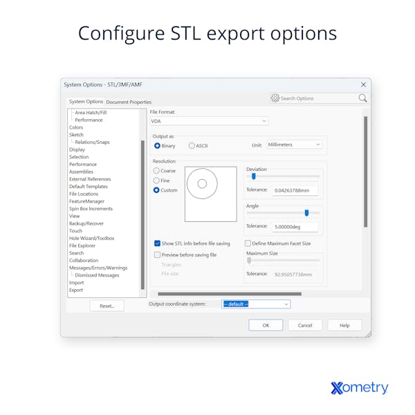

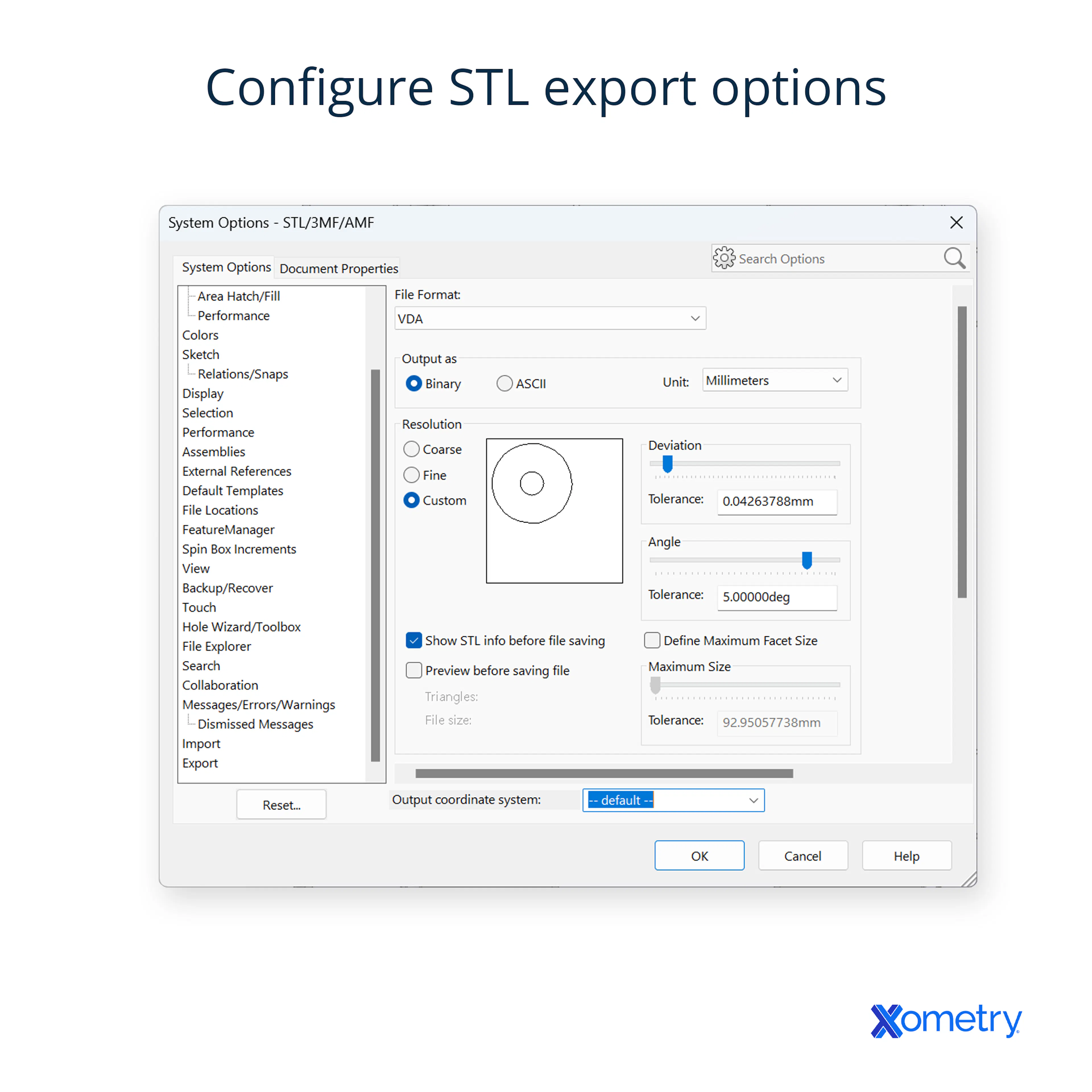

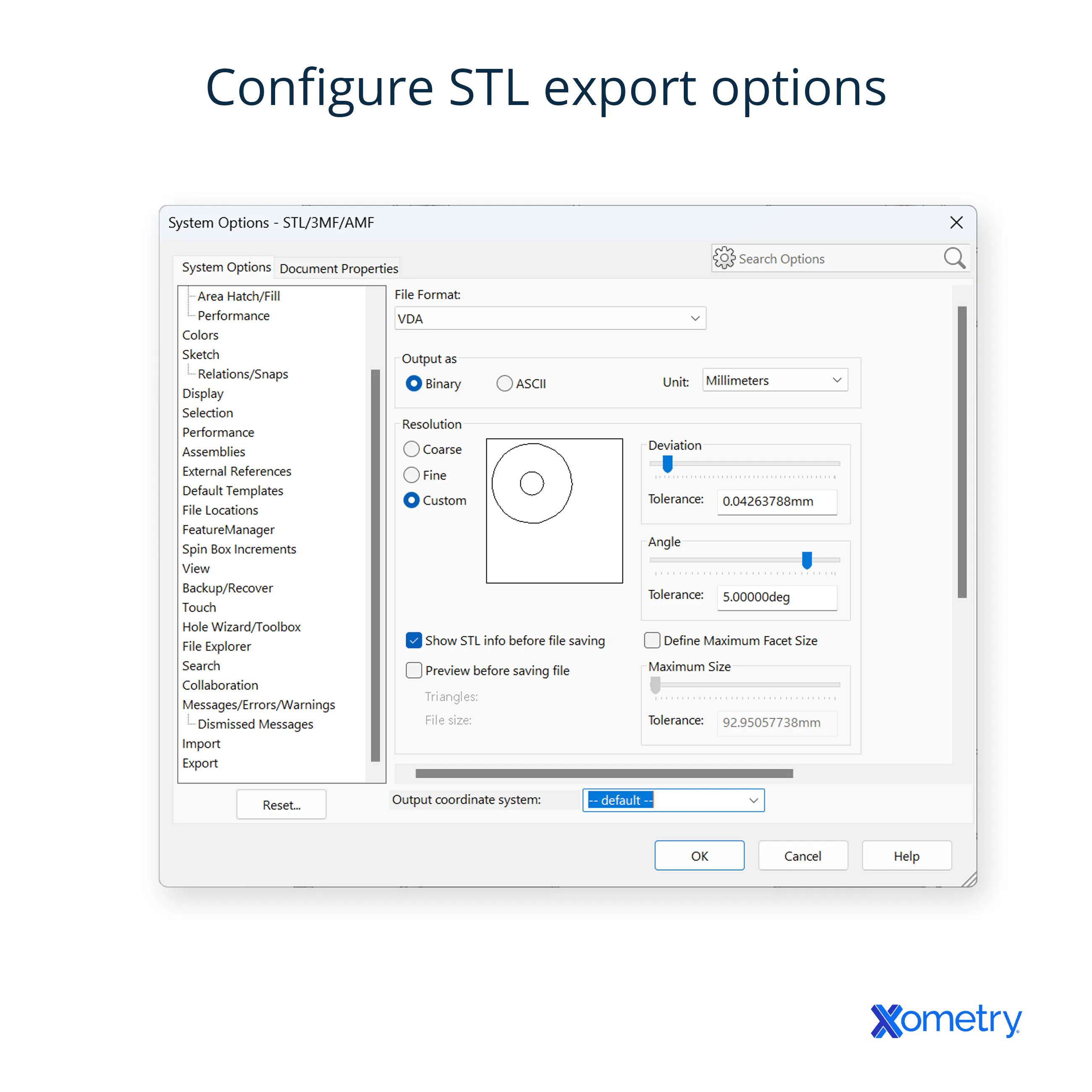

  4. Check for and configure STL export options. A settings panel offers controls for resolution, tolerance, and mesh density, affecting the final file's accuracy. A balanced setup preserves detail without increasing file size unnecessarily.

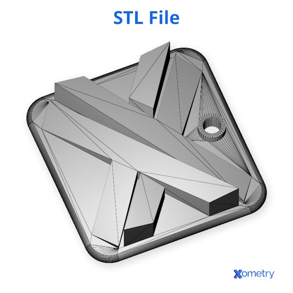

A Standard Triangle Language (STL) is a surface‑based 3D model format built from a collection of triangular facets. An STL file structure supports accurate shape interpretation by converting solid geometry into a mesh suited for additive manufacturing workflows. The format of the STL file is important in 3D printing because a mesh structure aligns with layer‑by‑layer production methods used in online manufacturing platforms. It supports quoting, print preparation, and automated checks by presenting a simplified model that aligns with production requirements.

  1. Open the STEP file in a CAD Program. The STEP model with full geometric detail allows accurate inspection before export. The structured environment supports engineering tasks that require dependable model handling.
  2. Export the model through the CAD Program menu. A tool that provides an export function that prepares the model for format conversion. Dimensional accuracy in STL depends on mesh resolution—higher-resolution exports more closely approximate the original STEP model.
  3. Select STL as the output format. A tool that offers STL as a standard export, ensuring models shift from solid geometry to a mesh format suitable for additive manufacturing printing.
  4. Adjust mesh settings before finalizing the export. Mesh‑control tools that refine resolution, surface quality, and file structure are included. The settings support engineering and 3D‑printing tasks that require precise output accuracy.

  • Creation of Rough or Uneven Mesh Surfaces: A conversion process generates triangles that form the outer shell of the model, and poor settings produce visible faceting. A rough mesh affects print quality because surface detail depends on consistent triangle distribution.
  • Large File Size from Dense Triangulation: A high‑resolution mesh increases the number of triangles, which expands storage requirements. A larger file slows processing during slicing and simulation tasks.
