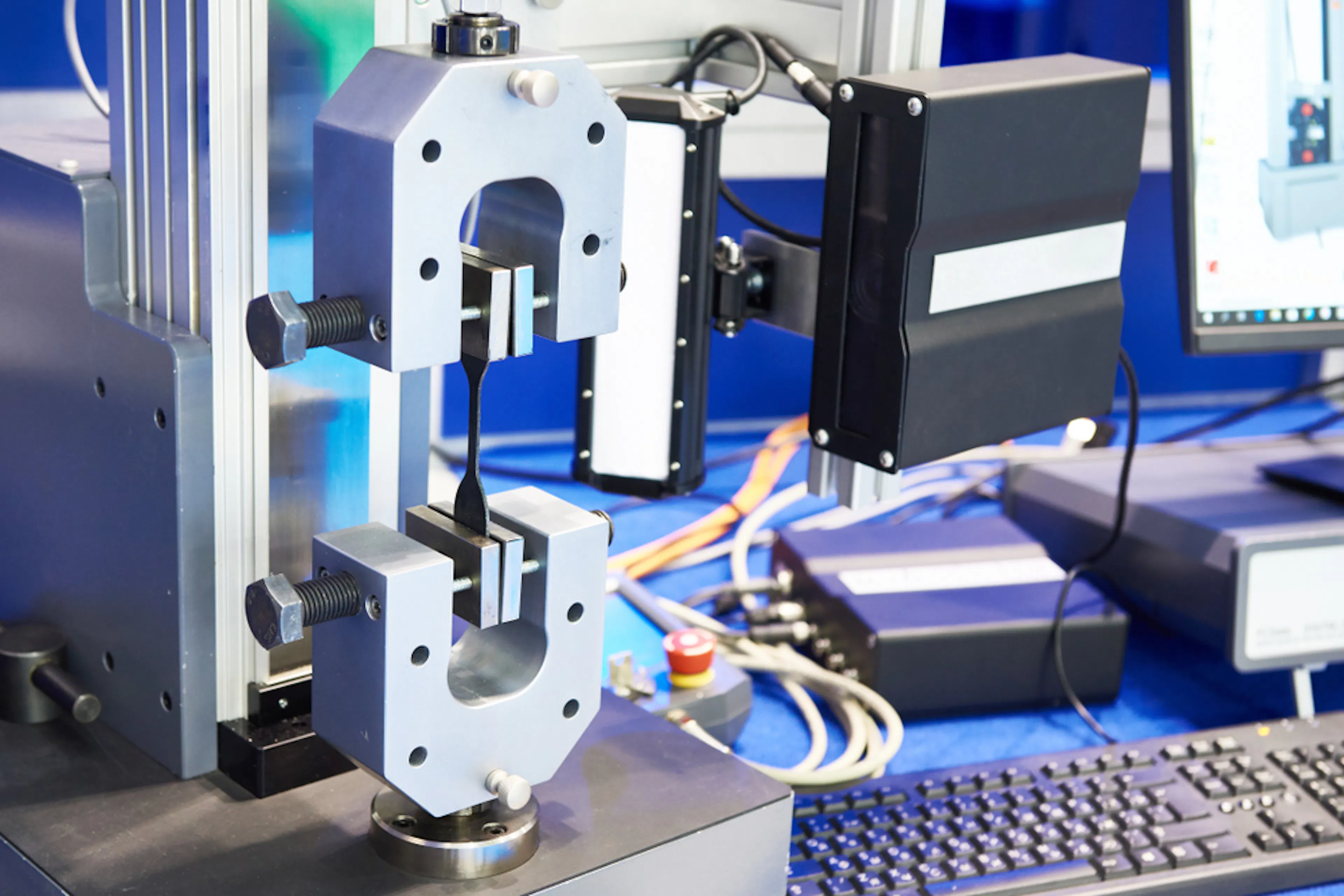

Testing metals for tensile. Image Credit: Shutterstock.com/Sergey Ryzhov

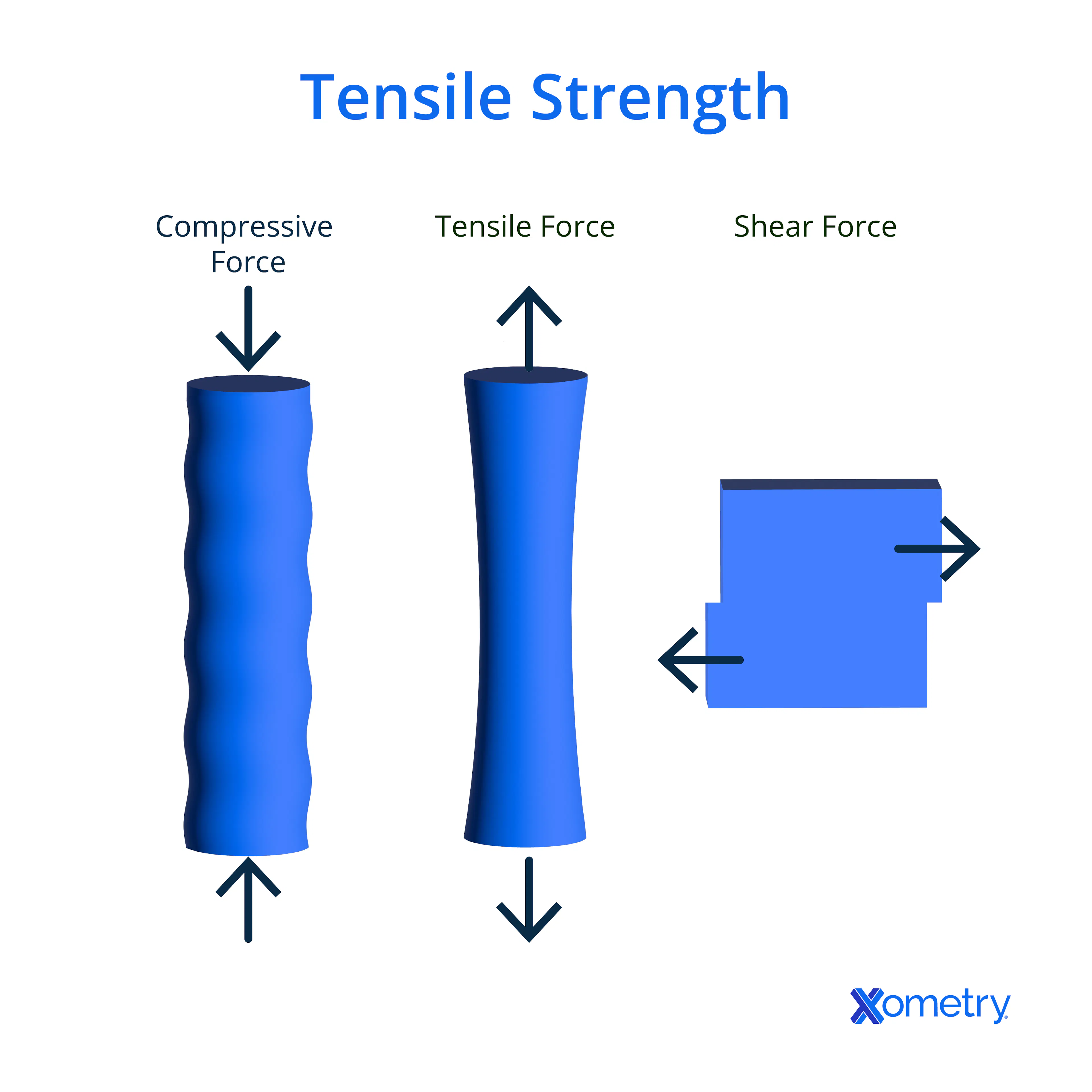

Tensile force vs. compressive and shear force

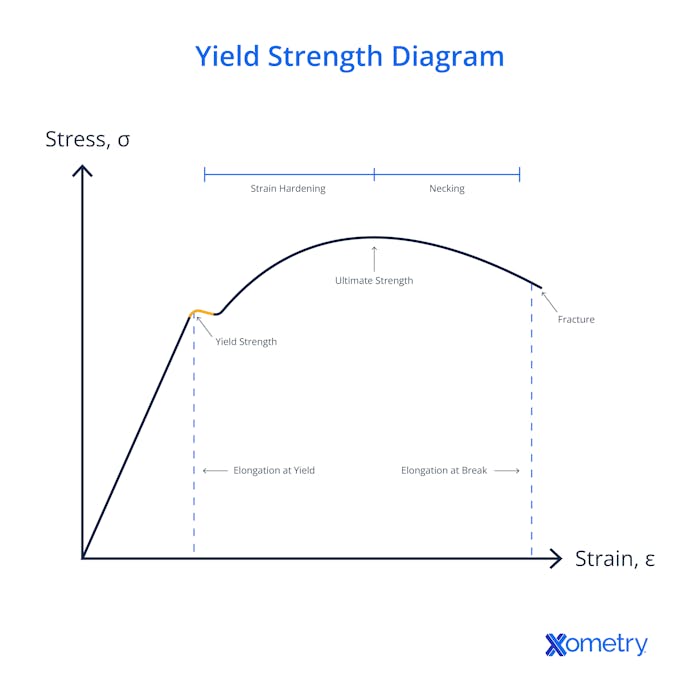

1. Yield Strength
Diagram of yield strength
As mentioned a little earlier, yield strength is the point at which permanent (or plastic) deformation begins in a material. For steel, this is once it’s been deformed past its proportional limit, usually seen as a straight line on a stress-strain curve. For material without a distinct yield point, like aluminum, yield strength is reported as the stress that coincides with 0.2% strain. In most cases, metal parts are designed to keep stresses in the service environment below the yield strength. In the case of very brittle materials, like ceramics, these will fail at very small deformations and do not yield at all. Other materials, like elastomers, can be stretched many times their original length without breaking and only show a small amount of permanent deformation once the load has been removed.
2. Breaking Strength
Also known as fracture strength, this refers to the point at which the material can no longer carry any more load and breaks. This can be seen as the end point of a stress-strain curve, i.e. point “ε” in the yield strength diagram above. The breaking point is also the point used for measuring total elongation.
3. Ultimate Strength
This is the maximum stress a material can handle before it ends up breaking under a tensile load. Some metals will experience strain hardening after passing their yield point, and they’ll continue to deform as the stress increases until they get to the material’s ultimate tensile strength. Not all materials, for instance plastics, will have a well-defined ultimate tensile strength.

What Device Is Used To Measure Tensile Strength?
A tensile tester is used to measure the tensile strength of a specimen. This machine grips the test piece at each end and applies a controlled amount of tensile force to it, at a constant rate.  The machine automatically logs data on the load applied and the displacement of the grips for further analysis.

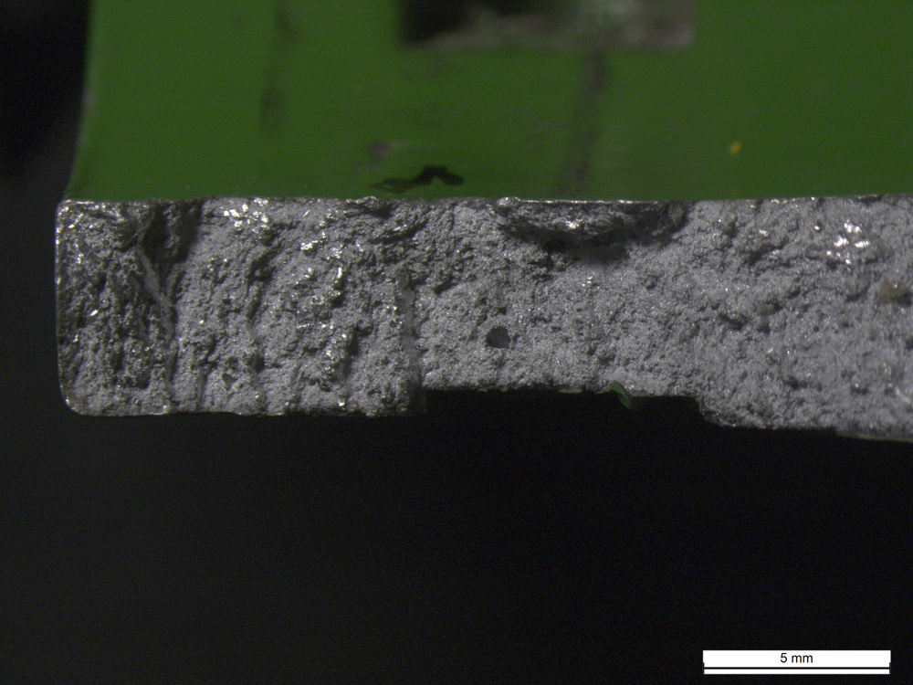

1. Brittle Failure
Brittle failure occurs mainly with hard materials, like cast iron. The material will not deform much before it suddenly fails.

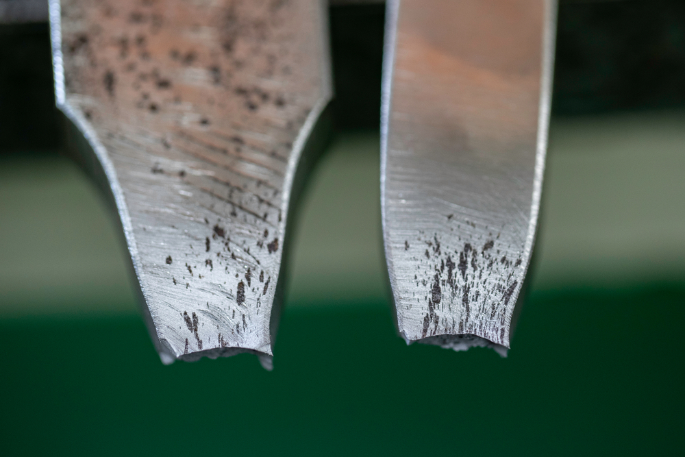

2. Ductile Failure
Ductile failure is the primary tensile failure mode for many structural steels and softer materials, like aluminum, and is gradual instead of instantaneous. After the material starts to yield, plastic deformation continues, then localizes, producing a "neck" that will be the site of the material’s final separation.
