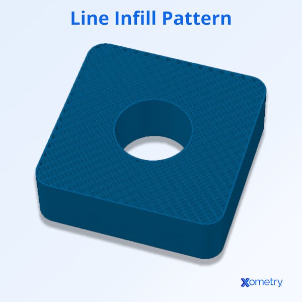

1. Line
Line infill in 3D printing is a simple and efficient pattern that uses straight lines running in a single direction. Line is used when speed and material efficiency take precedence over part strength. Low material usage makes line infill ideal for lightweight prints or models that don't require high structural integrity. The strength of a line infill is moderate, as the lines offer limited support in multiple directions. Line speed is one of its main advantages, as it prints faster compared to more complex patterns. Line infill is ideal for prototypes, visual models, or applications where speed and cost-effectiveness are more critical than maximum strength.
A part with a line infill pattern.

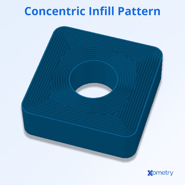

3. Concentric
Concentric infill features circular layers that follow the outer perimeter of the print, creating a uniform structure inside the part. The concentric pattern provides a smooth surface finish on the outer layers, improving the aesthetic quality of the print. The material offers moderate strength in the direction of the outer walls, making it suitable for parts that require a solid outer surface but do not need substantial internal support. The pattern is efficient in terms of material usage and printing speed, but its strength is lower than other patterns (Gyroid or Triangular). Concentric infill is ideal for applications that prioritize surface finish and moderate structural support (decorative objects, thin-walled enclosures, and functional prototypes), where external appearance and light support are essential factors.
A part with a concentric infill pattern.

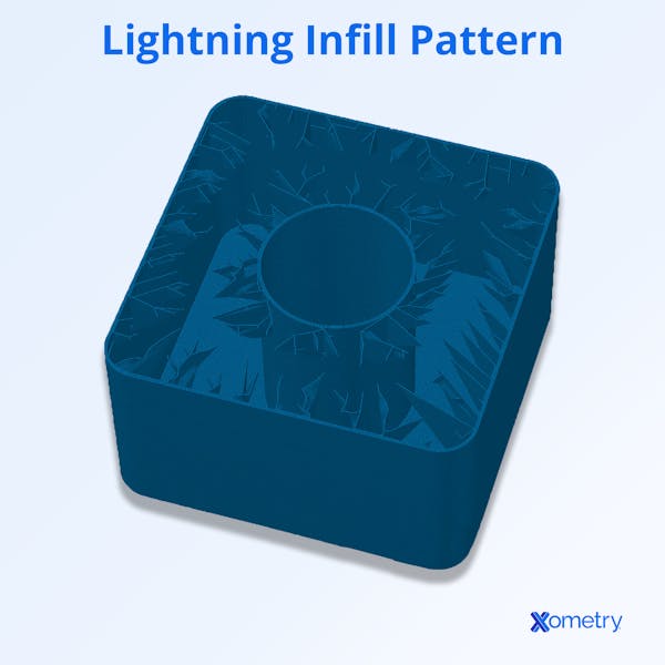

4. Lightning
Lightning infill features a pattern that mimics the jagged path of a lightning bolt, creating a series of zigzag lines inside the printed part. The pattern offers a significant speed advantage due to its simplicity and minimal material usage, making it ideal for quick prints or projects with time constraints. The lightning infill pattern does not provide as much strength as complex infill types (Gyroid or Triangular), since it lacks multidirectional support despite its speed and efficiency. Lightning infill is best suited for lightweight parts or prototypes where rapid prototyping and cost efficiency are prioritized over structural strength. The pattern is suitable for application (concept models, non-load-bearing components, or decorative items) where appearance and speed are more critical than heavy-duty functionality. Lightning infill is not recommended for parts that require high strength or structural integrity under stress.
A part with a lightning infill pattern.

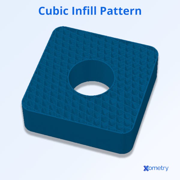

7. Cubic
Cubic infill uses a three-dimensional lattice of repeating cubes that provides more uniform strength across multiple load directions. Cubic infill delivers uniform resistance to compression, bending, and torsion due to the symmetrical geometry of the cubic cells. The typical density for Cubic infill ranges from low to medium percentages, making it suitable for functional parts that require strength without excessive weight. The Cubic infill's suitability for functional parts remains high, as it effectively supports mechanical loads in brackets, mounts, enclosures, and structural prototypes, where consistent internal support is essential to long-term performance.
A part with a cubic infill pattern.

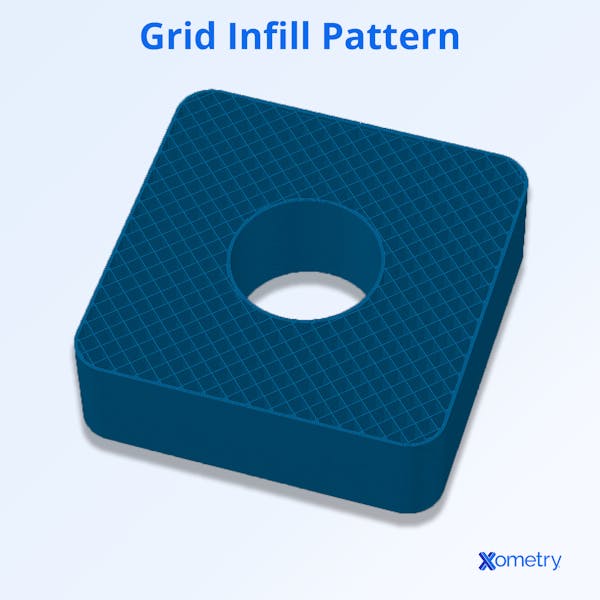

8. Grid
Grid infill features a crisscross pattern of intersecting lines that form a regular grid inside the print. The pattern provides moderate structural strength, balancing material usage and part durability. Grid infill is effective in supporting parts that require medium strength, offering a solid internal structure without excessive weight or material usage. The grid structure improves part stability while ensuring relatively fast print times due to its efficient pathing. Grid infill is well-suited for applications (casings, covers, and components) that do not require extreme strength but need reliable internal support. The process is ideal for producing functional parts where a balance between speed, strength, and material efficiency is essential.
A part with a grid infill pattern.

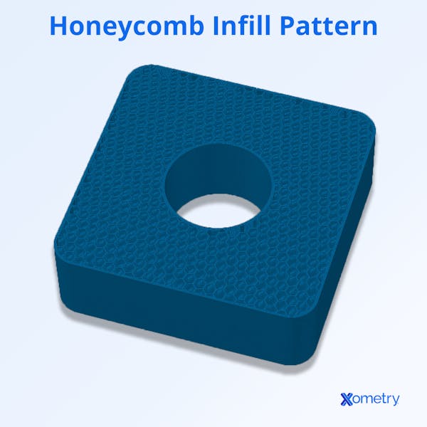

9. Honeycomb
Honeycomb infill features a pattern of hexagonal cells that create a lightweight yet strong internal structure. The design optimizes the strength-to-weight ratio, providing solid support while minimizing material usage. The honeycomb pattern is effective for parts that need to maintain structural integrity without adding unnecessary weight, making it ideal for applications where strength and lightness are essential. Aerospace, automotive, and product packaging industries use lightweight, durable components. Honeycomb infill is most beneficial for functional parts (brackets, supports, and enclosures), where a strong and efficient internal structure is required.
A part with a honeycomb infill pattern.
