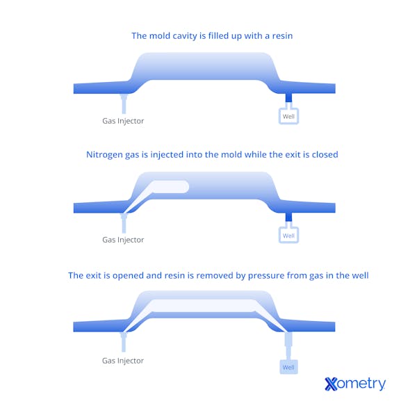

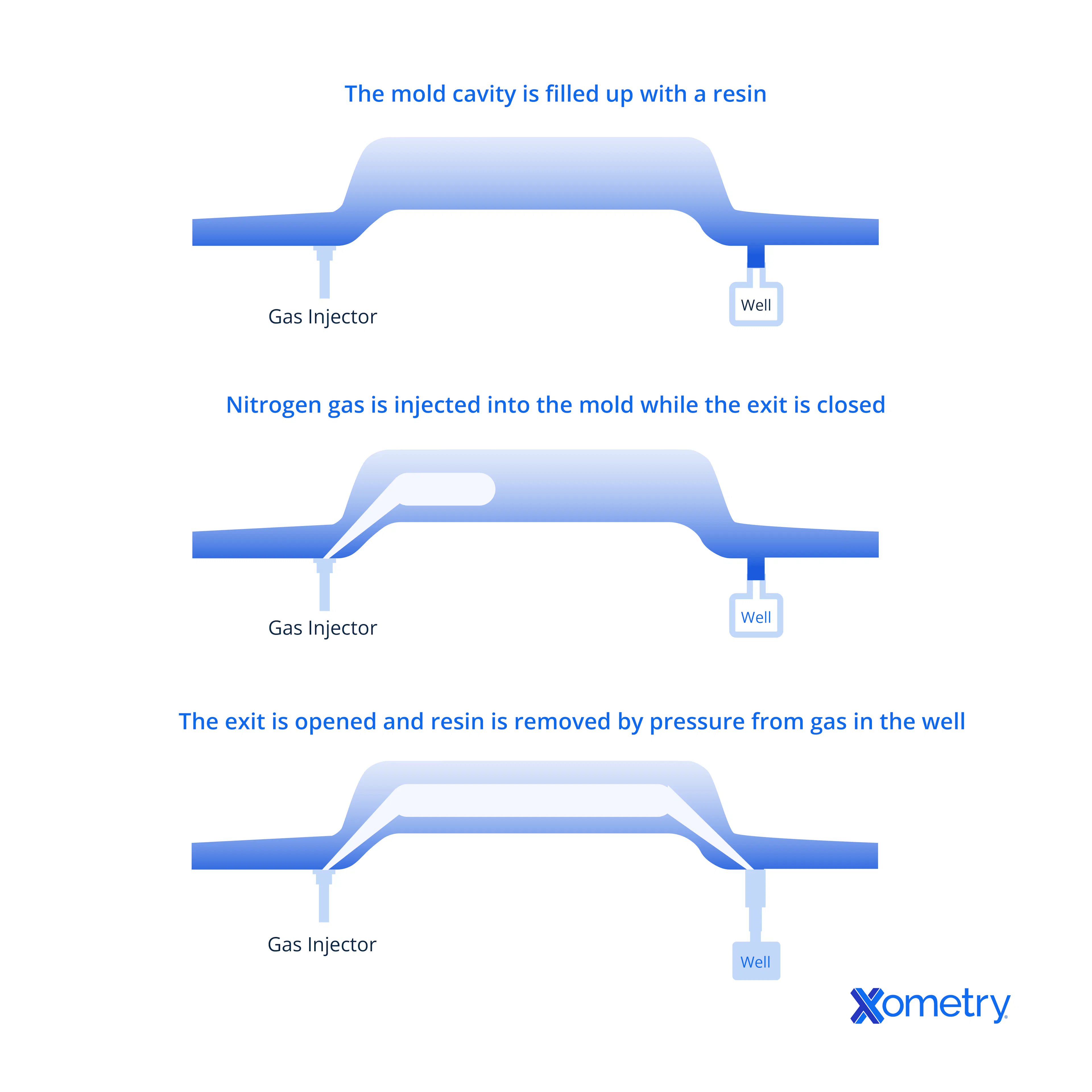

How does Gas-Assisted Injection Molding Work?
Gas-assisted injection molding works by channeling pressurized assist gas (typically nitrogen) into molten polymer after the mold cavity receives a partial fill. The process begins with the injection of plastic melt into the cavity, followed by the introduction of nitrogen gas through designated channels. Nitrogen gas is then injected through specific channels within the mold, displacing part of the molten plastic. The gas pressure forces the material outward, ensuring it fills the mold and creates hollow sections within the part.
The pressure-flow interaction helps reduce internal stress, minimizes the formation of sink marks, and prevents warping by promoting uniform wall thickness and consistent surface contact. The process significantly reduces material usage and lowers the overall weight of the molded part by creating hollow sections.
