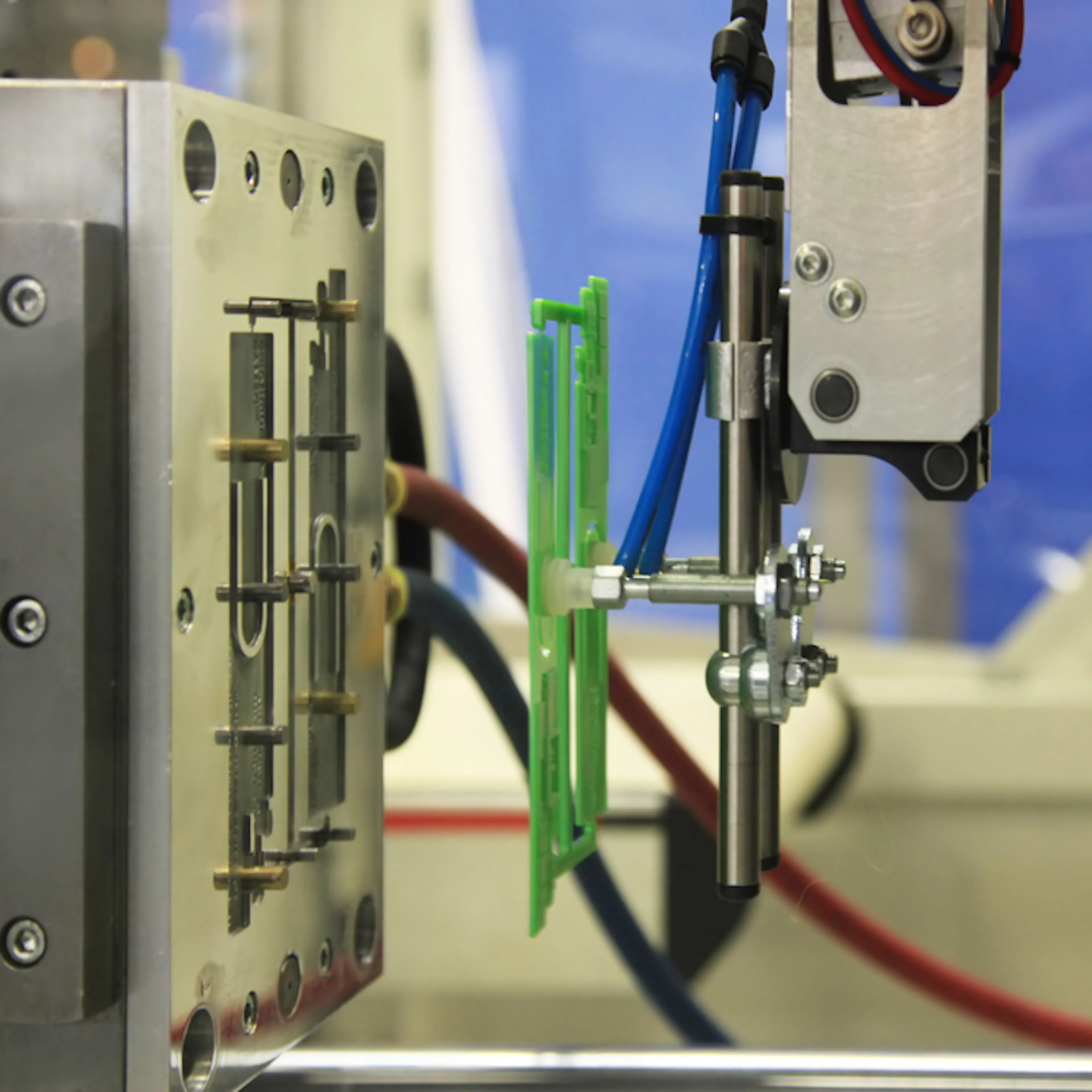

How Does the Overmolding Process Work?
A generic summary of the overmolding process typically involves these stages:
  1. A mold is first required, to retain the substrate and provide the forming cavity for the injected overmold material.
  2. Prepare the rigid substrate by cleaning, adding an adhesion modifier, or etching, to ensure good adhesion with the overmolded material.
  3. Place the rigid substrate into the desired position within the mold. Then introduce the overmold material into the unfilled parts of the cavity. This is achieved through injection molding, insert molding, transfer molding, casting, or compression molding, as appropriate.
  4. Allow the mold to cool—for the overmold material to solidify and bond with the substrate. In the case of thermoset materials, the mold is heated to induce cure and then cooled.
  5. Remove the overmolded part from the mold once it cools and solidifies. Trim the excess material and perform any necessary finishing operations, such as surface texturing or polishing.
