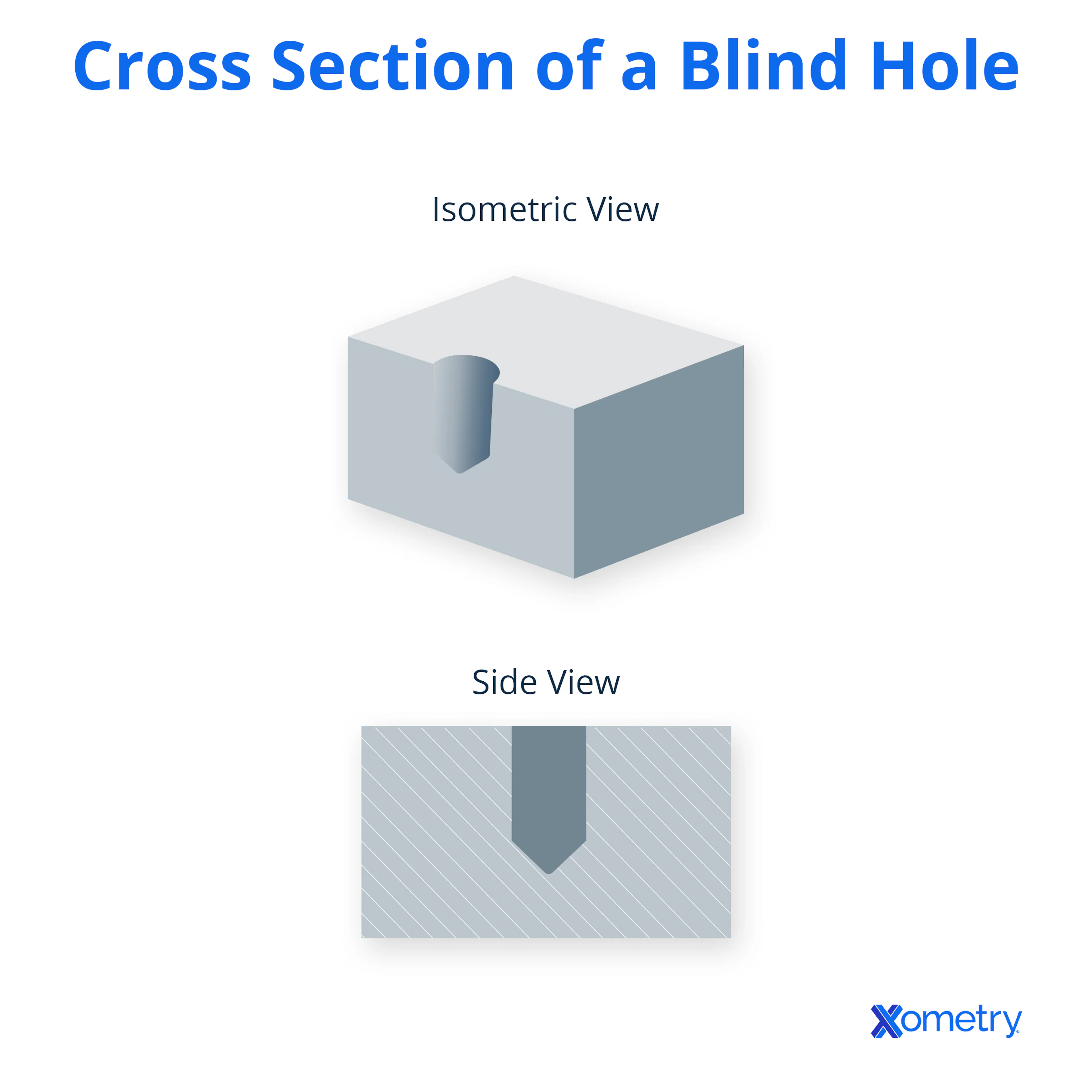

views of blind hole
Isometric and side views of a blind hole

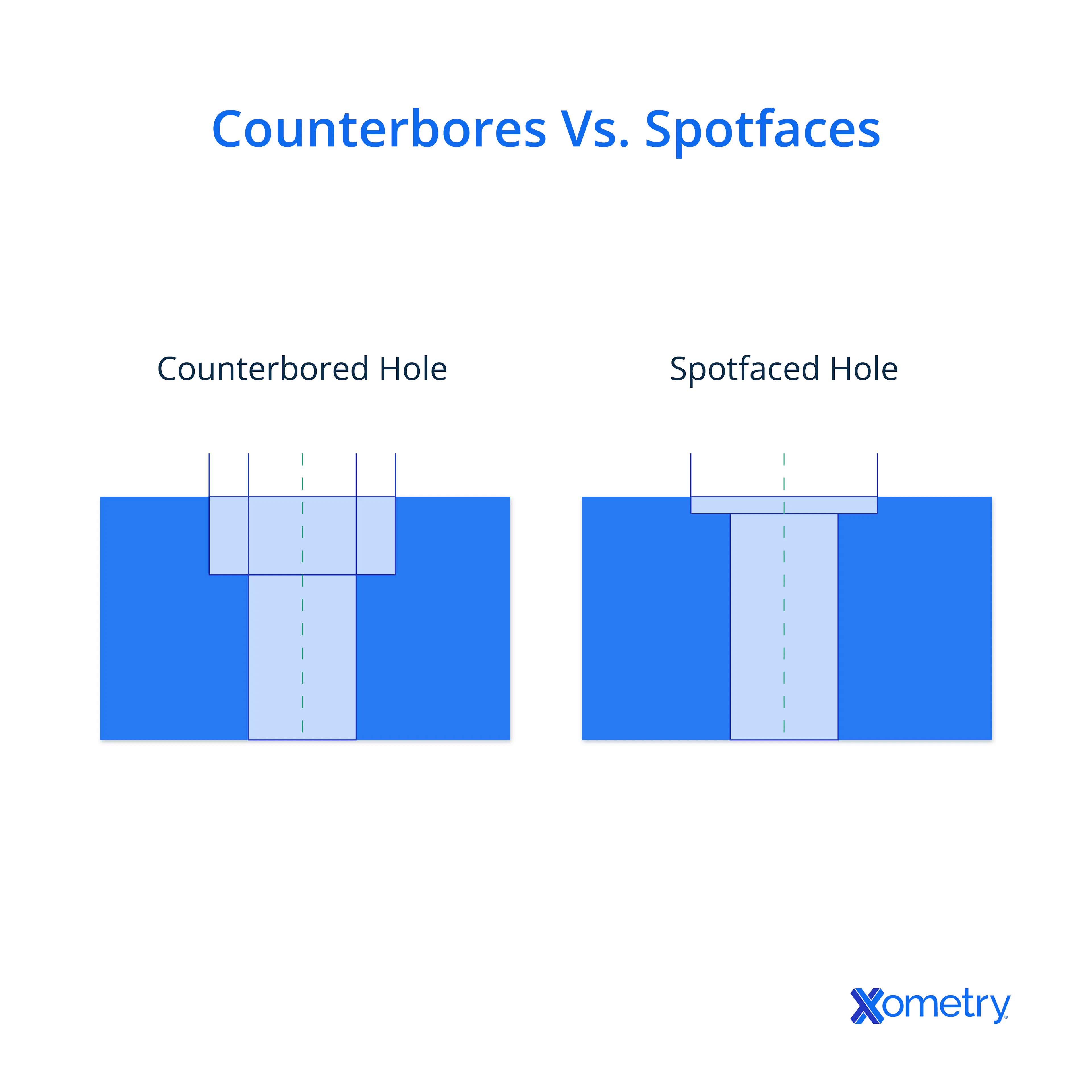

Spotface vs. Counterbore Holes
