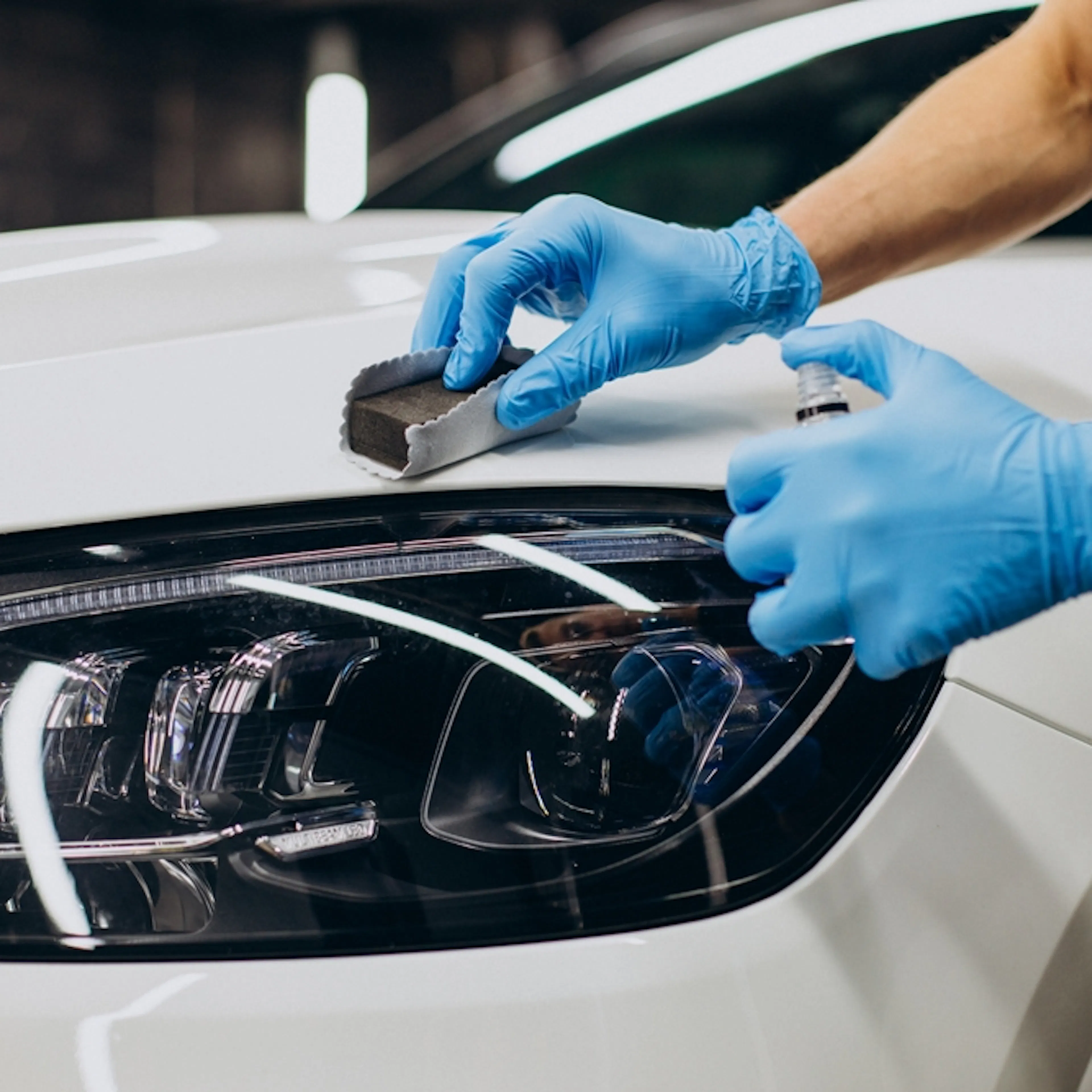

Automotive ceramic coating. Image Credit: Shutterstock.com/PH888

  1. Ceramic Coating a Car: Liquid ceramic coatings for cars are applied to a thoroughly cleaned and detailed painted surface using straight-line motions. After application, the excess coating is wiped off gently, and the car must cure for at least two days before exposure to water.
